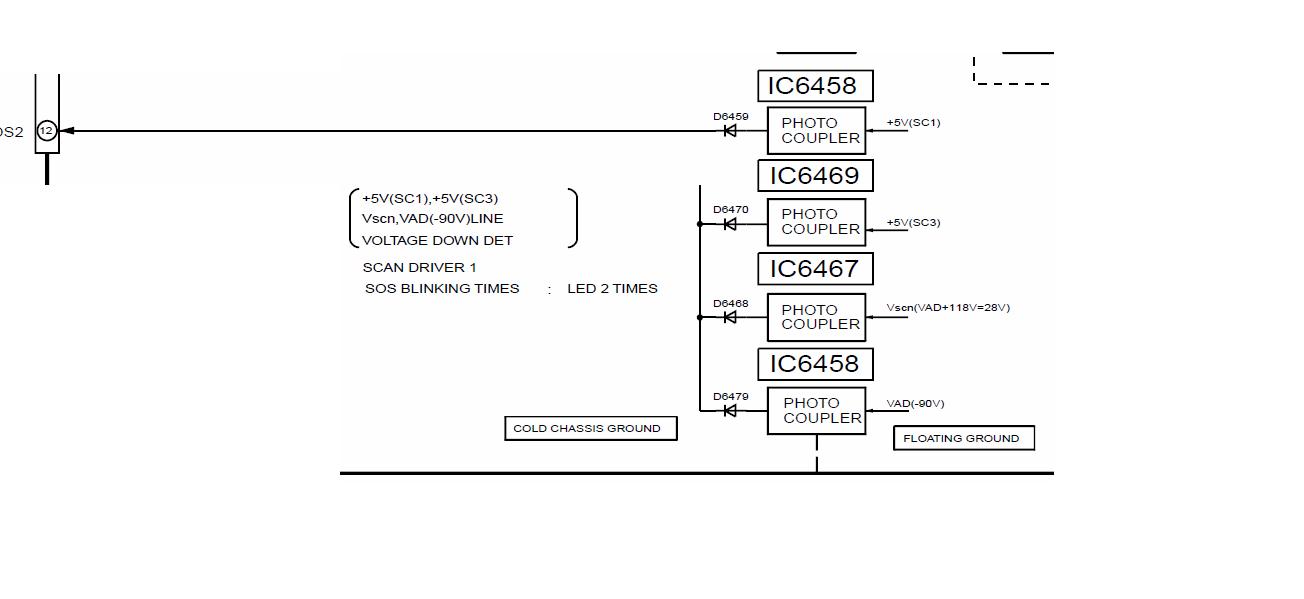

Panasonic TH-42PE30 fault no picture fault code 2 blinks

      have voltages been checked on SC. used paint, part of a line is missing, sure you can figure it out. block diagram, pin 12 SC20 is the 2 blink output

        Re: Panasonic TH-42PE30 fault no picture fault code 2 blinks
        Thanks for the reply, this fault started has a 2 blink, then changed to 12 blinks which is what it is now and have checked lots of voltages but have not found any problem and at one time was coming on for some time but no sound and could only get PC video. So if you have any info on 12 blinks, help would be appreciated. Have checked the speakers and voltages.
            Tom66 if you see info on 20, says that if I remove plug D3 the power stays on but have changed both board at each end of the connectors, still get the same problem. You still think it is the audio ??
