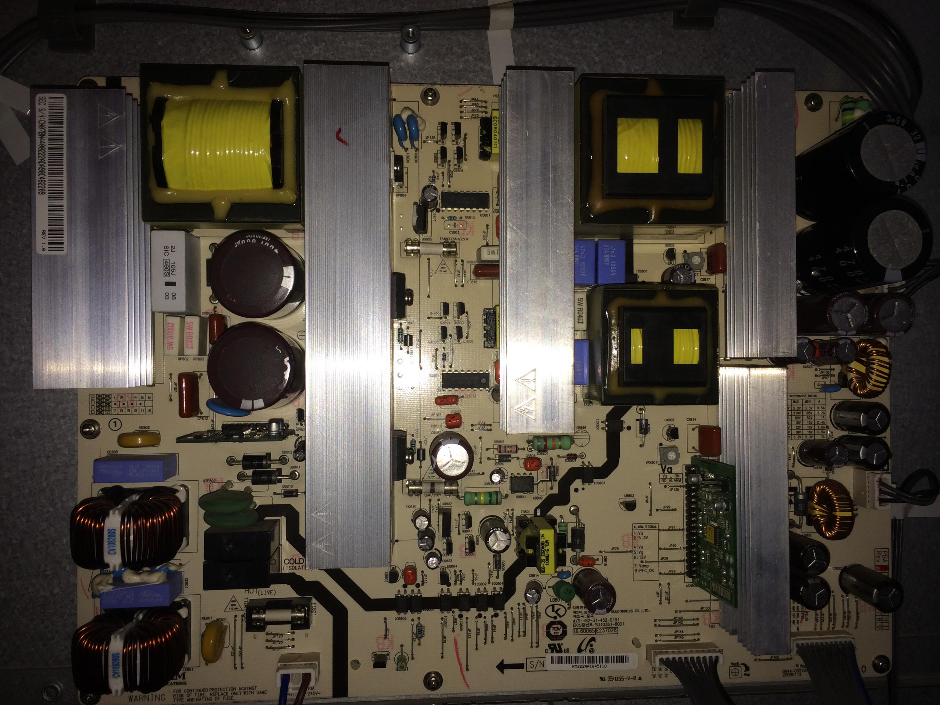

      I would check the poly coupling cap on the primary for the VS transformer... can you post a picture of your PSU?

        Here is my psu, would the caps you are talking about be the blue ones below the larger transformer?
          Re: Samsung plasma PS50A550S1F - VS voltage droop
          Yep - the two right next to each other. I've replaced a few before. None for this model, but have seen them cause similar issues in other models before.

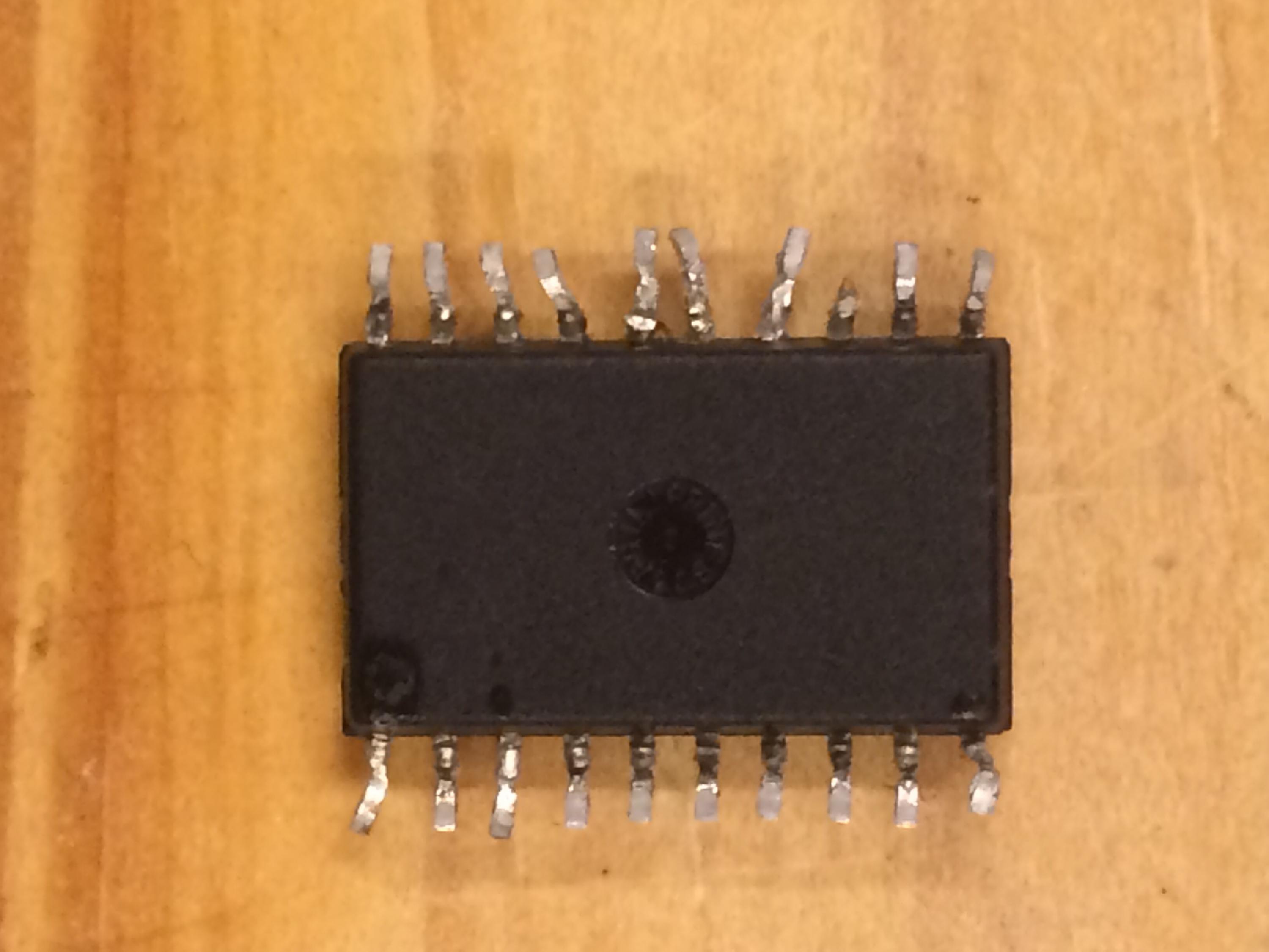

                        Update: i have checked the voltage going to the power factor controller board, all good, but not getting any output to the totem pole transistors that drive the mosfets.
                        I pulled the controller IC off and you can see in the picture that there looks like a burn mark on the underside near pin 20 (bottom left), which is the gate drive output according to the datasheet.
                        I have ordered a new IC so it will be a couple of weeks before i can see if it works. In the meantime, i have checked all the other components on that board and they are all good.
                        • Dans2530
                          • Aug 2014
                          • 15
                          Update:
                          I have received the new power factor IC, soldered it in, and.....nothing. Same as before. Voltage sits around 340v on the main filter cap.
                          What an anti-climax!
                          The power factor controller is getting power, just no output to the totem pole transistors. If anyone has a schematic for a bn-44 00222a board or can suggest a working theory on how to fix this i will be eternally grateful. I will try anything at this point!
