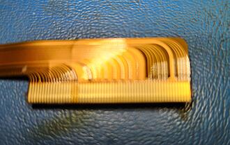

    Hi I just picked up a Samsung QN50Q6DTA. The issues was a 2 red flashes on the power button as the TV tried to turn on. Power supply OK. Backlight LED OK. If I remove the data cable from panel , sound is ON. I was able to identify the issue within one side of the panel. Used the tape fix and I placed the tape on 4 pins on one side of the flat cable. The TV ran great for 4 days and then the same problem appeared again...2 red flashes on the power button LED. Took the back panel off again and this time mode the tape on a different location and now the TV is running again. Am I missing something? Is this a normal behavior for a panel that is normally dying..or is the issue somewhere else?

      Where are you from? A possible difference between before and after is the change of wheather / temperature, if you blocked now more faulty signals possibly the fake repair would last more, but do not expect much more, terminated one side, can be the turn of the other side

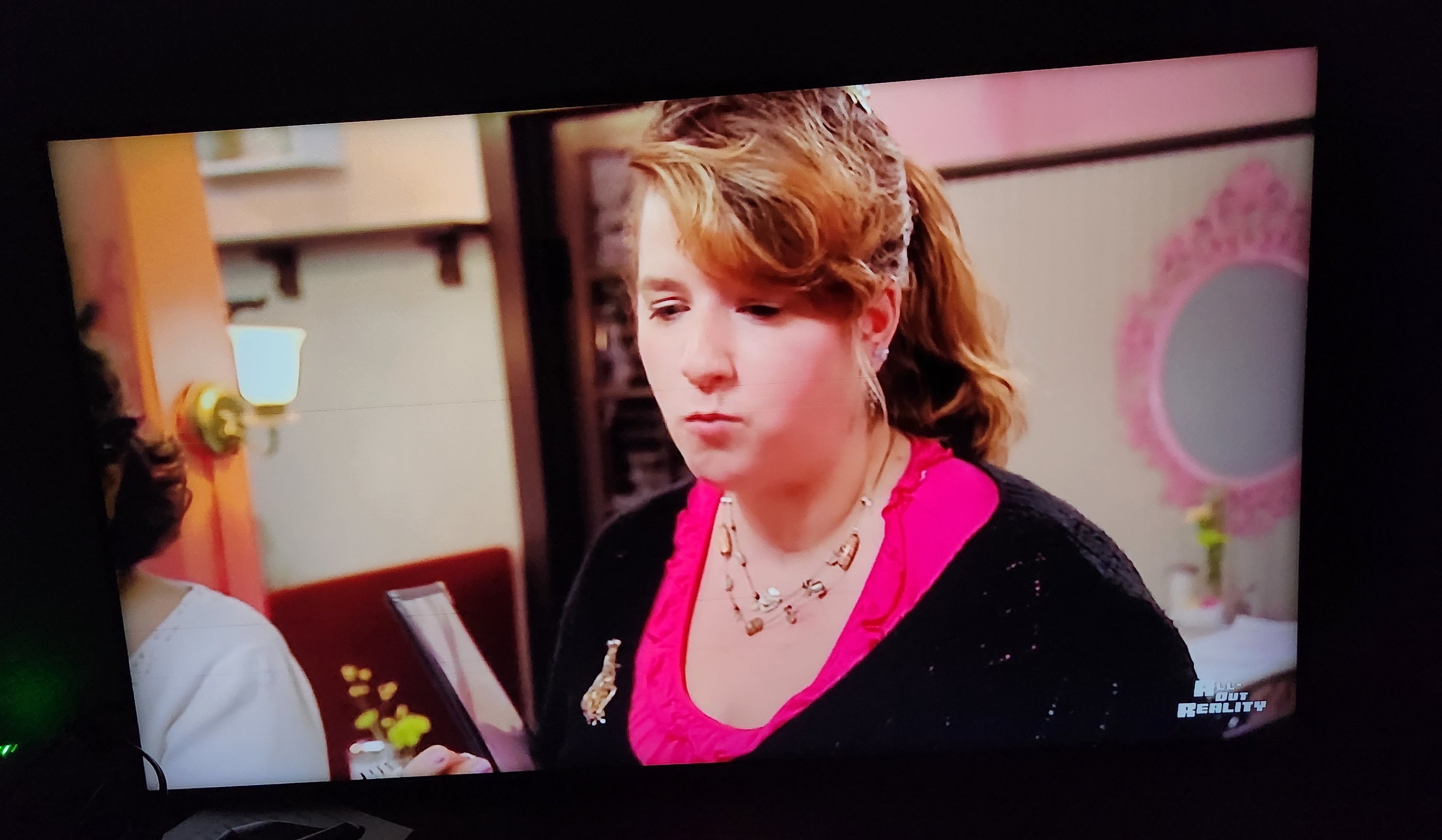

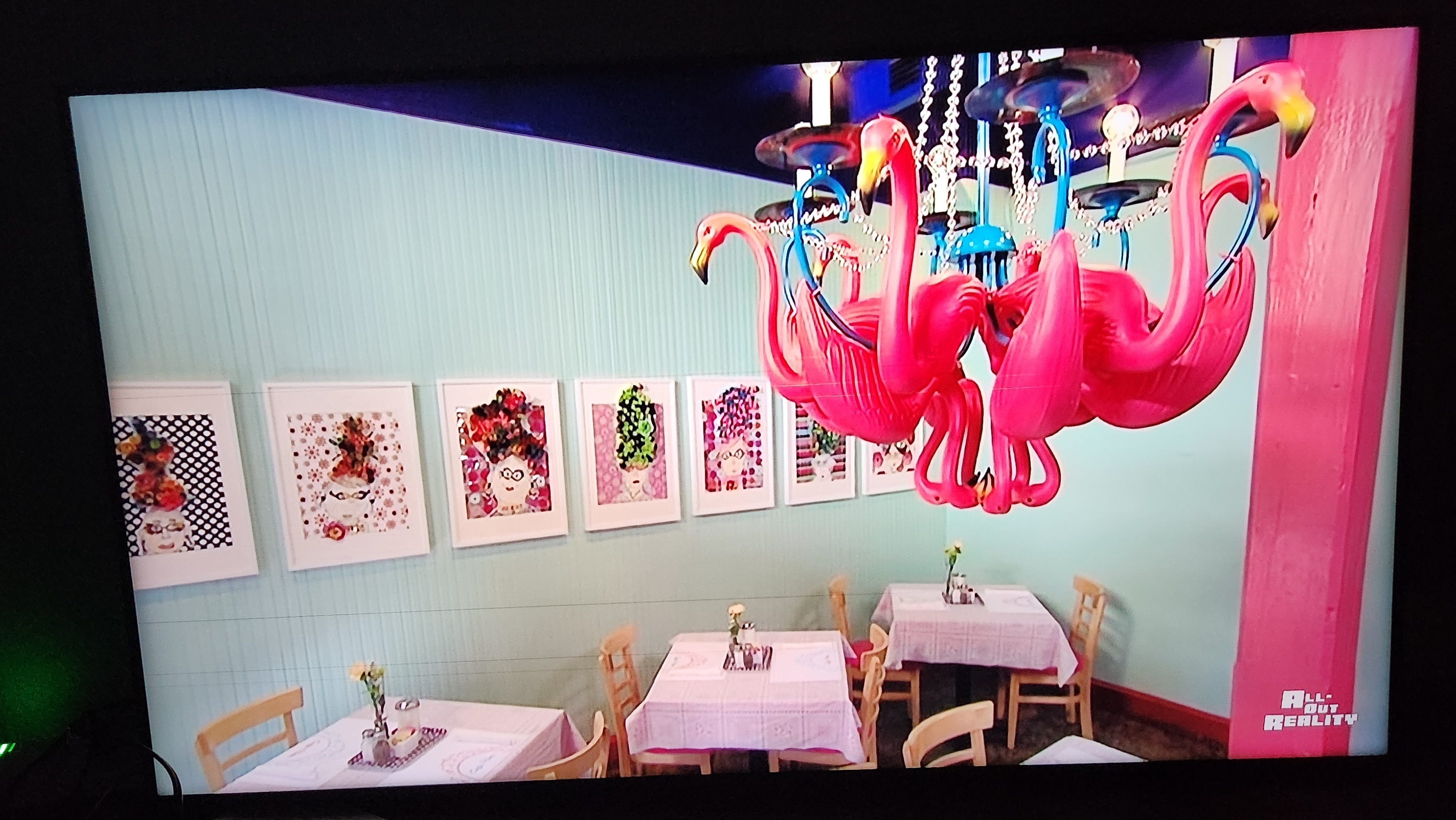

          Yes the picture quality is not perfect but unnoticeable when viewing a TV show. More noticeable when using the TV as a PC monitor. Click image for larger version
ID:	3679553 Click image for larger version
          Unfortunately the Main to T-con is one cable only. The T-con is embedded into the main. I should have taken pictures before putting the cover back. Also I could not find a match for my TV type. The TV has been running all day with no failure. We will see what happens. Click image for larger version

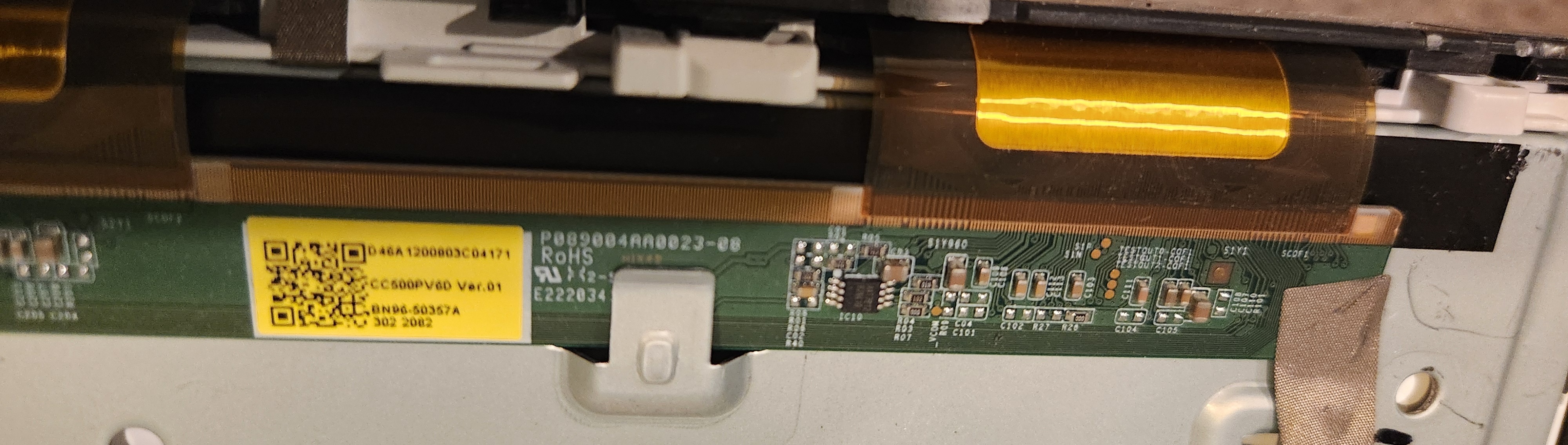

                      Hi Lotas
                      I removed the TV back cover and I did not see any protective diodes on either side of the buffer strips. The image is from the end of the buffer strip where the tape solution was applied.

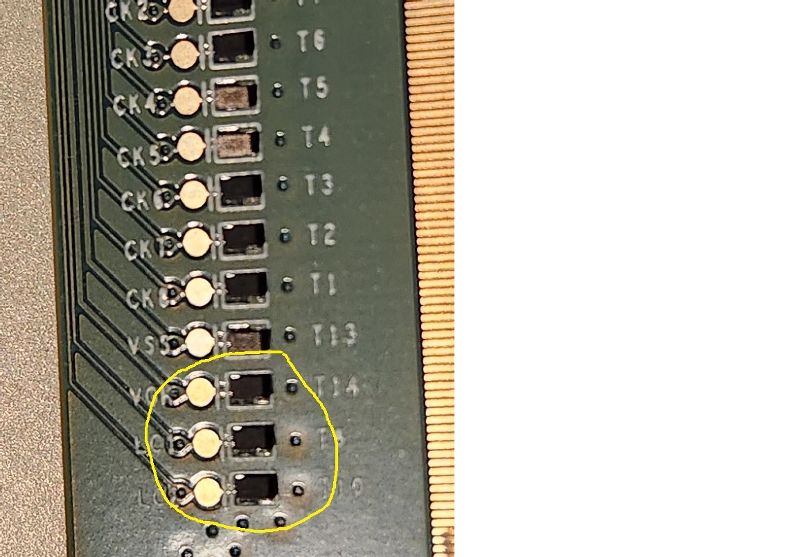

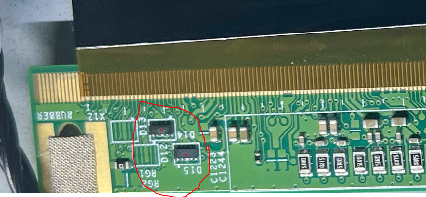

                        Lotas, after a second look , I did find some components that look like protection diodes. Click image for larger version
                        The circled components are the one that are connected to the pins that I have masked with kapton tape.
                        The test points in question ( LC2, LC1 and VGH) are not shorted to ground. Should I try to remove one of them tomorrow and see if the TV will turn on with only 2 pins covered with tape? I just do not want to make it worse BTW the marking on one of them seems to be S06 or SC8...under the microscope they look like diodes, very tiny..could not find a datasheet for them.
                        • Davi.p
                          Hobbist Tech
                          • Sep 2009
                          • 4367
                          • Italy - Milan
                          do not hope much that the diodes are failed, the fault is elsewhere..

                            Sorry this is the image of the wrong buffer board.
                            • mrtek
                              • Oct 2010
                              • 61
                              You are probably correct. One of the test points is VGH...I can't imagine that signal is dead , otherwise the whole TV would not work. I would have to check the signals with and without the tape applied on the flex cable.
                              • mrtek
                                • Oct 2010
                                • 61
                                New update.
                                I was ready to read the voltages / signals at the testpoints listed before. So I removed the end of the flex cable going to the faulty buffer board. Turned TV on and at the VGH test point I was reading 24.6V to -6.95V. It was fluctuating between these 2 voltages. Then I remembered that some Samsung have a feedback signal coming from the left and right buffer boards feeding into the T-CON circuit....it is a closed loop. Plugged the flex cable back with no tape applied expecting the TV to fail / not turning on. To my surprise the TV turned on and the screen showed the QLED logo and showed the home screen. Turned the tv off and back on...still no issue. now the TV is running perfectly and left it on waiting to fail.I now have no clue what is going on.
                                More updates later if anything happens..
