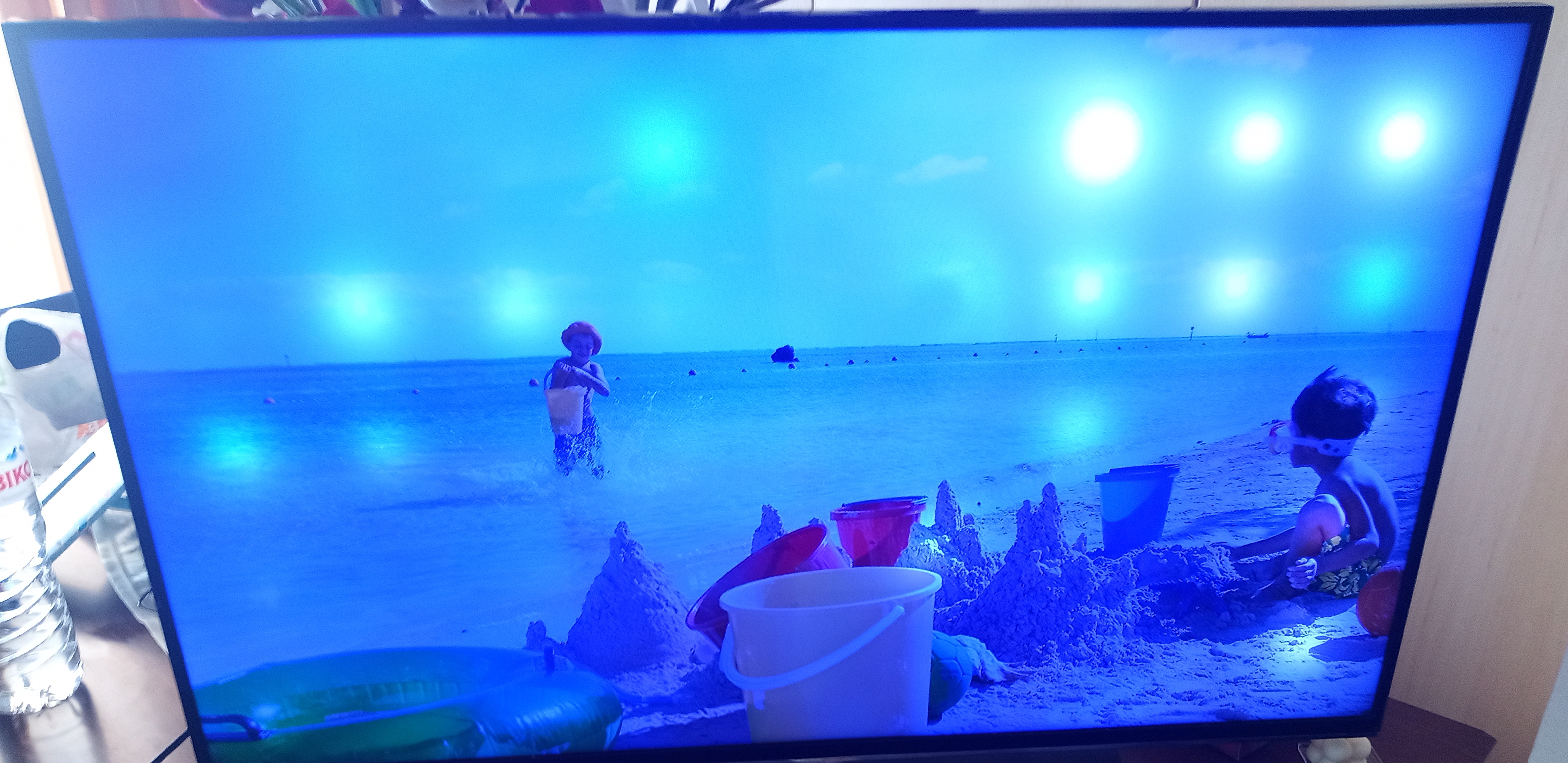

    hi as you can see and from photos i have unusual colours on tv
    the problem on your opinion is caused from the filter that they missings in someone leds and likes as bright spots ?
    thanks in advance

    Blue light is degradation of LEDs, white spots are lenses (diffusers) that have fallen off the backlight strips - replace them with new backlights and everything will be fine.

      It's interesting to see how the two faults are both present, so how many time it is so? Has it worsen with time or it appeared so in a day?

        Such malfunctions always appear over time.
