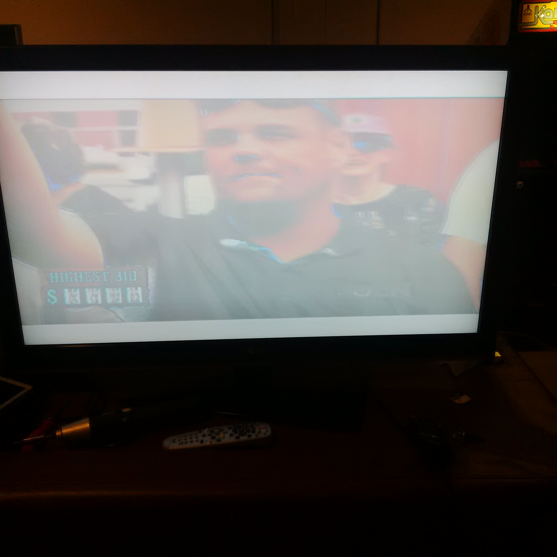

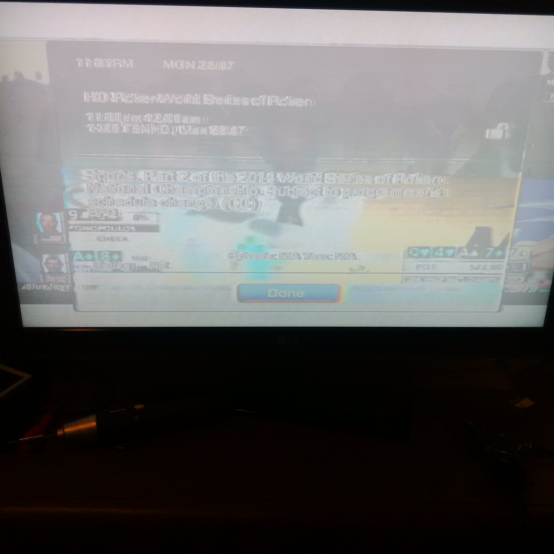

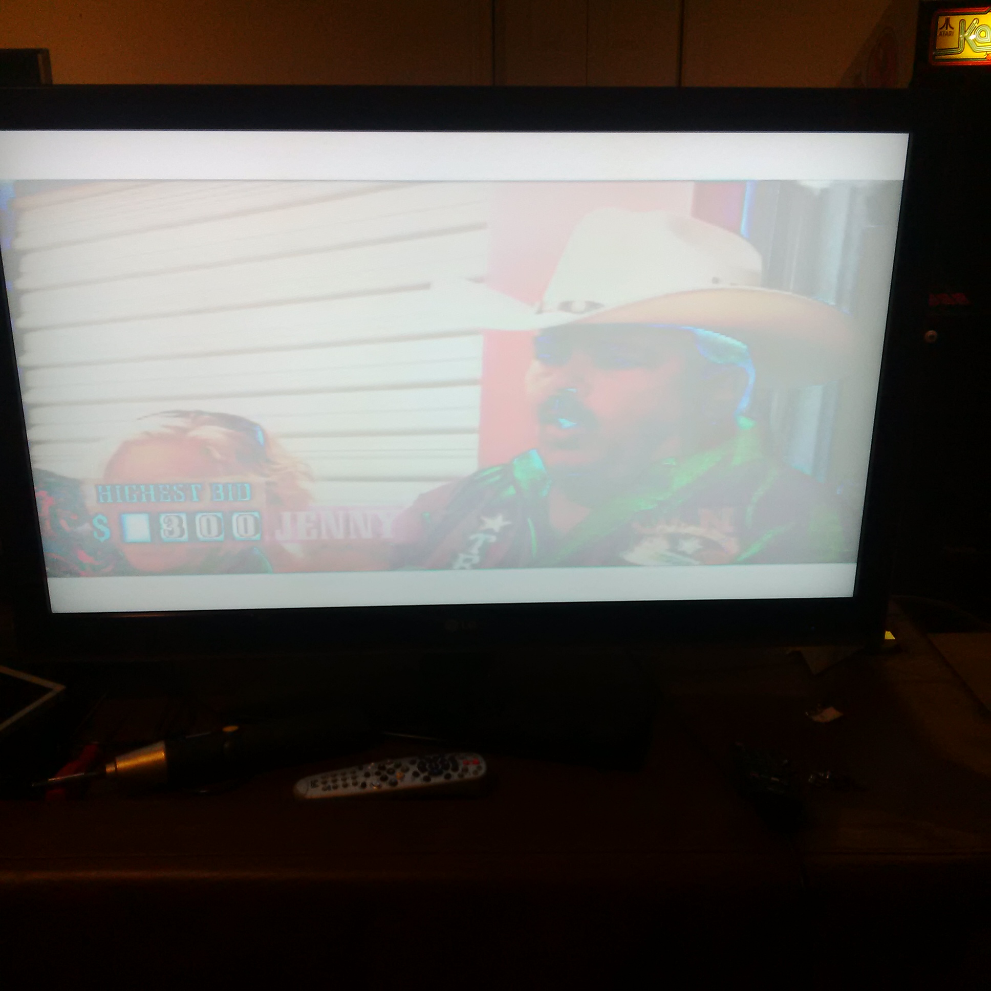

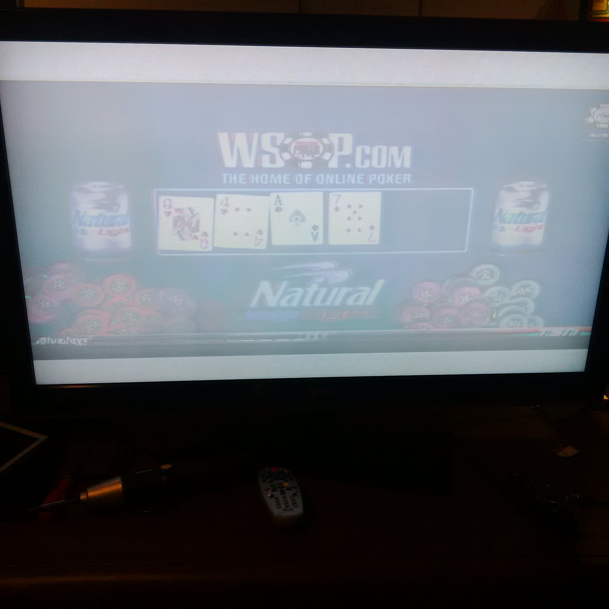

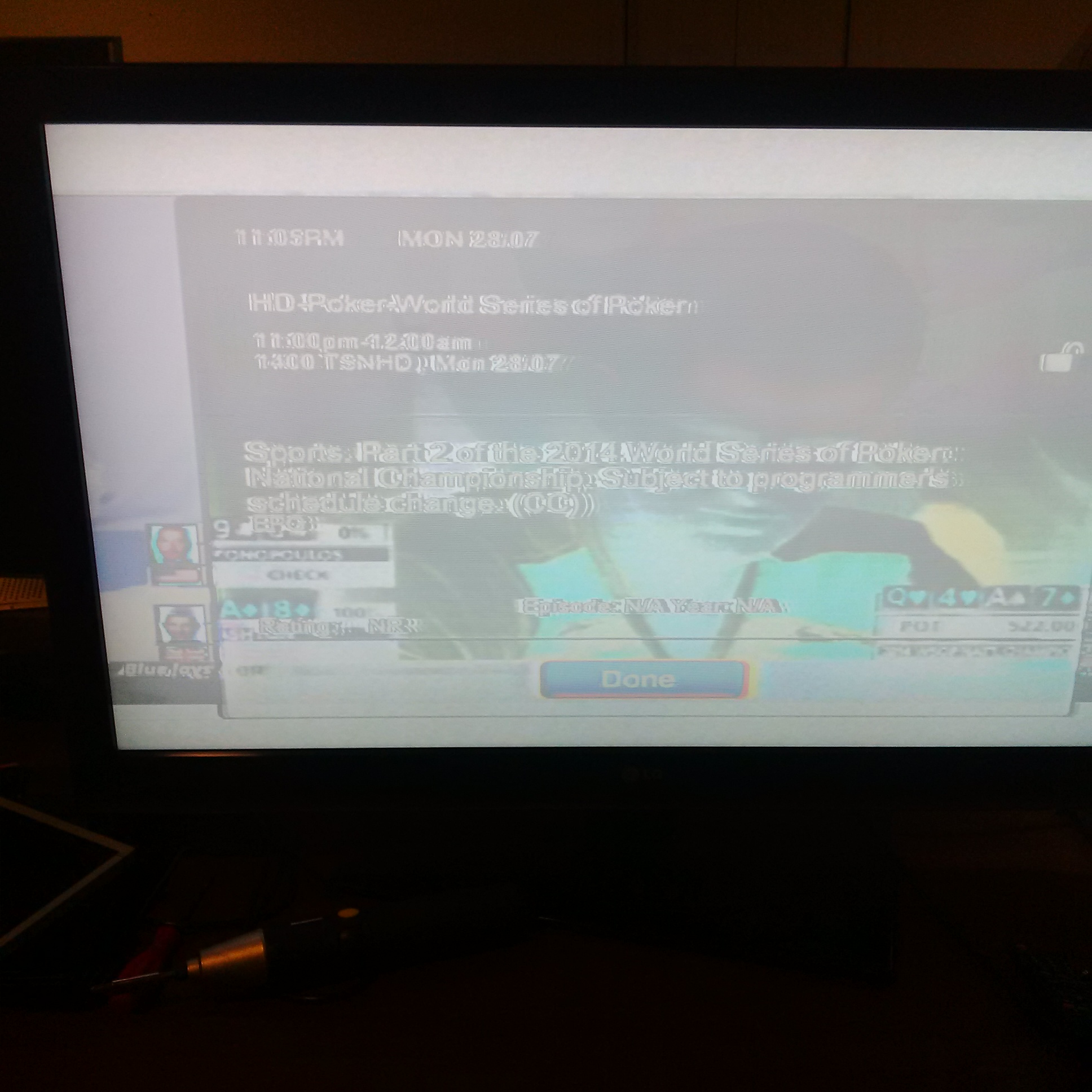

42LK450. I've read that it's probably the mainboard on the tv. I've attached pics. But my real problem is that I cannot get the service menu up. There is no menu button on the tv or the remote. They call it home. But holding both still doesn't give me the service menu. Ideas on the tv and the service menu?
42LK450 Similar Problem White Wash
Re: 42LK450 Similar Problem White Wash
It looks like bad Gamma voltages on the T-CON board.Never stop learning
http://www.badcaps.net/forum/showthread.php?t=24809 -
You can check the gamma voltages first to be sure...Please do not PM me with questions! Questions via PM will not be answered. Post on the forums instead!
