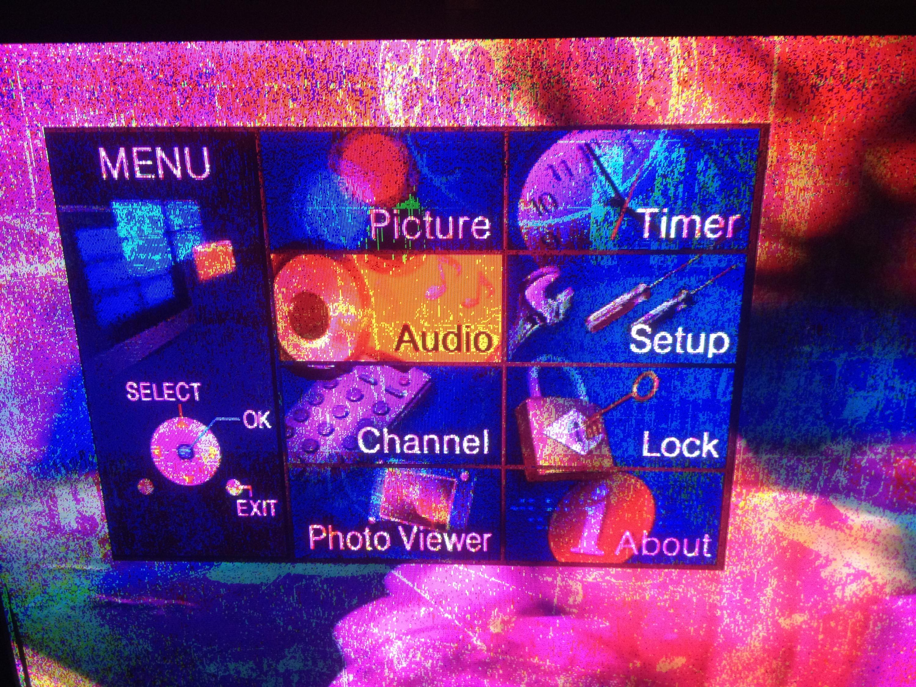

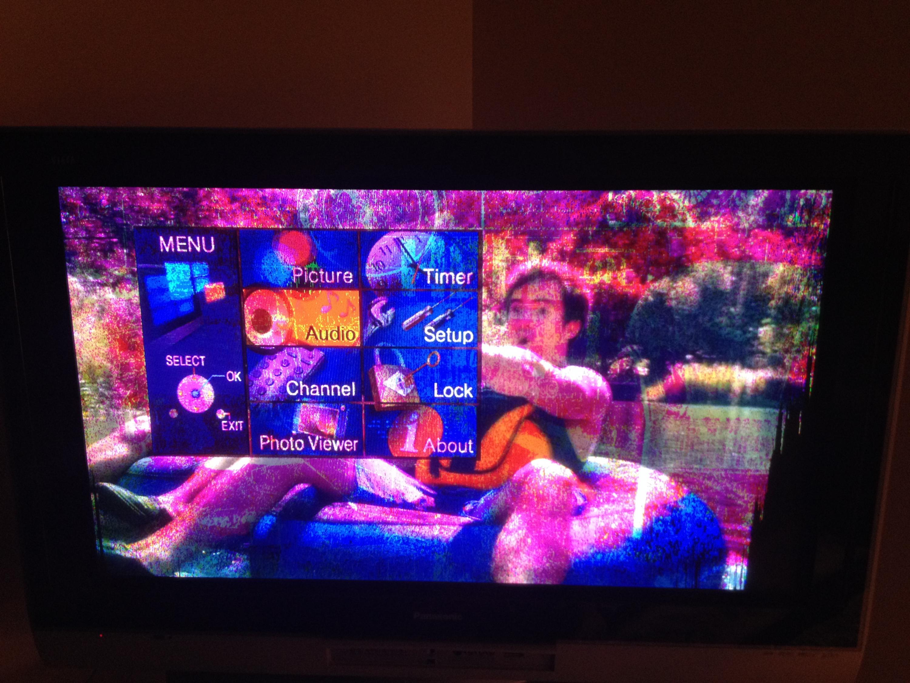

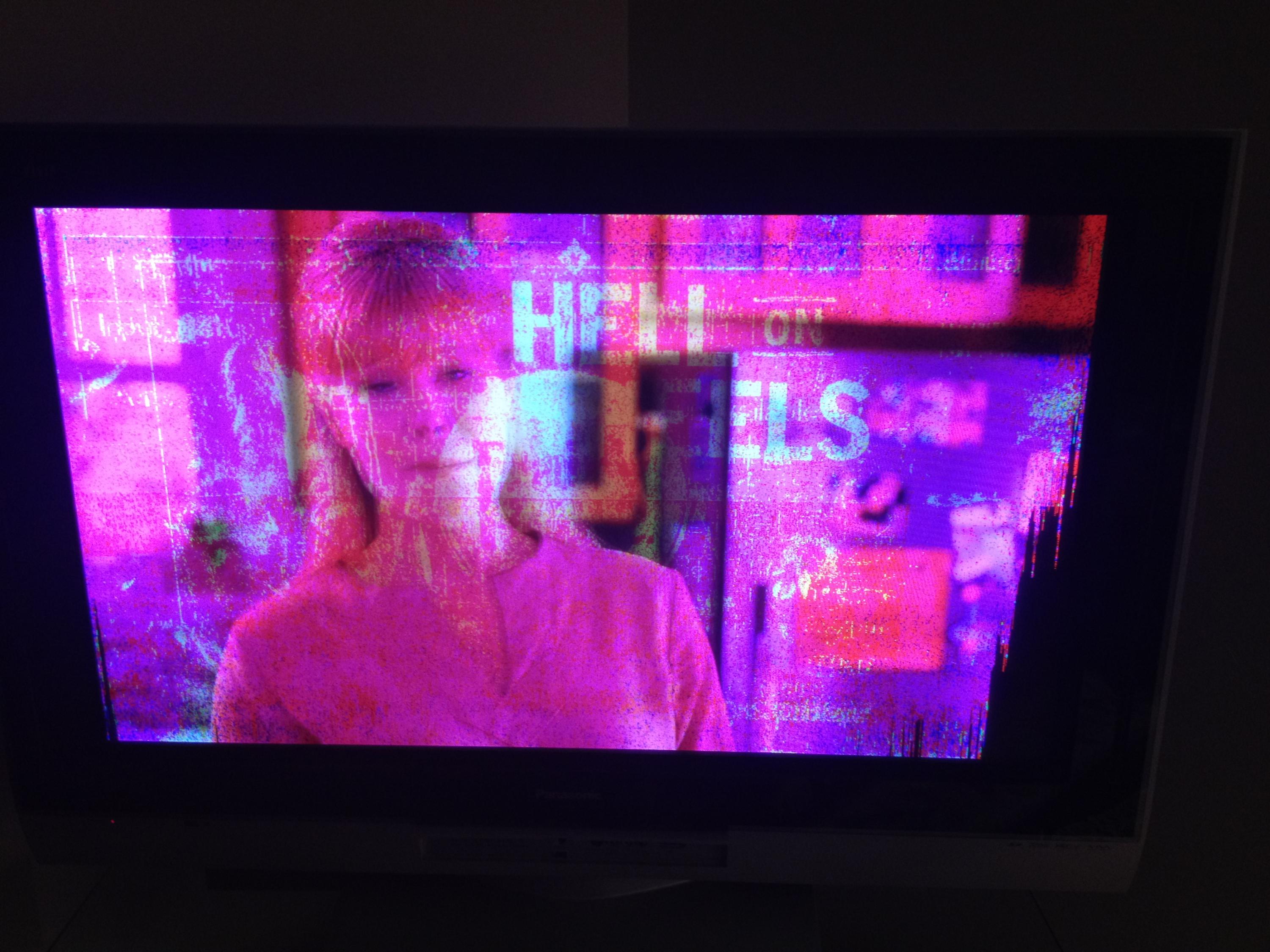

    I turned my tv on yesterday and the color is all red The picture is visible but everything has a red tint and there are ghost images on the screen. hoping for some insight on this problem.

        Re: panasonic plasma TH-42px25 red screen
        I uploaded the pictures. i also brought up the tv menu because the functions seem to work
          yeah, that changes things. I'm thinking SS board now. maybe wait for some other opinions on it. Not sure if SC board can cause that or not.

                    I think this is 2nd gen Panasonic plasma (2002?), my bet also to SS board.
                      It is about 10 years old. which one is the ss board and is it worth fixing? I took the back cover off and can see all the boards. If it is the ss board, do I just replace that one?

                              I love the tv. I figure its 11 years old. I have not had any issues with it at all up until this. it is the perfect size for the room and if you guys think that the ss board could be the problem then ill go that route. I am sure that a new tv would be much better with picture quality but I have a hard time letting go of things that I like. I am going to get the ss board and see if it fixes it.
                                Ok so i purchased the ss board and installed it last night. That did not fix it. Any ideas ? Should i try the sc board or call it qiuts?
