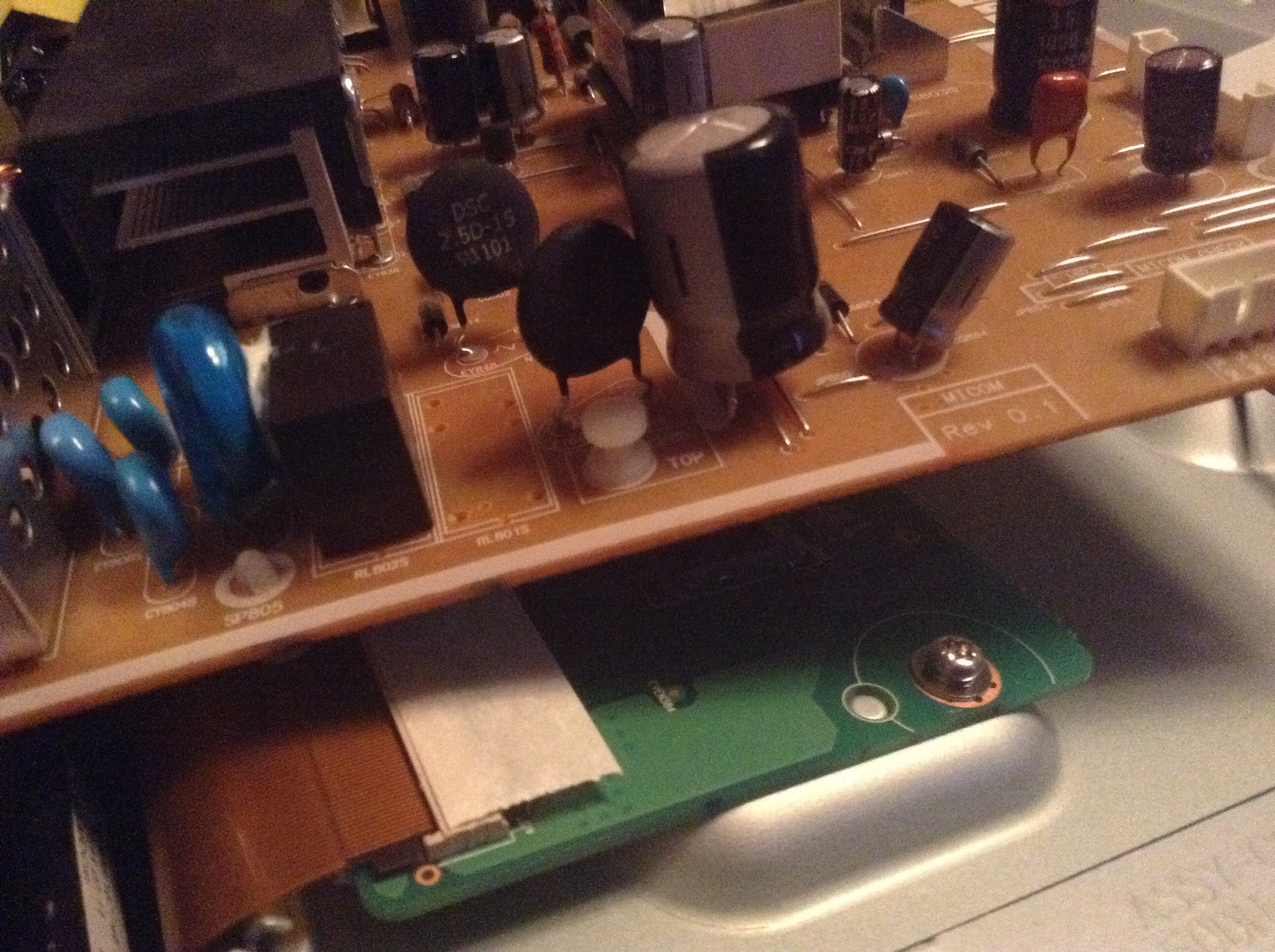

    Trying to fix this TV for a friend.
    Was working ok then "popped" and won't turn on.
    I have opened it up and all seems fine bar one capacitor, see picture below.
    Am not too sure if this one capacitor alone would stop it working?
    The TV power button lights up and flashes each time.
    I have also tested the fuse on the power board which reads 0.3 across it.
    Any ideas appreciated.....

    Re: Samsung PS51D495A1K
    Absolutely possible.
    The fuse is good.
    That looks like a Samwha capacitor. If you want the set to last, replace all of the Samwha capacitors.
      Popping is not always a capacitor. Look for cracked diode and transistors or even I chips.
          Sorry for the late reply. The TV is still open if you want to know where anything goes let me know.
            Have sorted mine out now, all fixed and sold.
