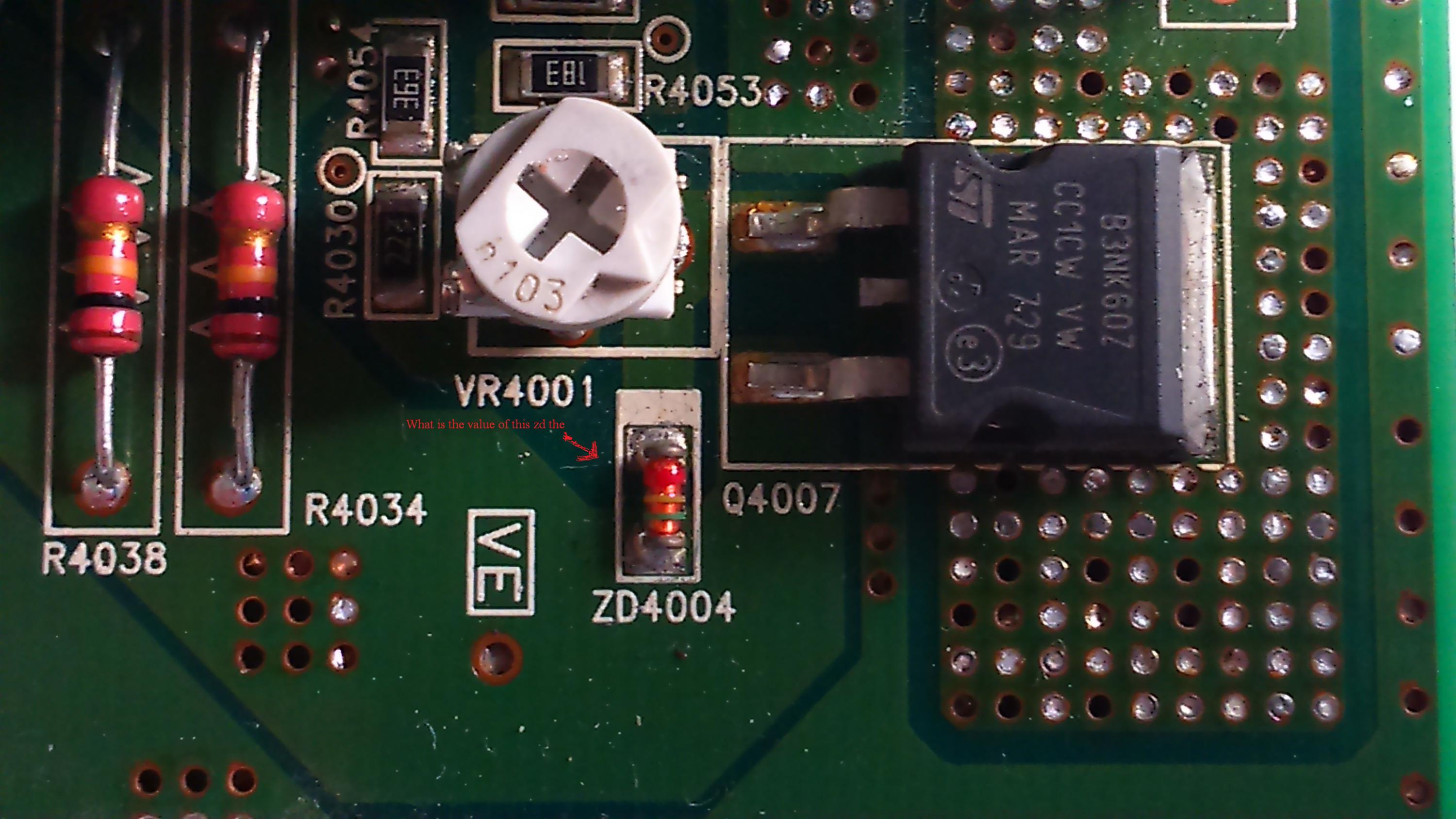

          Hello there
          I can dir What is the value of the zener diode that red and yellow and green thank you for your help
