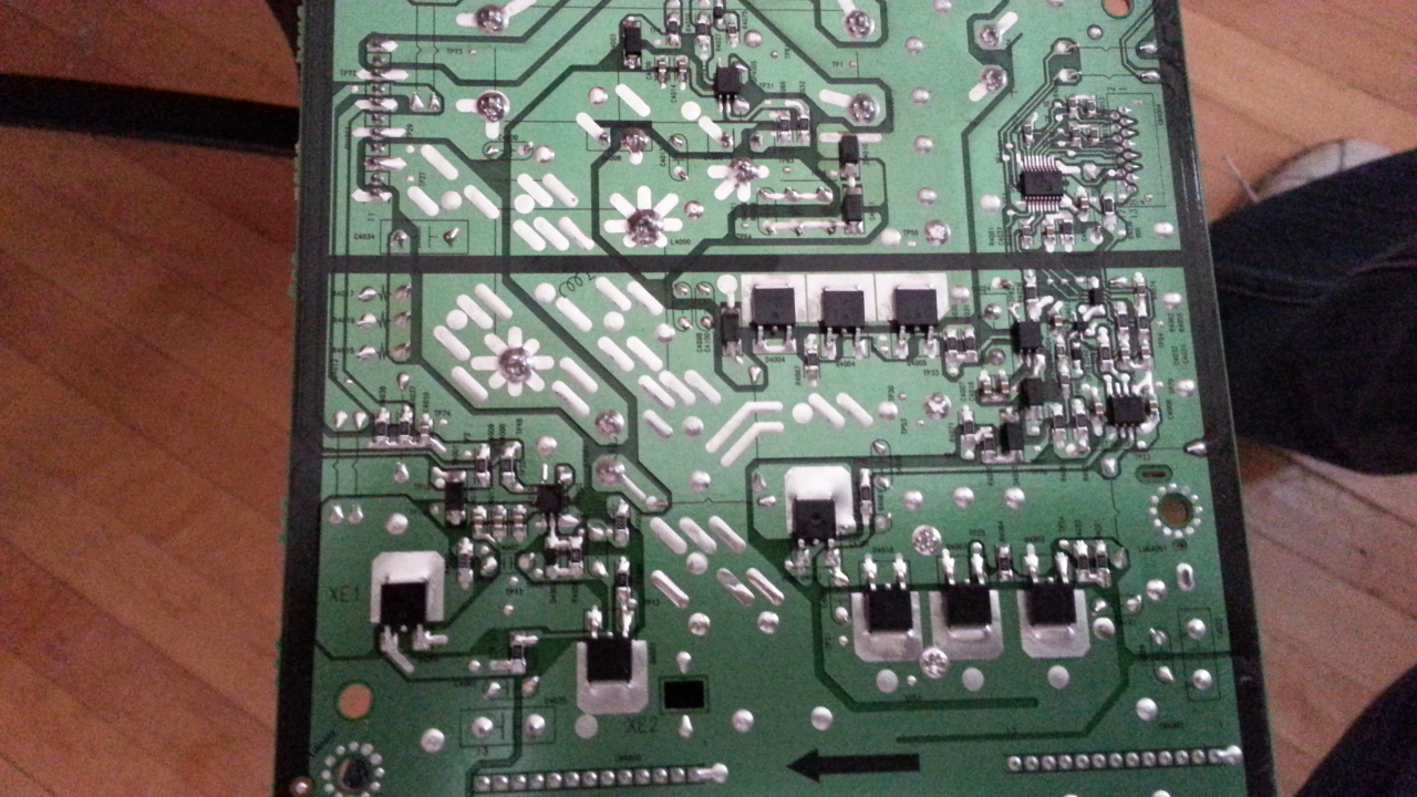

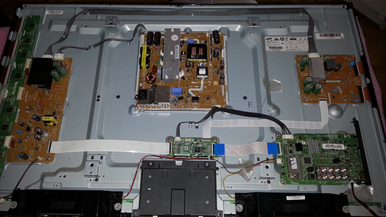

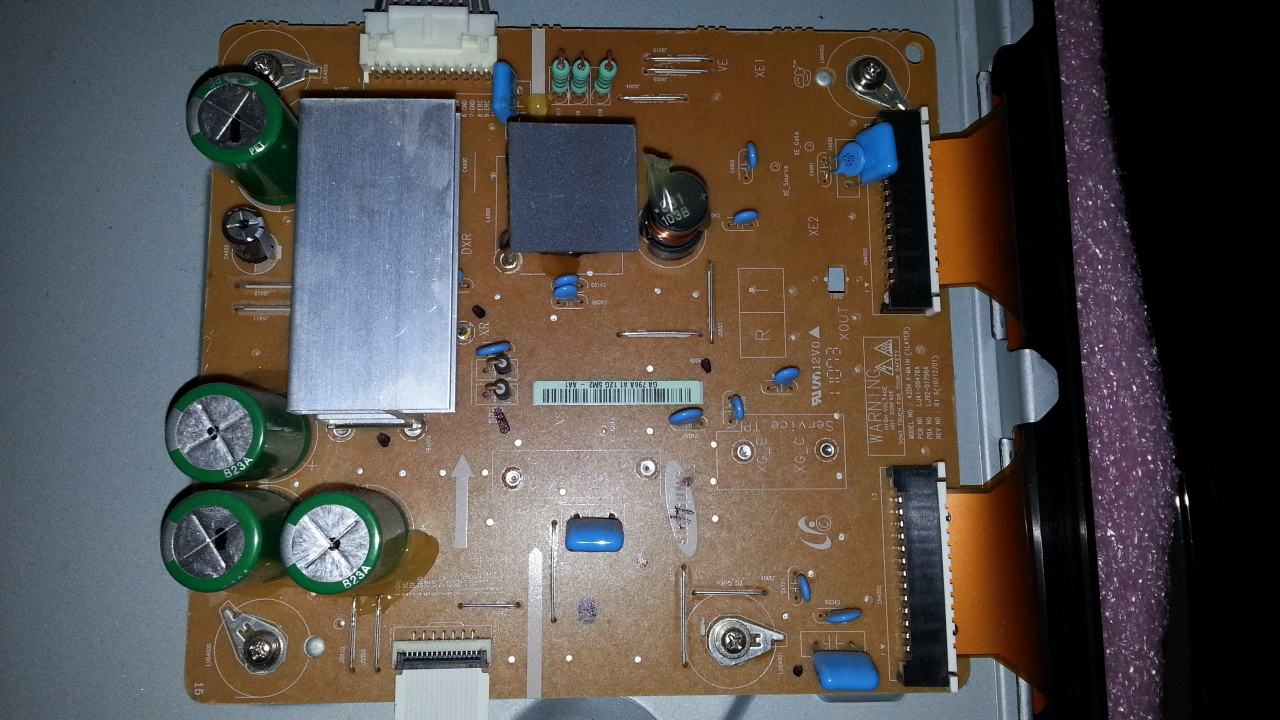

    Re: samsung PN43D450A2D relay clicking no sound no picture
    Here is the board lay out
    No visible defective components
    I still have to remove the boards to inspect the bottom side

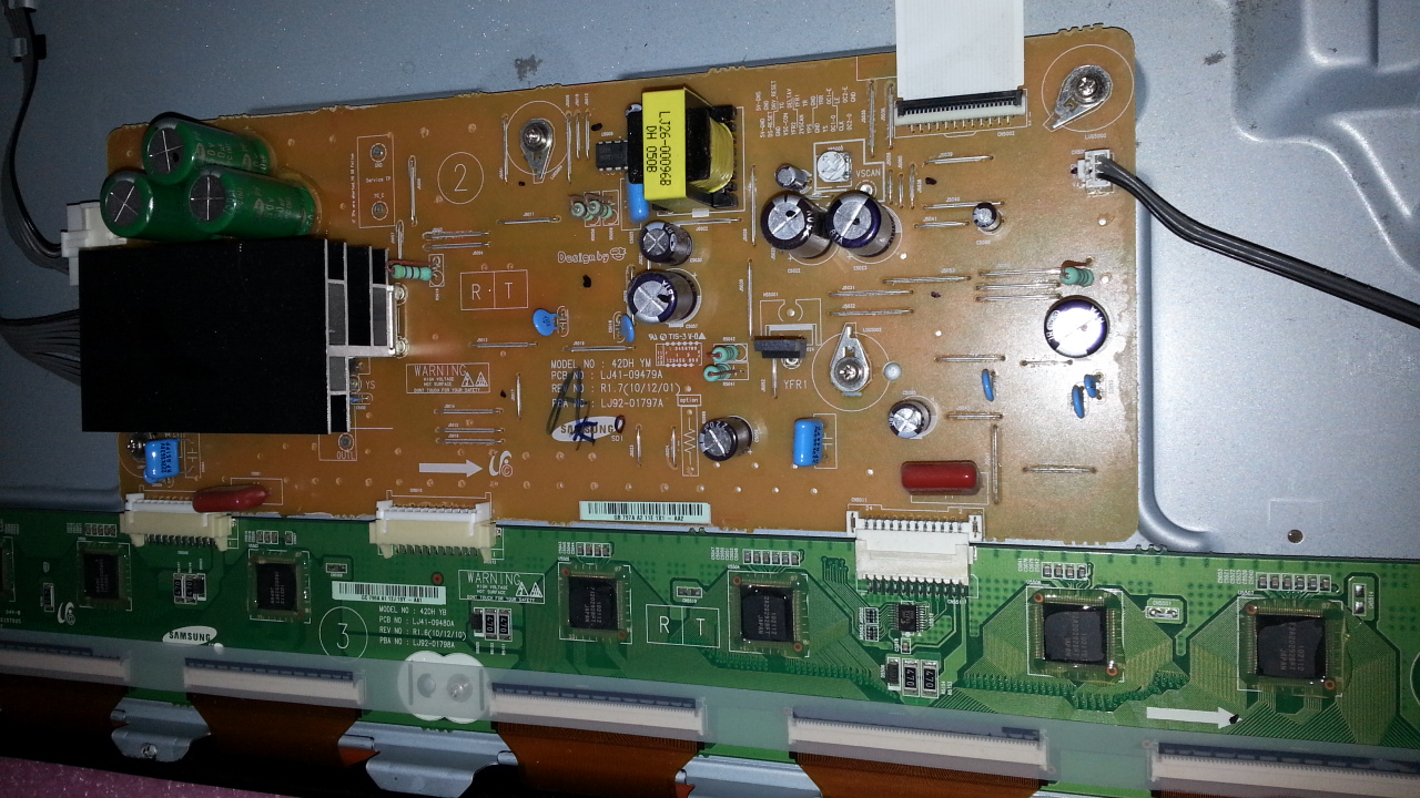

      I just was working on one of these, check the Z-(x)sus (last picture) there are usually 4 transistors shorted and they usuall replace the drive ic,
      4 - RJP30H2A
      1 -TND315 ic
      Then update the firmware after the repair.
          4 - RJP30H2A
          1 -TND315 ic
          Are you talking about the ymain board or the x main board?
            You will not see panel glow with a Y-main is disconnected. Anyway these Samsung panels will shut down if the X-main or Y-main is missing. Just check for shorted transistors on the X-main, as R_J says it's a common fault.

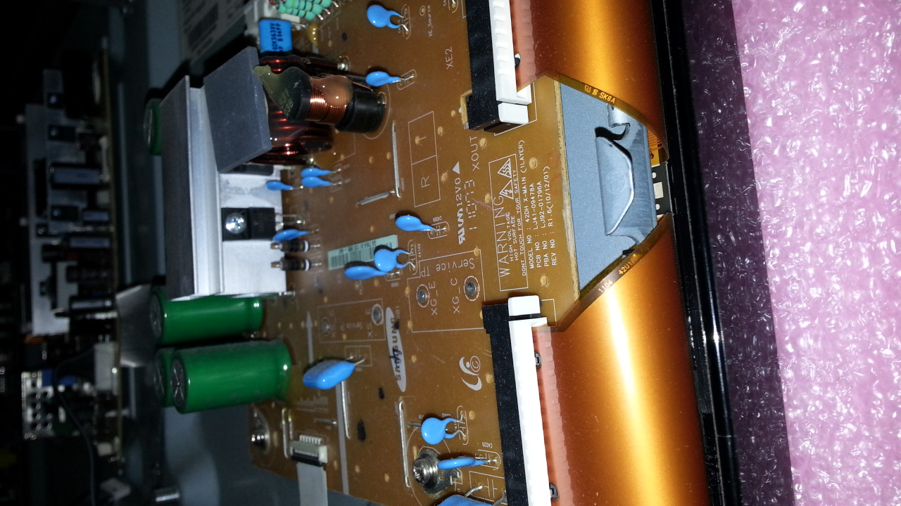

              Where are the transistors on the xmain? I dont see it
              Are you talking about the 2 on the heat sink?
              • jose6326
                • May 2013
                • 707
                I found four RJP30H1
                    Test all the transistors, the RJPs fail most often but not always.
                    • jose6326
                      • May 2013
                      • 707

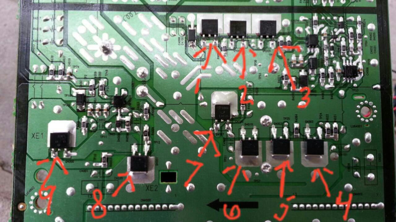

                      Tom just to refresh I place the negative lead on one leg and the positive on the other 2 legs and reverse the procedure to test the transistors?
                      Can I test these on the board?
                        Test all three combinations of pins: 1-2, 2-3 and 1-3; the polarity doesn't matter for now, you're just looking for short circuits.
                        They can be tested in circuit.
                        • jose6326
                          • May 2013
                          • 707
                          Here is what I got
                          1, 2 - 0.1
                          2, 3 - 0.1
                          1, 3 - 0.1
                          Same as #1
                          Same as #1
                          Same as #1
                          Same as #1
                          Same as #1
                          1, 2 -22.00
                          2, 3 - 4.83
                          1, 3 - 12.60 and goes up
                          1, 2 - OFL
                          2, 3 - 4.69
                          1, 3 - 19.81
                          1, 2 - OFL
                          2, 3 - 4.81
                          1, 3 - 20.39

                            Numbers 1 and 6 are probably ok, you need to remove the small legs of the transistors 2-5 as they are connected in parallel. There are kits available on internet
                              No, to me, looks like 1-6 all shorted.
