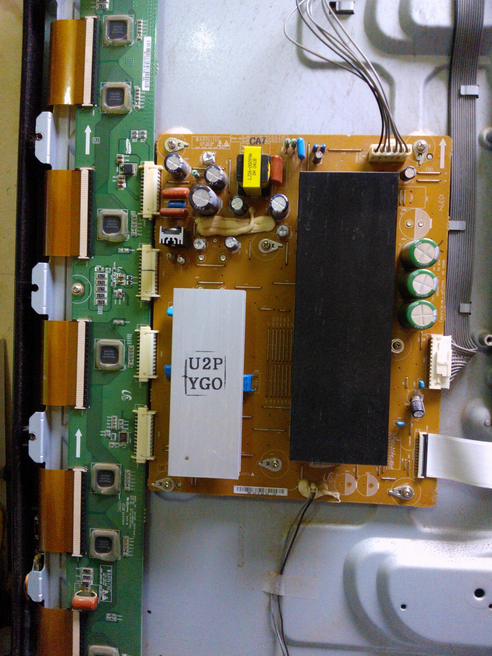

    hi ,i have 50 inch plasma TV model PS50C450B1 when i switch it on everything works perfect after one minute it will go off and the relay will be clickling on and off for sometime and then it will come on again then repeat the same cycle,any advise where to start checking thankx

    post pictures of the boards,try and make as clear and detailed as possible..

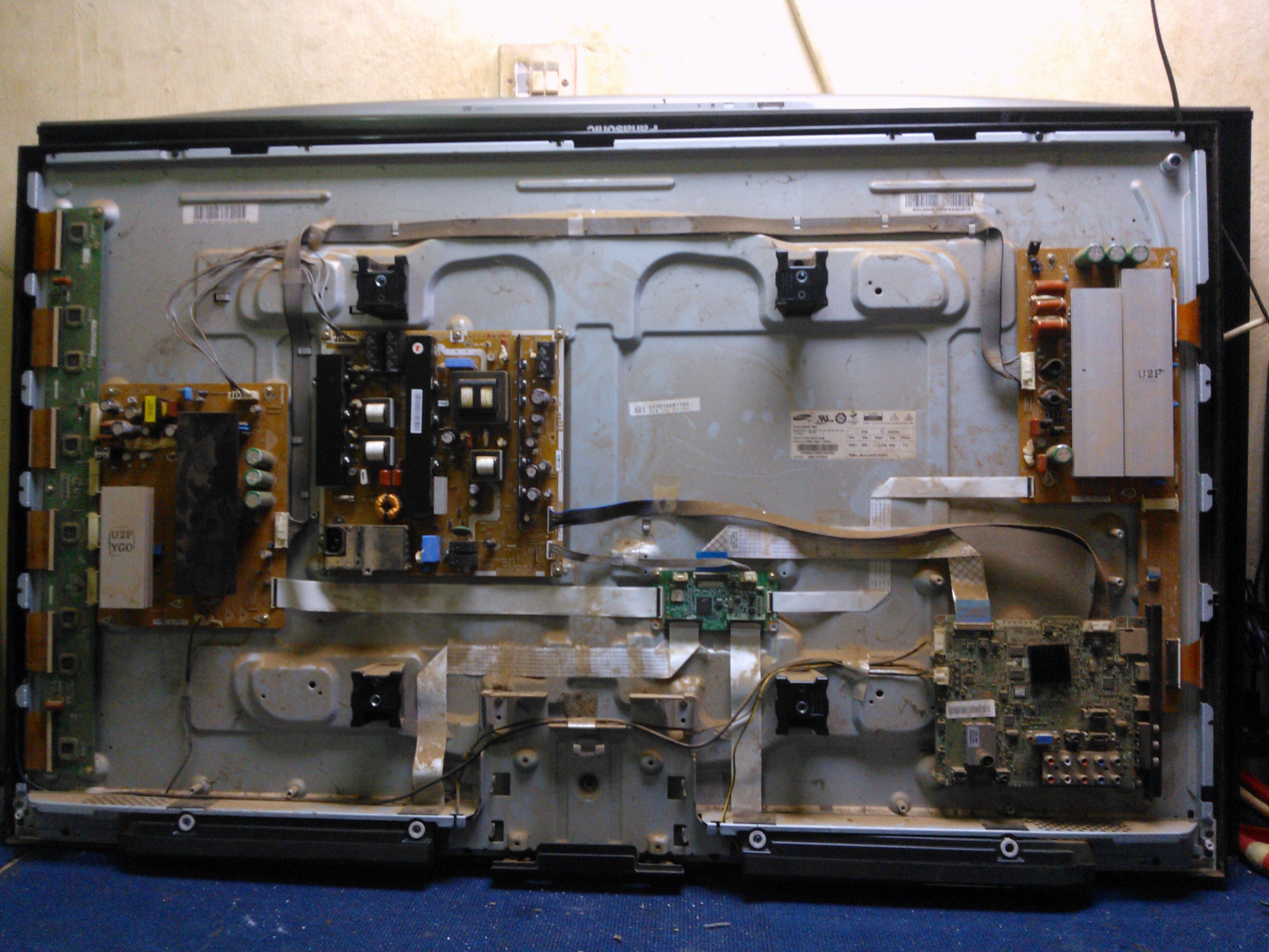

      this the picture the tv

        Re: 50 inch samsung 2010 model
        you should take close up pictures of each board as well
        you should really clean all that dust off with compressed air

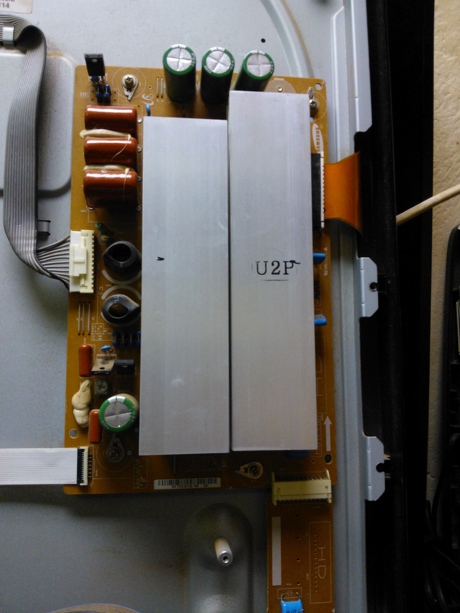

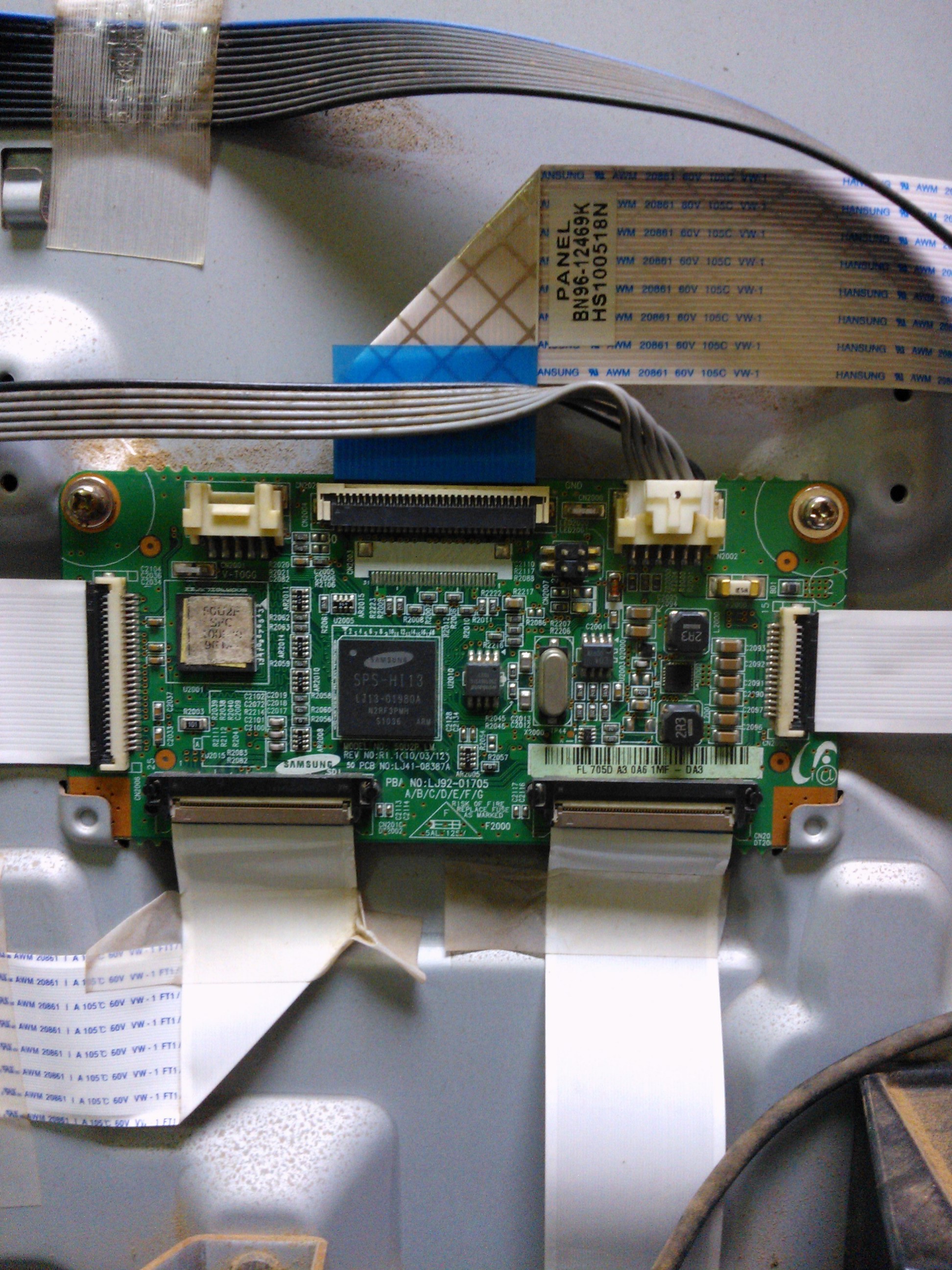

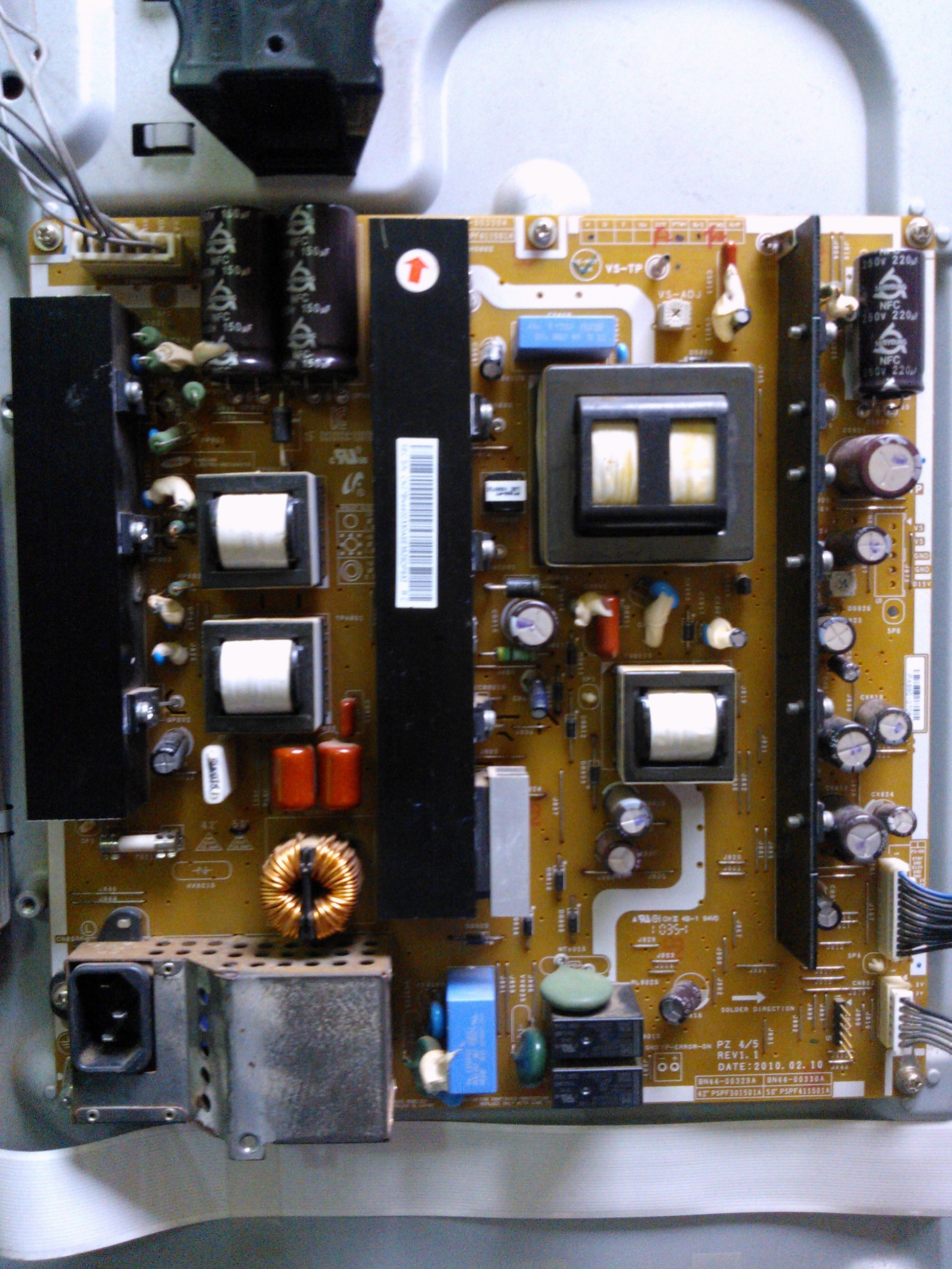

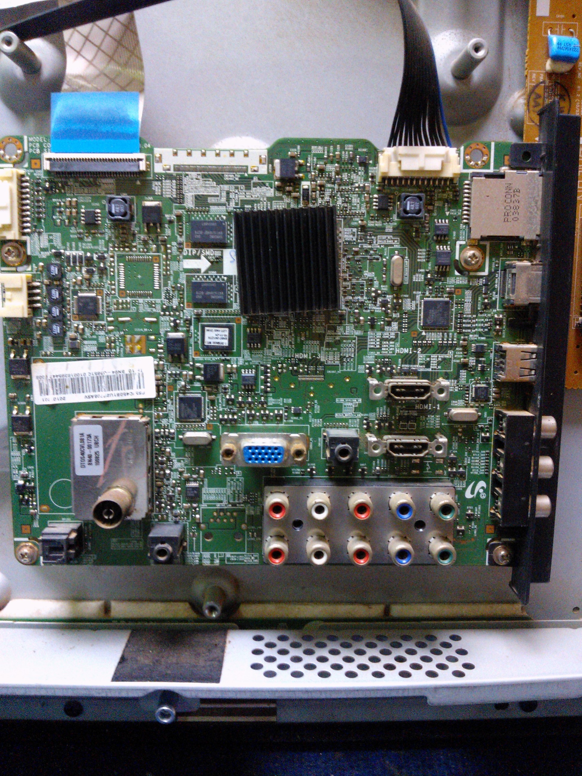

          these are the other pictures

            Have you checked the small white fuse on the Tcon - Pic 2 and what volatge do you get on each side of it with respect to ground

                What does the light on the control board do when it turns off?
                Connect PSON to GND via a wire (unplug connector from main board end)
                Jumper pins 3 and 4 on control board on 4 pin connector block
                Plug TV in, you should get test patterns, see if TV keeps going or if it shuts off.

                    hi tom66 which PSON are you refering too the one on the control board or psu
                      On the cable between PSU and main board - unplug end connected to main board

                            i did what u said is the test partern is coming and it does not go off
                              Good, this confirms the main AV board is bad, you will need to repair or replace that. The main AV has the HDMI ports on it.
                              I just got a 51" D450, a year newer than your set, it has a bad main board too.
                              One possible failure is the BGA chip, may need a reflow/reball. Also try doing a full factory reset: in standby (with main board connector attached again and test pattern jumper removed) press INFO, MENU, MUTE then POWER on the remote control, wait for it to enter service mode, then select RESET or FACTORY RESET.

                                thanx after i did the reflow is now working perfect
