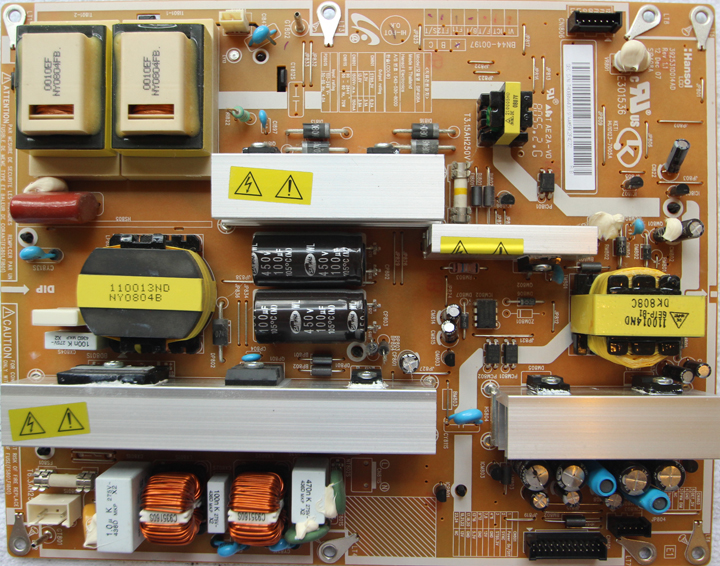

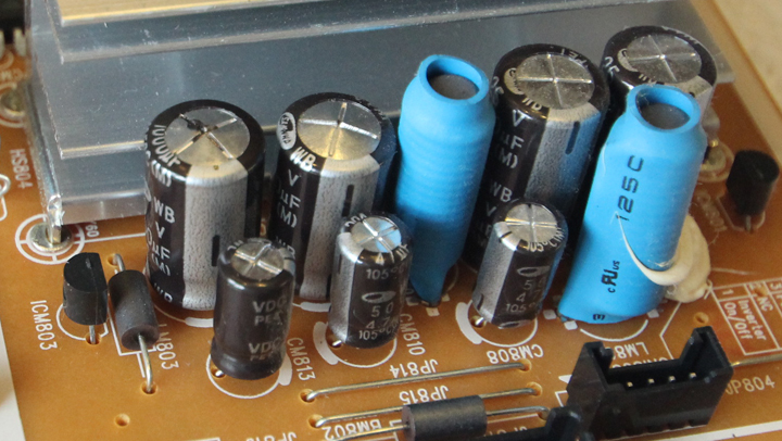

    Samsung LN40A550 white power light
    Samsung LN40A550 TV - when powering on it takes a few minutes - then bottom center white light comes on - a few seconds later the Samsung start-up audible is heard followed by a brief screen light up (with cable channels showing). Then all goes black again followed by the process repeating itself continually. I pulled the cover and found a couple of bubbled 10/1000 capacitors on the power supply. Am going to replace, but do these symptoms point to something else? Photos attached.
  • Hamie
    • Apr 2014
    • 1383
    Re: Samsung LN40A550 white power light
    That would cause the power cycling you are experiencing.
    Repair kit for this shows a few other well known capacitor locations that have a tendency to fail.
    • phil@philporter.com
      • May 2013
      • 113
      Thanks. I think I have some of those, but will save the link. I'll let you know how it goes. Thanks again.
