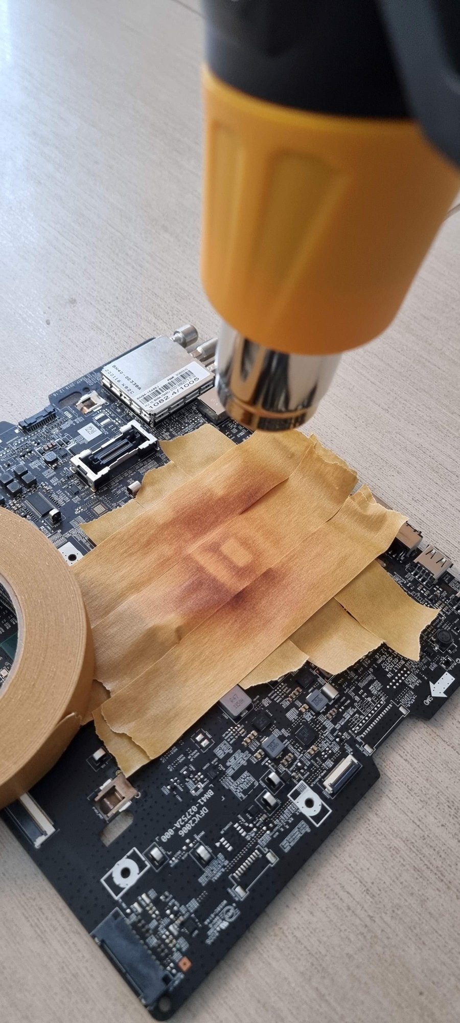

    Qn65q800taa won't start
    Did some of the usual troubleshooting.
    Unplug main board connector and back lights come on and stay on and PSU supplies all correct voltages on the legend.
    When you just plug in the TV the PSU relay clicks on and off immediately and then continues to click on and off every 20 seconds or so. The red light on the front flashes once and then 5 to 8 seconds later flashes once again and continues the cycle with the relay.
    I've disconnected each you ribbon cable one at a time and every single T-Con cable one at a time to see if there's any change. No change as long as the main board is connected. I have also disconnected all ribbons leaving the main board to the panel and the TV performs exactly the same way.
    When it is clicking on the PSU the back lights don't do anything and the TV does nothing except for the red light blinking.
    Anyone got a clue about this. It seems that the motherboard is a common failure on this TV.

    A common problem with this motherboard is processor failure, a high-quality processor reballing is needed.​

                            Here is one of the topics, and the same is on Russian forums, that there is a defect in the soldering of the processor....
                            https://www.eevblog.com/forum/repair...nboard-repair/

                                    Pulled screen just because I haven't seen under a 8k screen before. Lights look good. All zones light up
                                    I see why a "good" reflow station is needed for main board. The entire bottom has a giant heat shield on the bottom of it. Although the spot where the IC is open almost every else has it. I'll send a pic with it soon.

                                      "good" reflow station are nothing, another methode also work perfect, only stencil are the Professional

                                        Well I ended up picking up a ir6500 for $100 which I felt was damn good price. So I'm testing with boards currently but seems like it's working pretty good .

                                          So was able to reflow the chip and now the same pattern doesn't happen.
                                          Now the tv turns on with backlight, the red light flashes like it's being held down and there is now no picture. Yay 😐
                                          Only did the chip mentioned. I do not have those shorts as mentioned either
