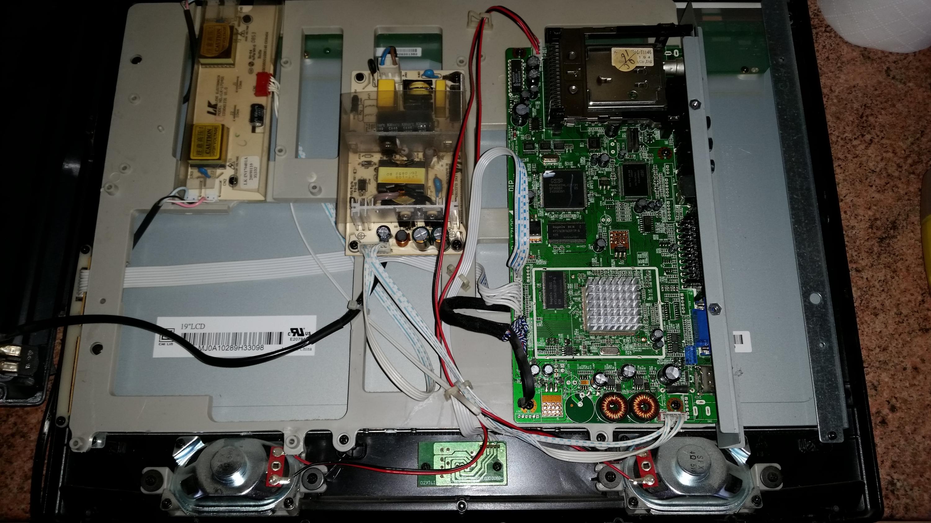

    hi guys ive got this latest tv the left speaker has a annoying loud buzzing sound any ideas whats causing this ?
    thanks
    Re: Murphy tv19uk10d
    The right speaker is / is not affected?
    Sound good from left but with buzzing - or no sound only buzzing?
    All inputs affected or only certain inputs?
      hi tom
      the right speaker is fine ive just found a spare pair of speakers but its the same problem with those installed ive tried the tv with hdmi connected the sound in the right is fine,it also buzzes with nothing connected on the left side
        So with only left connected you can ONLY hear buzzing, or you can hear audio + buzzing?
          audio and buzzing but its slightly distorted tom
            Can you get the part # of that chip near where the connectors for the speakers are... NXP something or other.
              Nxp tda1517p
              g57265
              yng08403
                Trying to think of an easy way to test it... You could try hooking up a pair of sensitive headphones (600 ohms or greater) to pin 9 or pin 1 to check the audio signals going into the amplifier. Otherwise, you will need an oscilloscope to test it.

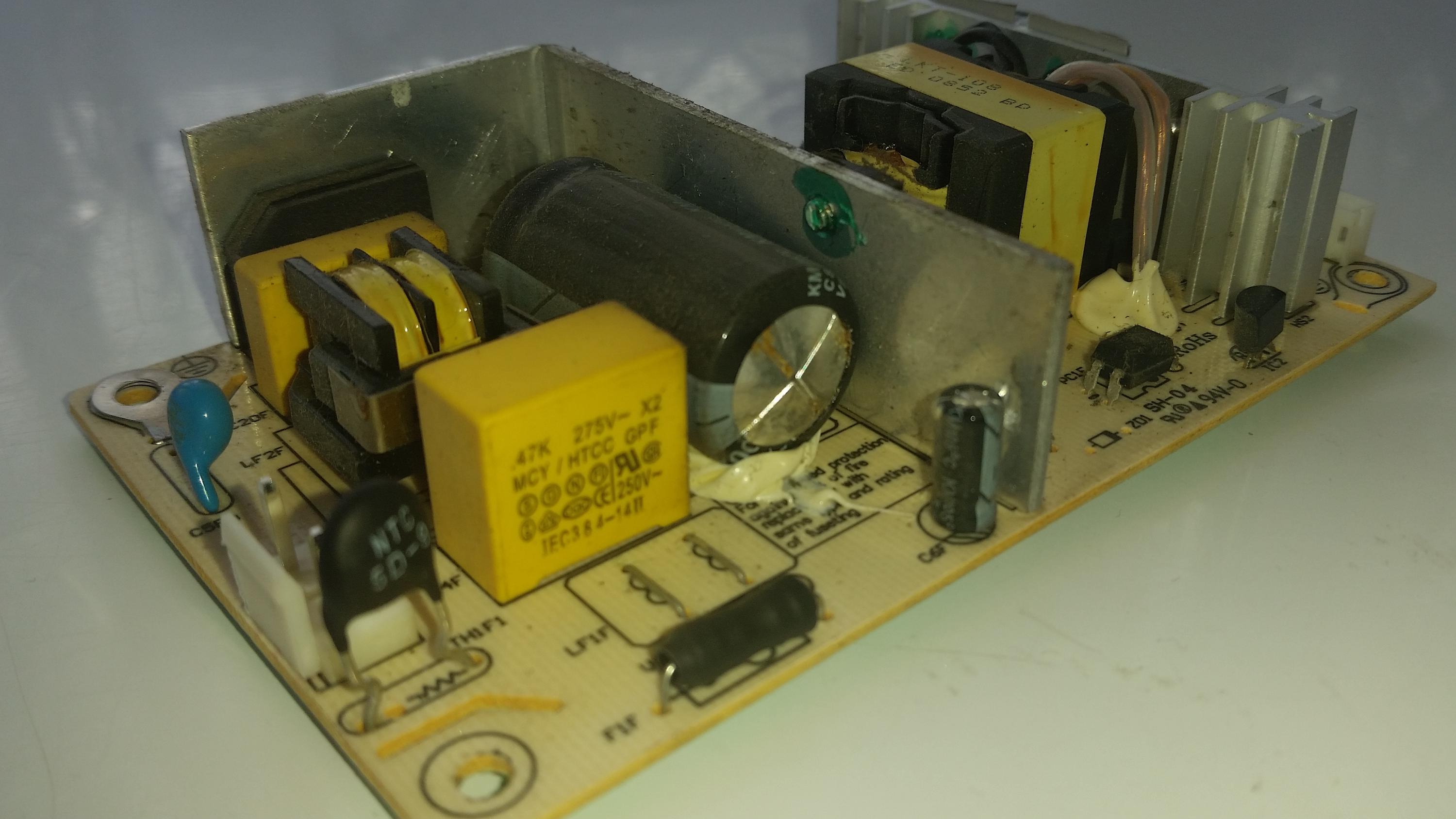

                    could be a bad dc blocking cap,
                    but that usually makes these types of amp get VERY hot.
                    maybe instead of headfones,
                    you link the left & right inputs on the chip.
                    if you get noise on both channels it's before the amp.
                      UPDATE :
                      just a update incase anyone else has this fault it was the power supply at fault luckily had a spare unit which i changed tv fired up no problem with no buzzing,turned out it was the main cap bulged which i missed
                        The 400V one?
                          yes tom
                            I'm surprised that didn't cause other issues; only a matter of time, at least.
