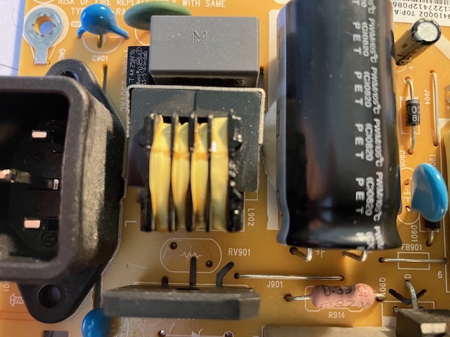

Insignia NS-LCD019-09 issue: Power light turns blue for 3 seconds, the flashes red before going solid read again

      Check Q901, make sure none of the 3 pins are shorted to any of the others.
      • cajoeg
        TV_Newbie
        • Feb 2025
        • 22
        I was about to test all of the capacitors, but while watching the video on testing the bridge rectifier, that other video listed on the right side of the YouTube screen caught my eye.
        No short at Q901. I will put the good bridge rectifier back in since my new ones will not arrive until just before mid-March. The new resistors are expected to arrive on 2/20/2025.
        Thanks for the tips!
        Joe

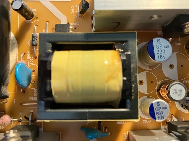

                                Last night I used the schematics to trace pin 4 (DIM) and pin 10 (ON/OFF) on the OZ9923 chip to see if any issues existed. I found no issues (shorts). Today I printed out the datasheet for the OZ9938 chip to learn more about the function of the other pins on the chip. Chip pins 5 and 6 deal with current/voltage sense feedback. It seems (logically only) as if the chip is not getting the feedback from the mainboard on the +5v lines. So I did some tracing of the +5v lines. All three +5v lines go back to the capacitor at C930, one of the Aluminum Organic Polymer Capacitors I have yet to replace. The replacement parts are scheduled to arrive today.
                                Will replacing it solve the problem? I don't know. But if the mainboard is not getting the feedback it expects, it's not going to start up (according to TampaTec). And the aforementioned capacitor has a role in the +5v.
                                During my tracing on the back of the board, I checked numerous things for shorts, and found nothing wrong.
                                We'll see what happens when I replace the Aluminum Organic Polymer Capacitor. I read that testing these type of capacitors is not the same as testing the other capacitors on the board, and that a Capacitance Resistance Inductance Digital LCR Multimeter is recommended.
                                I may be chasing the wrong thing, but I'm learning from the information that I have read, and the testing that I have done.

                                  SOLVED!!! My first TV repair!
                                  It was the Aluminum Organic Polymer Capacitor at C930 (680 10v). I replaced it this morning, and the TV came up immediately.
                                  Thank you to everyone for your guidance and help!

                                      By the way, you can dirty test those caps the same way as the electrolytic caps.
