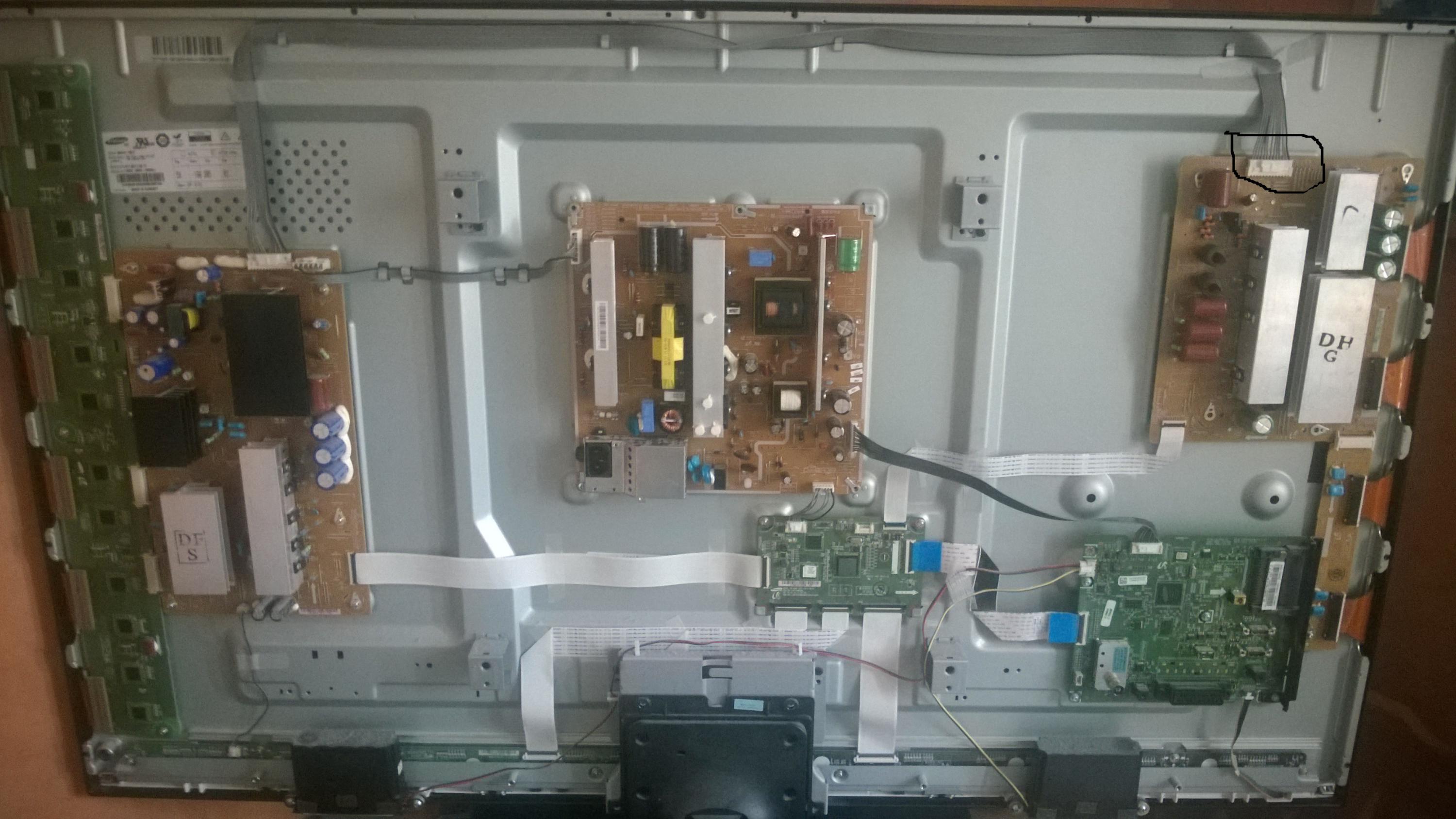

    Hello everyone.
    I have a Samsung PS51D535 that just clicks when i try to turn it on.
    I have taken the back off the and i see the little center board has a diode that blinks green once shortly and then once a bit longer and finally turns off.
    If i disconnect the circled cable upper right in the picture the green diode stays on and the screen flickers briefly.
    The power supply looks good, no bad caps, it has 5V and 15V out but no high voltage to the screen.
    Anyone that has experienced the same problem or have a idea what to do next?

    Re: Samsung PS51D535 just clicks
    This may help: https://www.badcaps.net/forum/showthread.php?t=37883
    LG Plasma Mal-Discharge Correction Service
      Ok, i hoped that my problem would be less severe.
