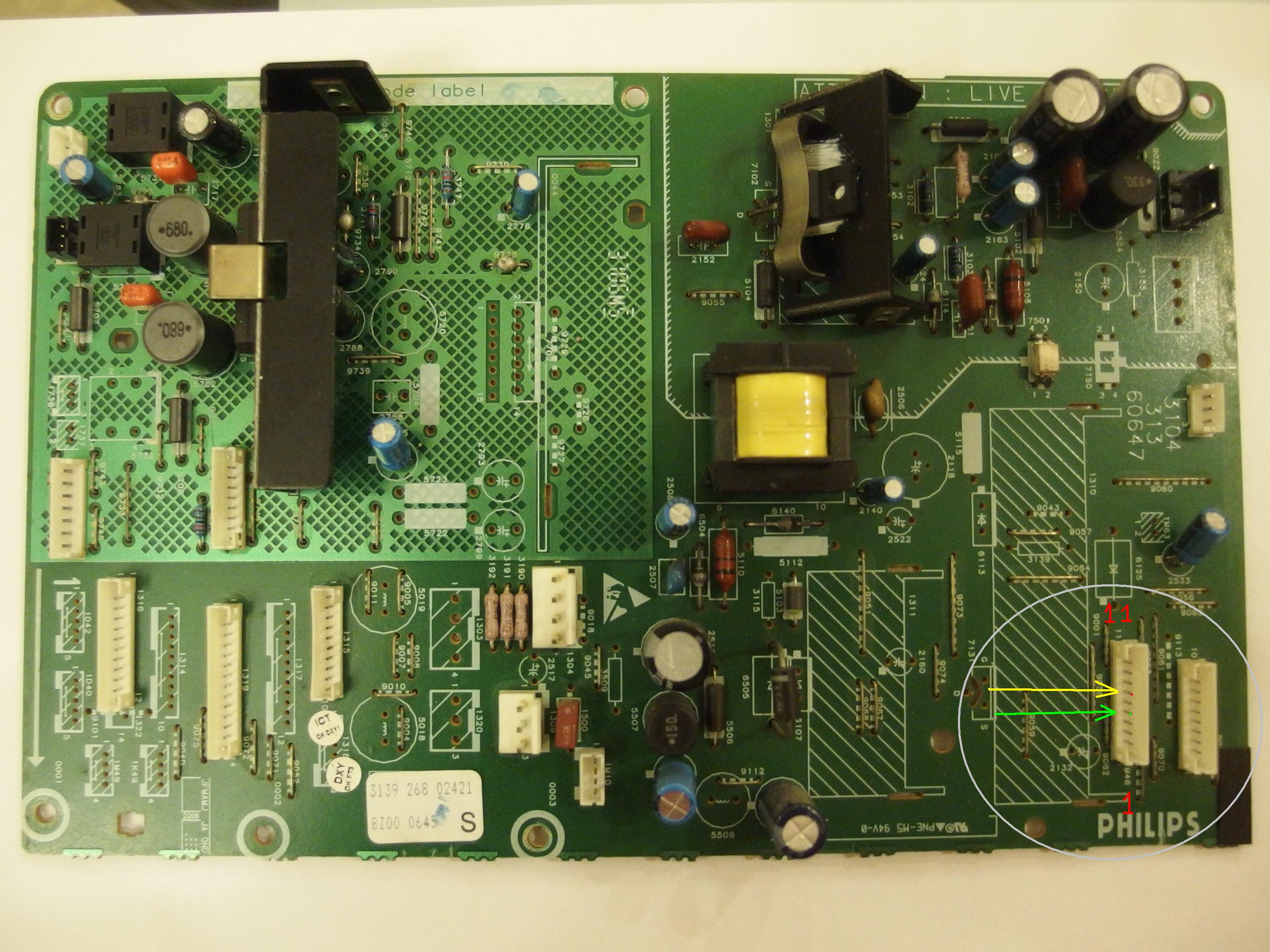

                It is tough to trace the standby board from the pictures
                But
                I think that pin 7 (yellow arrow) is 5 volts that leads to the main board
                See if that is there
                Then check pin 5 (green arrow) to see if that has 5 volts when the power button is on
                and see if it is zero v if the power button is in off mode or sleep mode

                      Yes, there is 5v when I connect neg probe of tester to black ground and pos probe to pin 7.
                      Pin 5 is 0v when I power up the tv from 240vAC house main. It is still 0v when power button is on.
                      It must be tough for you to trace the circuit remotely. And it is super tough to guide someone like me. I am so sorry.

                          yes, it is tough, but good practice especially on a board setup like this that I have not had the pleasure to run into yet.
                          Ok then, that 5volt must power to the main
                          there is also a 12v that goes to there once the rest of the cables are connected (I think that is pin 3)
                          I am almost positive that the 5v should be what is returned to turn on the rest of the power supply through this same plug.
                          Could you check the other pins on that 11 pin plug with power button off and then again with power button on to see if any pins happen to pop up as 5 from 0
                          you can do an external on the power supply, but the 3 pin wire that leads to the standby board should be disconnected when doing this.
                          Did you by chance replace the blown round red fuse ?

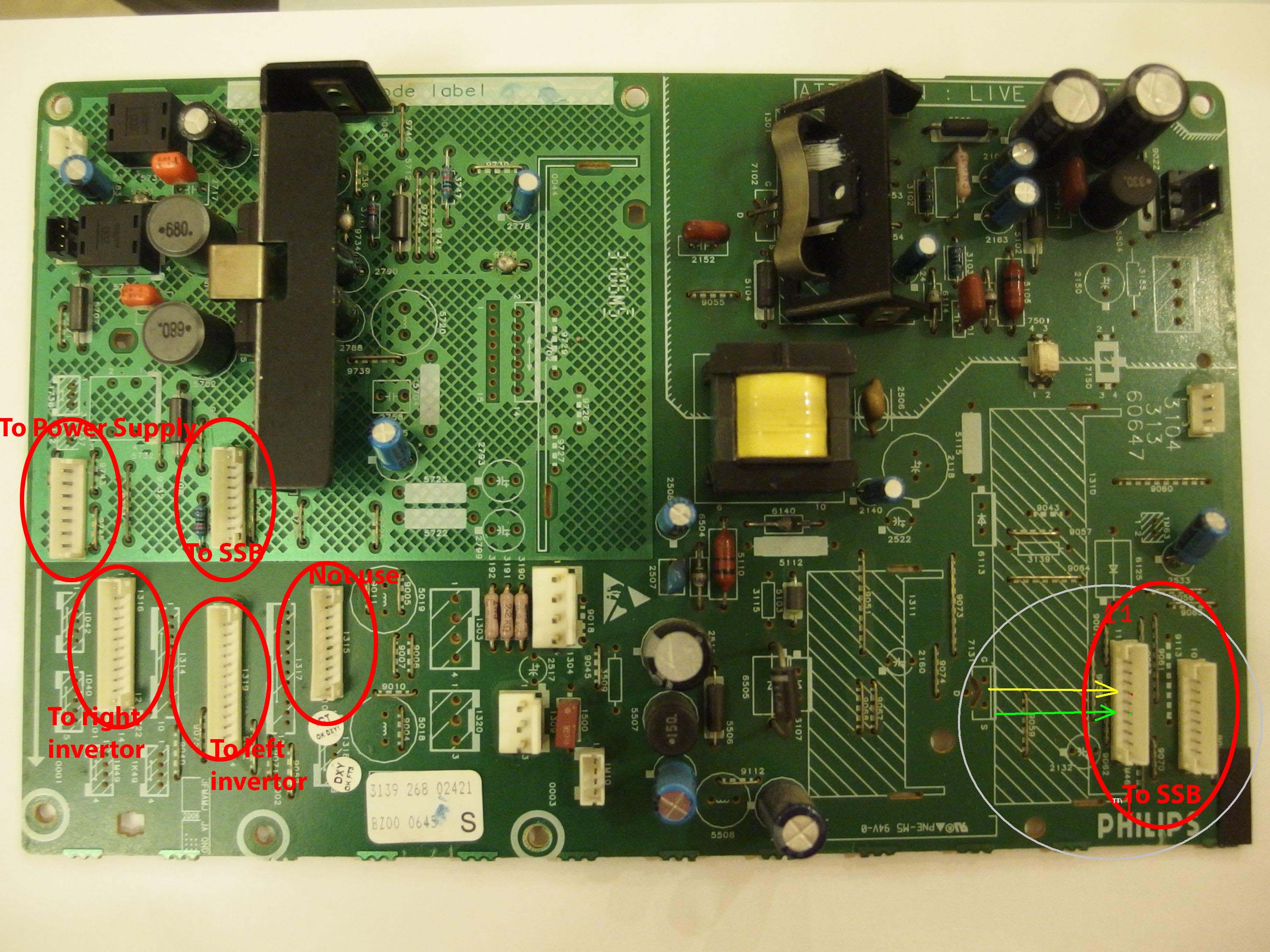

                                another question
                                next to that 11 pin plug is a 10 pin
                                does that connect to the main board too ? your overall picture doesn't really show that plug
                                if it does
                                the return pin might be on that sucker

                                    I thought 6 was a ground
                                    IF that 10pin connector has a wire to the main
                                    try testing those pins
                                    pin 8 might be a possibility

                                      The 11 pin connector connects to the SSB not the power supply board.
                                      I have circles all the connections on the standby board.
                                      The 7 pin on the standby board connects to 1M02 on the power supply board.

                                        Originally posted by bammbammfran View Post
                                        Does that damn relay still click when you first plug it in ??
                                        It shouldn't since you said you did not have power to it at the 3 pin plug
                                        maybe when you accidentally are shorting pin 7 . that is temporarily shutting down the 5 to the main and shutting the other power source to the relay
                                        another question
                                        if it does
                                        Yes, the relay still click when I plug power in. But I think it clicks on and then off as there is 0v on pin 2 of the relay, only pin 3 is 240v.

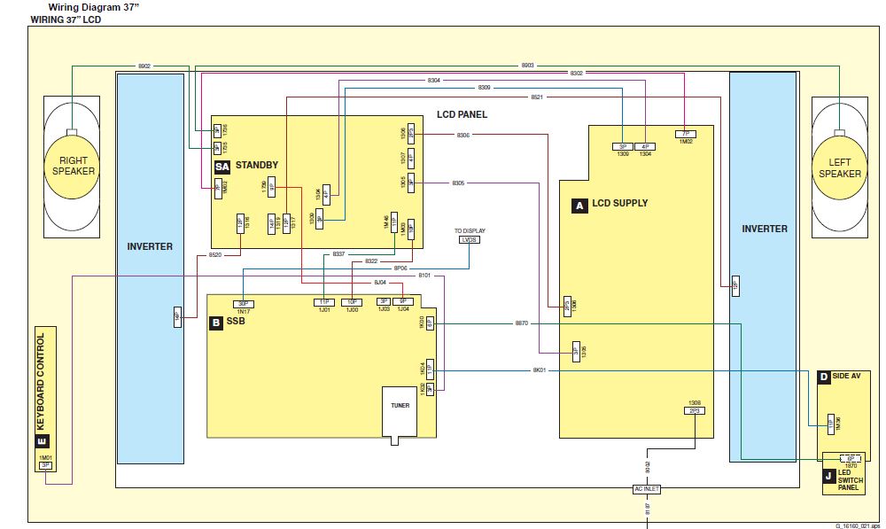

                                        The 11 pin and 10 pin connectors connect to the SSB board.
