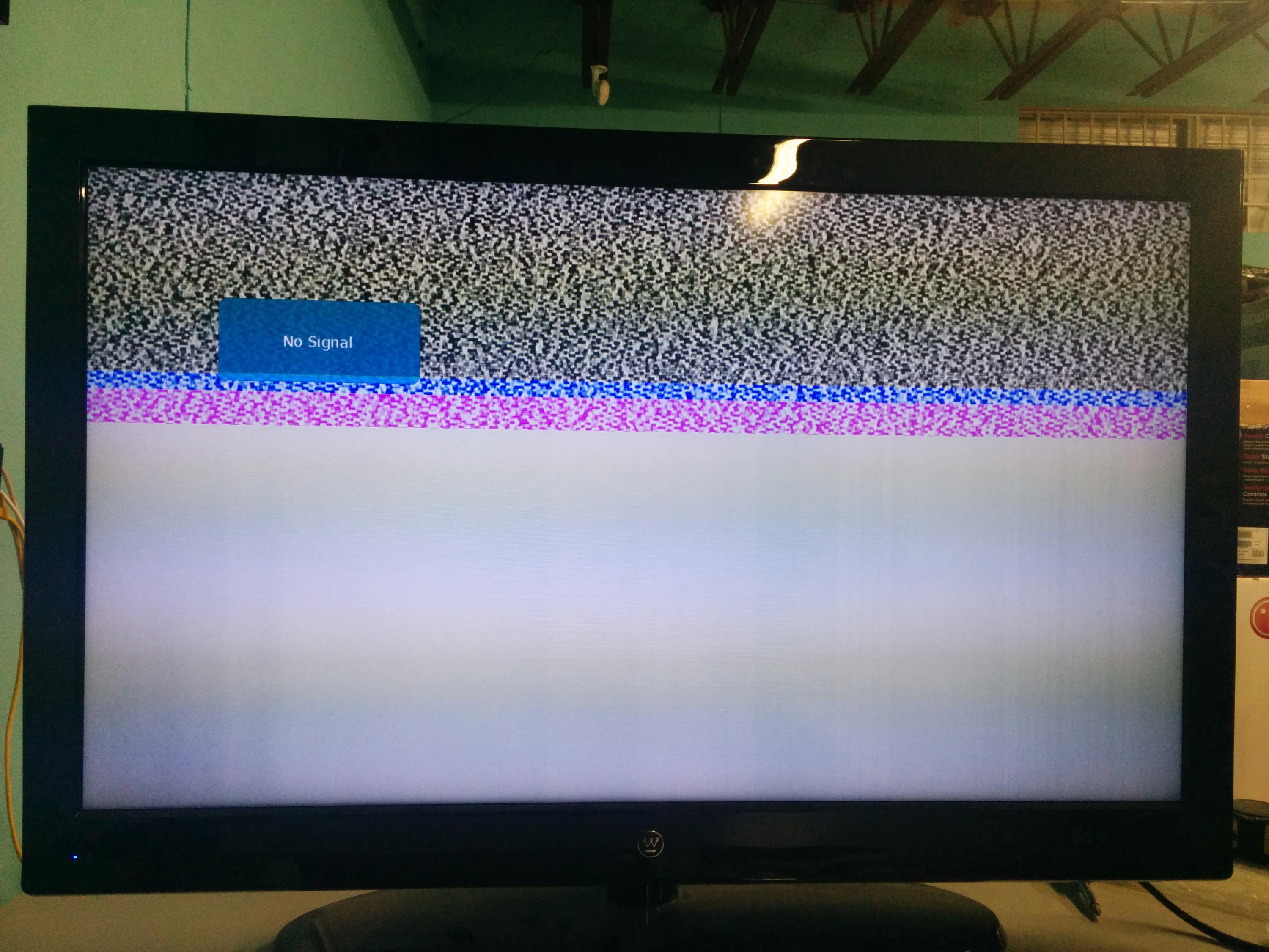

    Westinghouse 40" LCD
    Please see attached. Where would you start to troubleshoot this tv? As you can see about two thirds of the panel is white and top third is ok. Thanks.
  • Dgtech
    E. Technician
    • Apr 2009
    • 1462
    • Steeler
    Re: Westinghouse 40" LCD
    I'd replace the t conn board just to chance it first. But that's just me
    • bammbammfran
      • Apr 2014
      • 476
      Looks like a bad panel.
      It may have gotten smacked on the left or right side near where the picture disappears
      you would have to open it and look at the screen in this area to see if it has small plastic tabs affixed to the front glass. If it does, one of those probably is damaged
