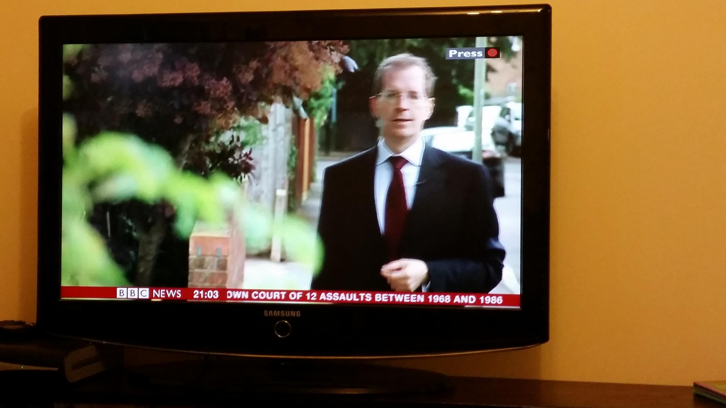

    Hi
    I have been given the above model of TV and upon testing there is a fault where the colour is "wrong" (looks too orange/red - like an old TV when you turned the colour control up) and when there is a caption, something like a news set where the background is static or the menu is selected the image of that is temporarily ghosted on the screen and fades over a few minutes.
    Any ideas if this is a simple fix where a component is dying/died or is it a skip job?

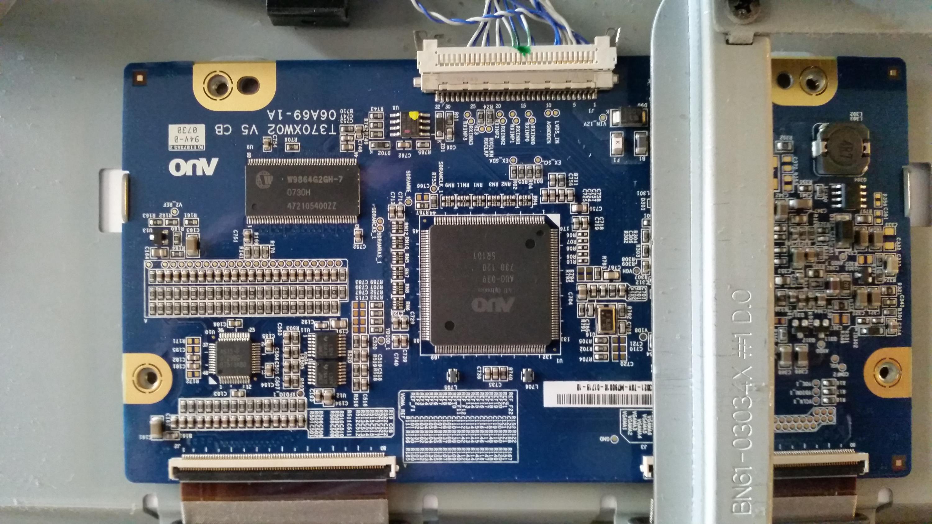

    Probably fixable - sounds like a "gamma chip" fault. Do you have a camera to take a picture of the set's boards?

      Re: Samsung LE37R87BD Poor Colour and Very Short Term Image Retention
      Yes I do, what in particular should I be photographing, or just all of it?
        A picture of the T-con board. If you're unsure on which board this is, take a photo of the whole set.

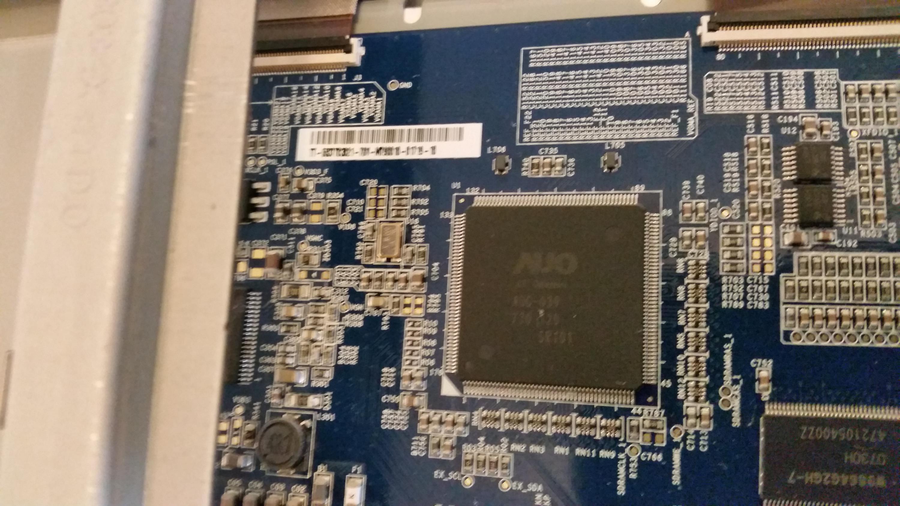

          Here you go.... believe this is the offending board
            Is it possible to get a shot under the wall bracket or to remove that bracket.
              Another bad AS15.
                Yes, that's the board.... 5537T03021 in the bar code label
                  Top left hand corner of board you'll see a bunch of test points marked VGAMA1 through VGAMA22.
                  Test the voltage on each of these points with a digital multimeter.
                  Use 20V range, red probe on each point, black probe on chassis.
                  Report your readings for each VGAMA point.
