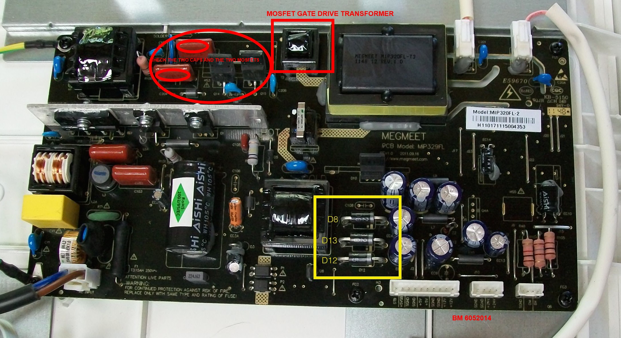

BTW, did you check those two caps that DGTECH suggested you to test in post 2?

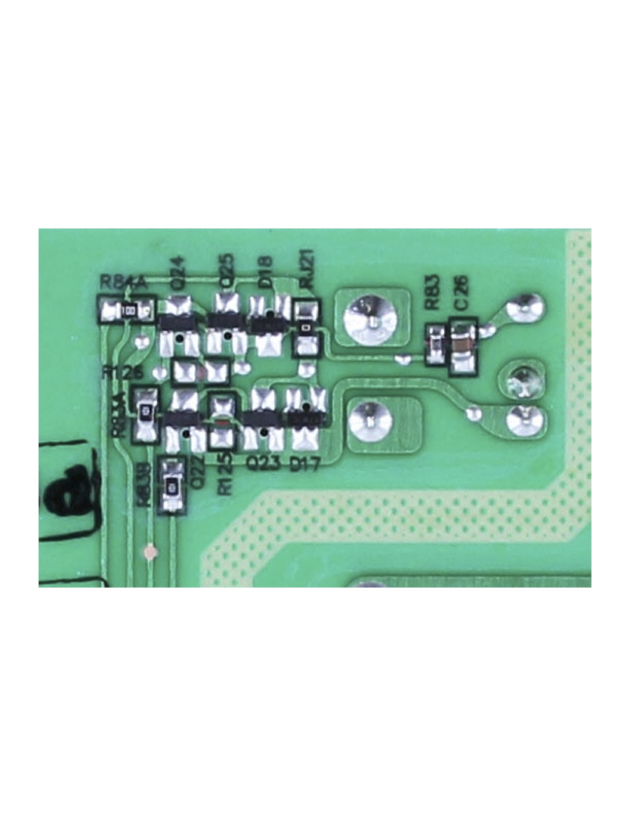

I think more likely that the MOSFETS are not getting the GATE Drive signals.
Re: Sceptre x322bv-hd powers up w/sound-but no picture
That section is for driving the GATE DRIVE TRANSFORMER, as you can seem they compliment with each other, there are three devices in each set, it is setup as a bridge drive to drive that transformer. So check all six of them.
not yet, not sure on how to test with my analog meter for capacitance.
I have an electronics store really close to me which I'm heading to so I will just pick up the 2 while I'm there & replace them.

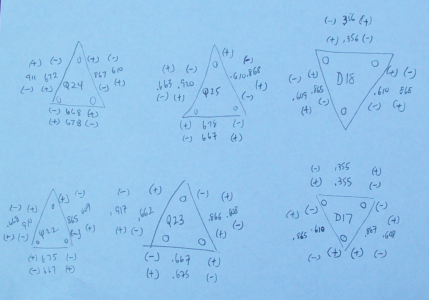

can these be checked in the circuit or do i need to pop them out to test

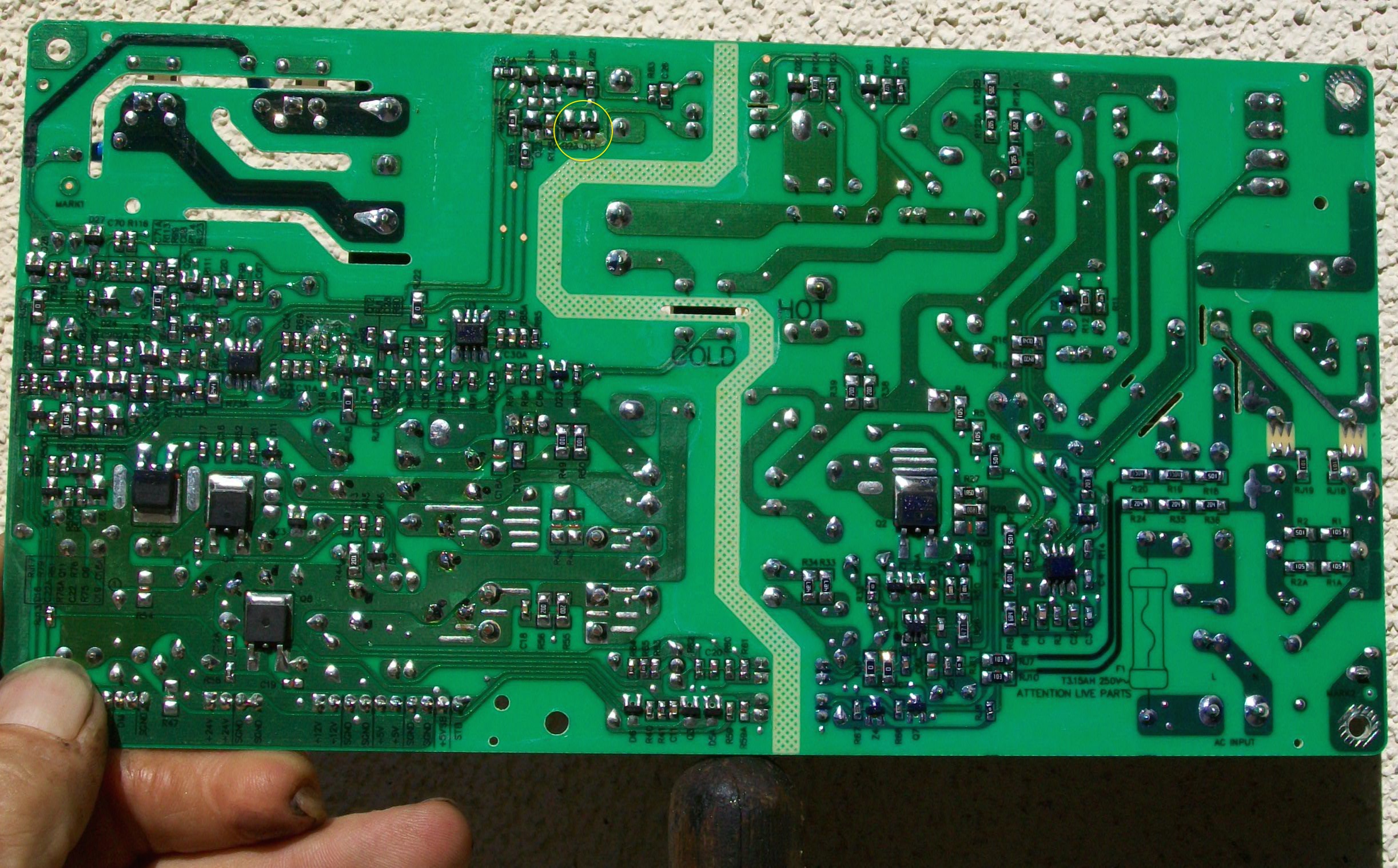

don't mean sound like a bozo, as this is all new to me , and i appreciate all you've done so far. Are you referring to the area that i circled in post 21? D17 & 18, Q22, 23, 24, 25

@ this point, it seems to be that there is no drive signal top drive the Gate of the MOSFET to turn it on and off, the MOSFETs then drive the high voltage transformer.
I have seen this board in the badcaps forums, so you are not the only one with the problem. Having the scope to probe some points on the board may lead to some indication as to where the problem is.
The SJ board does not have the same layout on the bottom side as your board. It has only three semi devices instead of 6 for driving the Gate drive transformer. http://www.shopjimmy.com/megmeet-mip...t-inverter.htm
So may be some improvement are made to the board.

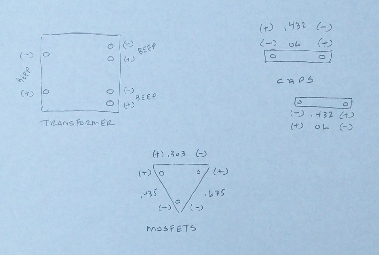

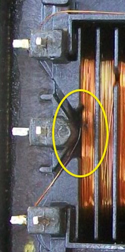

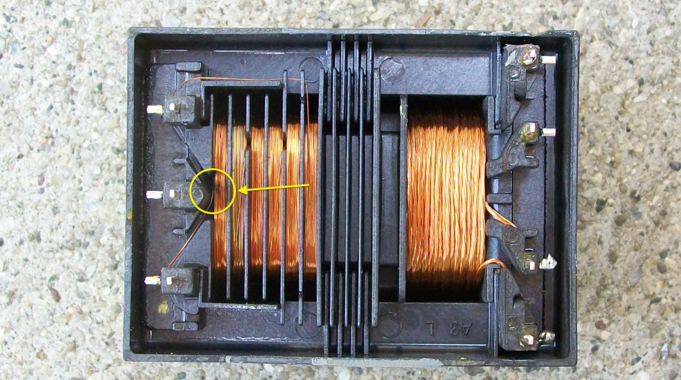

I decided to pop off the big transformer (the one w/ yellow tape around it) and have a looky. Something caught my eye that seemed odd. One of the wires running to its lead on the output side appeared to be slightly burned.
When I put my meter across the 2 input leads i got a beep. when i put them across the 2 output leads i got nothing.
Im not sure how to test a transformer , so i decided to do the same with another transformer i had lying around. I got beeps from both sides on that one. I put up some pics. it was hard to take a pic as i could almost not see it w/ my magnifying glass.
Thoughts?
