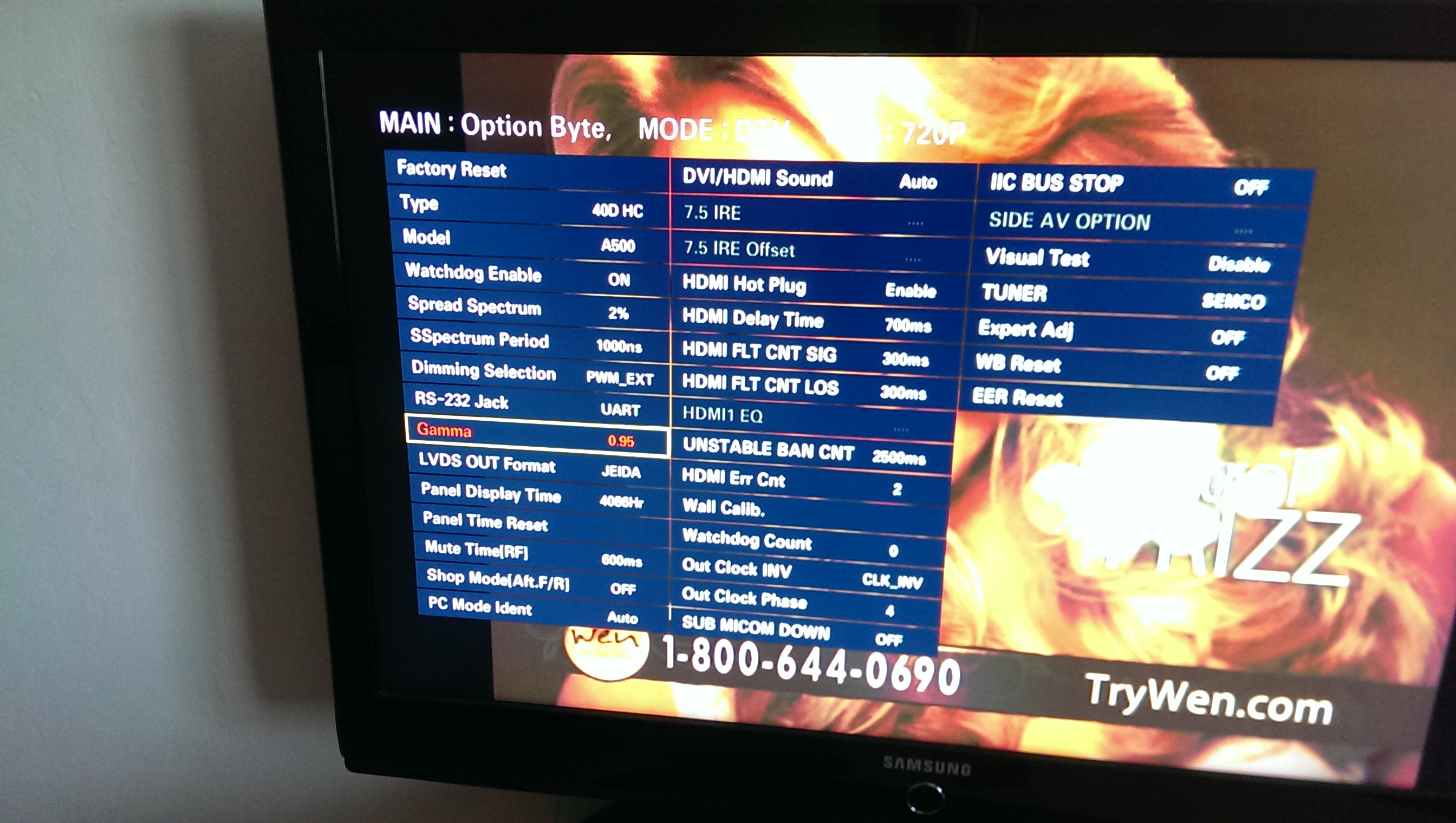

    About 6 months ago the colors on my Samsung LN40A500T1FXZA suddenly became inaccurate (see attached photo). I did a factory reset, and swapped out the logic board (or what I think is the logic board – it has the coax and HDMI connectors built in) as I had a spare (I broke the RF connector off my original board). Neither of these changes had any effect. I was able to make the picture tolerable by going into the service menu and changing “gamma” from default (1.0 I think?) to 0.85 (see second picture) and changing the normal picture controls.

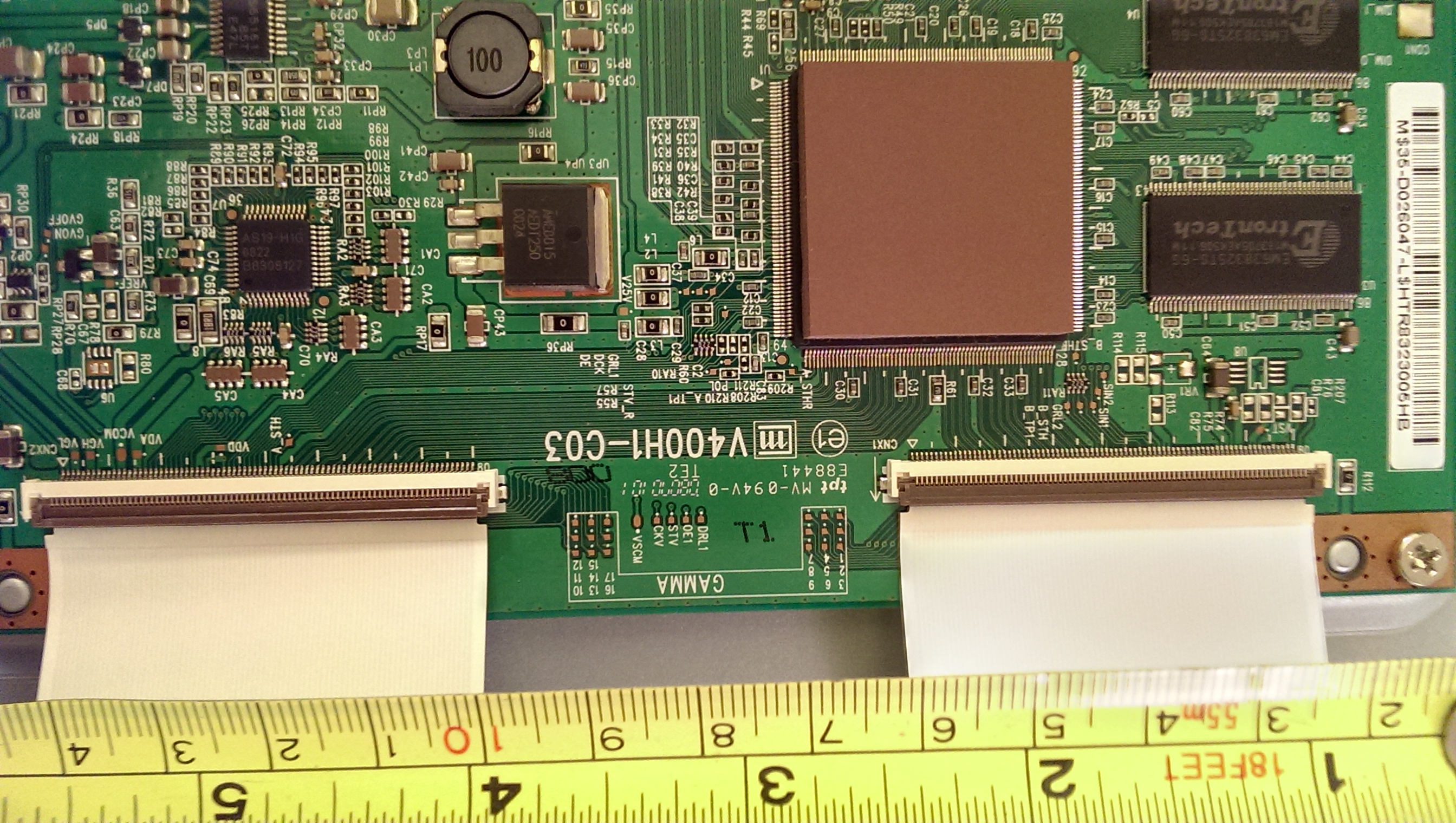

    I have decided I would like to fix the TV. After reading some posts on this site, I think I need a new T-CON board or gamma IC. My gamma values are:

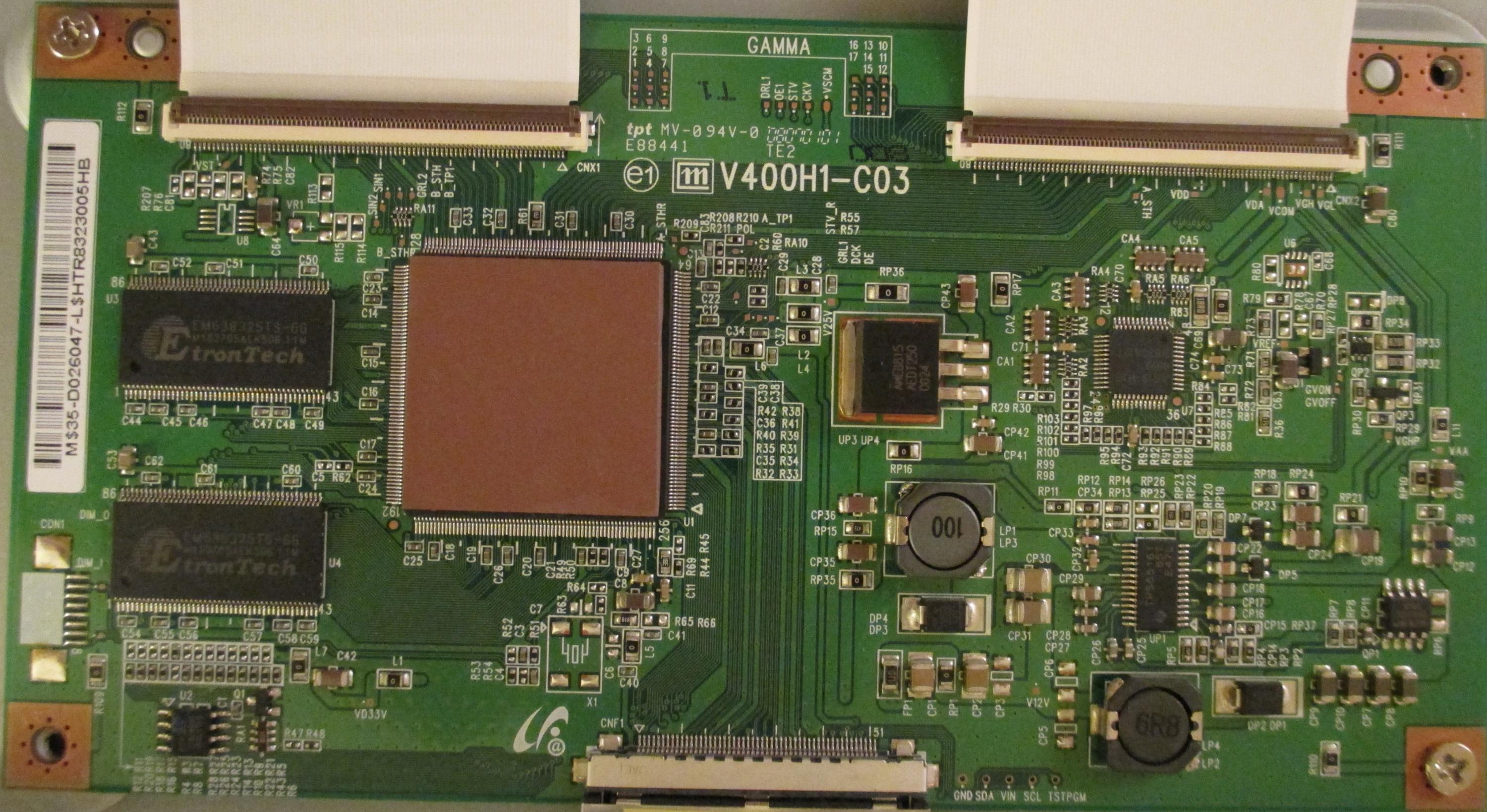

    Do you think my gamma IC is bad? If so, can you recommend a supplier for the gamma IC (AS19-H1G 0822 B8308?27), or preferably the whole T-CON board. I do not think my soldering skills are up to replacing the gamma IC, so I would prefer to replace the whole board unless the cost is prohibitive.
    I have also attached two pictures of my T-CON board.

    Re: Samsung LN40A500 color (gamma?) problem / errors
    Yes, it is bad. AS19 can b found on EBAY, but removing it and installing it will need SMD tools.
    You can check shopjimmy.com for the replacement T-CON.
      Shopjimmy.com did not stock my T-CON board, but I found a compatible one on ebay. I installed it and everything seems to be working normally so far.
      Thanks for your help!
