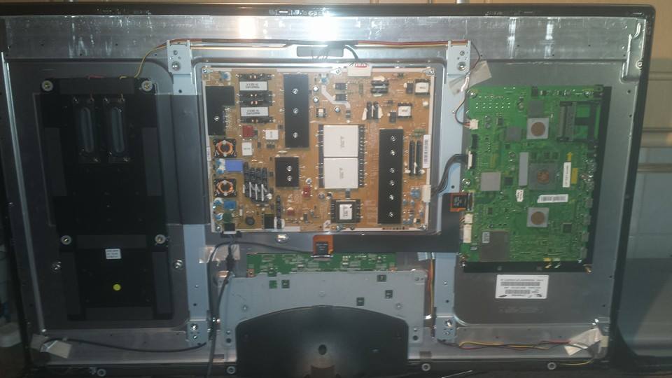

    ok my friend bought this tv round today and asked me to have a look at it he bought it off a guy on facebook it looks to me that the tcon is faulty due to the images some times goes solarized but it may also be the panel so looking for more advice please

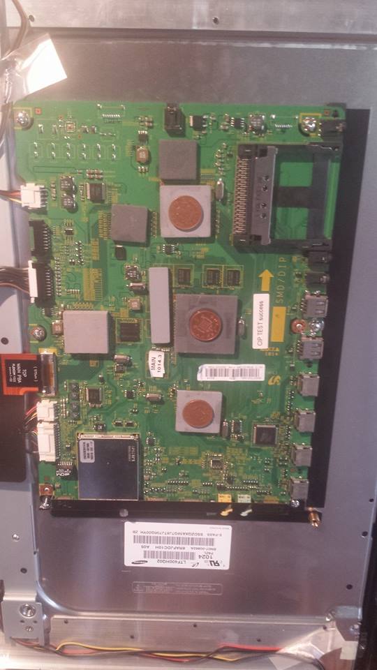

    p.s also when i took off the back cover ive noticed that someone has glued on 3 one pence pieces to the main board any ideas why ?
    thanks

    probably the soldering under the chips has gone and hes tried to aid cooling the adding the copper well thats my guess.

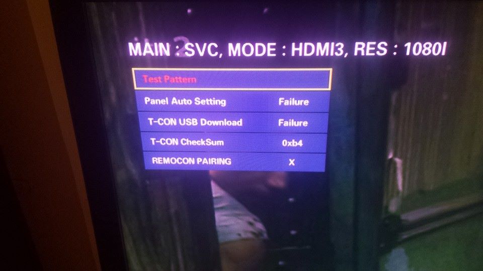

          Hmm, unlikely to be panel going by what it looks like. Have you checked the LVDS cable is properly seated both ends, no damage, bent/burnt pins, etc.?
          Access service menu: from standby press: Info Menu Mute Power on remote, then when service menu pops up, select SVC, then select Test Patterns. See what, if any, difference there is between GENOA-P and NAPOLI patterns, and if there are other generators present check them too.
          GENOA-P fault only: Main board pattern generator. Fault on main board or LVDS cable or T-con (T-con is unlikely but cannot be 100% ruled out.)
          GENOA-P & NAPOLI fault: T-con board pattern generator. Fault on T-con board.

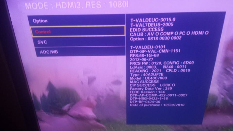

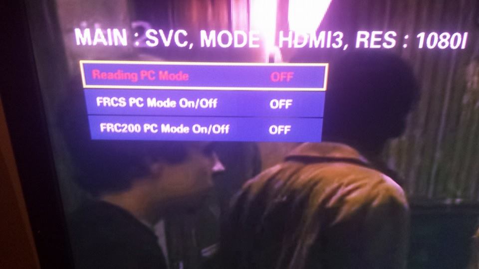

            im checking the lvds cable now tom ive uploaded some pictures to show you that when i enter test pattern thats the only options im getting in service mode
              Re: Samsung ue40c7000
              Do you have options under CONTROL or CTRL? I am going by the US service guide, I don't have the UK one for this model.
                picture uploaded
                  You have to press "OK" to select Control option.
                  According to the EU service manual you should have FBE Pattern Sel, and Logic Pattern Sel. http://elektrotanya.com/?q=showresul...oria=&kat2=all
                  Try selecting "Panel Auto Setting" and pressing OK, I think the panel options may be wrong. Also try a Factory Reset.
                    yes tom i know selected the control option then you see the following
                    EDID
                    SUB OPTION
                    HOTEL OPTION
                    SHOP OPTION
                    SOUND
                    CONFIG OPTION

                          Since the behaviour in the service menu is different to the service manual, someone has been fiddling with this TV more than adding pennies to the chips (seriously, who thinks that's a good repair technique?!)
                          I think I see a Samsung panel sticker. What is the Panel Option under "Option" on the service menu? It should be AMLCD or SAMSUNG and the INCH OPTION should also match.
                          Did you try the "Panel Auto Setting" option?

                            PANEL TYPE 40A2UF7E
                            LOCAL SET EU_AII
                            MODEL UC7000
                            TUNER SEC_T2
                            FRNT COLOR T-M-BRN
                            and if i try the panel auto setting it goes to wait then quickly back to failure
