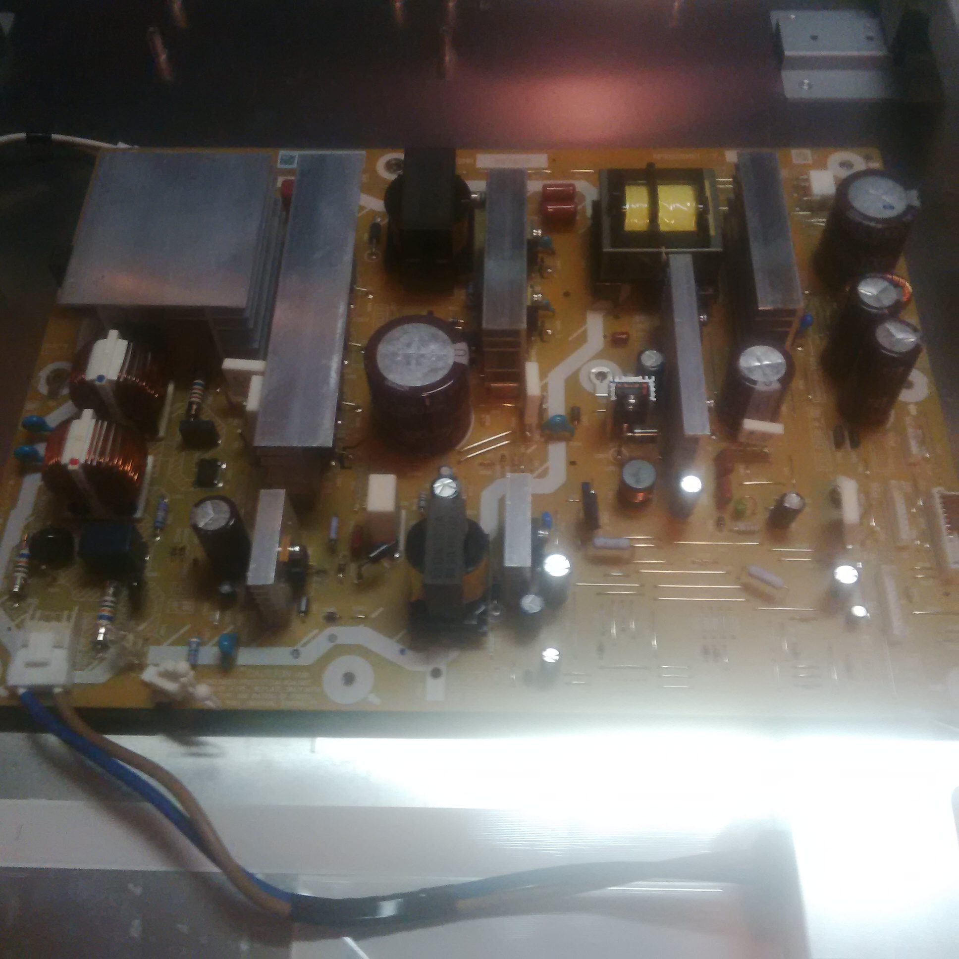

    I got a Panny 54" tv. The P board is faulty. I'm getting 4 blink code. The guy thought he could fix it. He bought a P board from myshoptvs, whom I've never heard of. Says ok on the board. I know it's not ok. I'm getting 85v on a heat sink. Ya it hurt. Should a source on a mosfet be shorted to the heatsink? I'm thinking not since I get 85v from the heatsink to ground. The part of the P board is ETX2MM807ASH. The part number on the mosfet is MIP3E5MY. Man my finger hurts.

    Getting voltage on primary heatsinks is normal.
    4 blinks is typically an SC or SS board fault on these - isolate the SC and SS board. If you get a 6, 7 or 8 blink code you know it is an SC or SS fault.

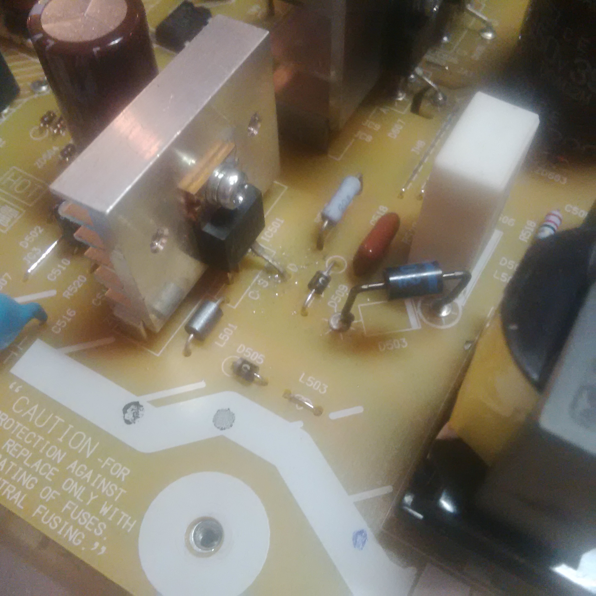

      Well I'll be. I finally got voltage on P2 and P11. I hooked up P35 a and P6 and I get a steady voltage out. I have been testing it with just P7 hooked up. Apparently I can't do that.
      What would cause the voltage to turn off after a few seconds with the SN and SC boards disconnected? A fail safe? I did power it up with everything on and the SC board smoked.

        It will power off with SC (or SN) / SS out because of the SOS6-7-8 trip. With no power the boards will fire off a few error codes causing your problem.
