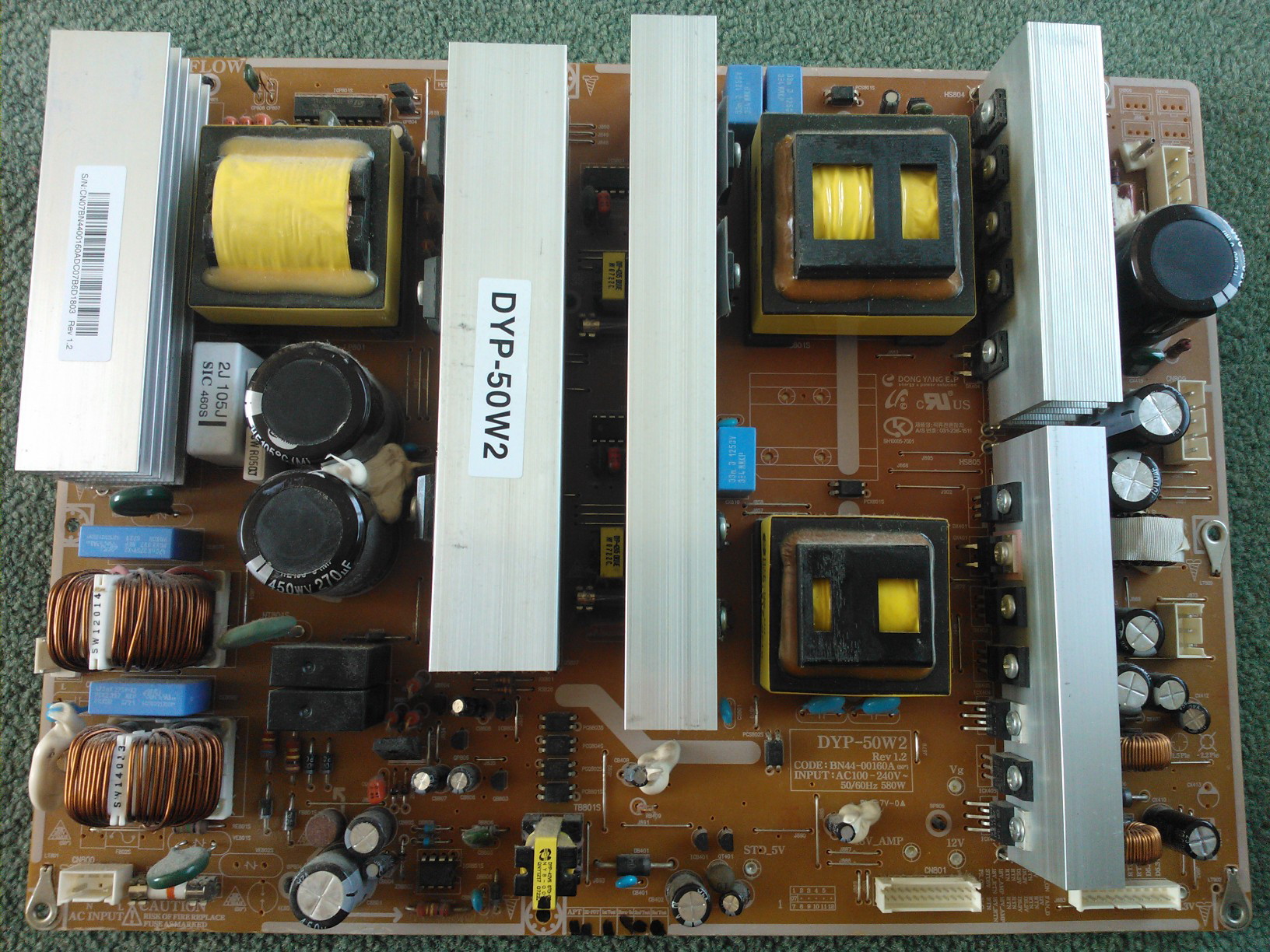

                        Here it is, the offending beast!!

                            Re: Samsung plasma DEAD......
                            Hmm--That looks to have had a hard life....
                            --Maybe on most of the day--everyday in an over centrally-heated house, by the looks of the board discolouration!
                            The plugs are marked. Check the STBY 5V at the double-row socket bottom left of the board.
                              No voltage present, do you know what diode zd8803 is spec wise or is there a schematic that i can look at on the web site as a pdf type thing......, I.m going to replace al caps as they are well know for a bad manufacture used by samsung.....
                                  Aye--Replacing all the caps on spec is pointless--Unless you can confirm they are bad, and probably cost more than a working supply!
                                  Only ones worth doing are the two or three associated with the STBY 5v supply, as they are cheap enough--and always 'on'
                                  --To replace much more is a waste of effort and money at this stage.
                                    There is a GOD...... I've just had a final look before taking to tip tomorrow and like you said Graham as I have read on other sites, shorted out PS-ON & rtn pin next door and 2 quick clicks from relays, then a click as short released..... plugged all the leads back in to p.s.u.............. shove the mains lead in and click click and T.V is on.... all the menus work and no unusual looking lines or anything, just need to get a aerial lead up its back side and hopefully its a good one........ Maybe the relays just needed a good short....
