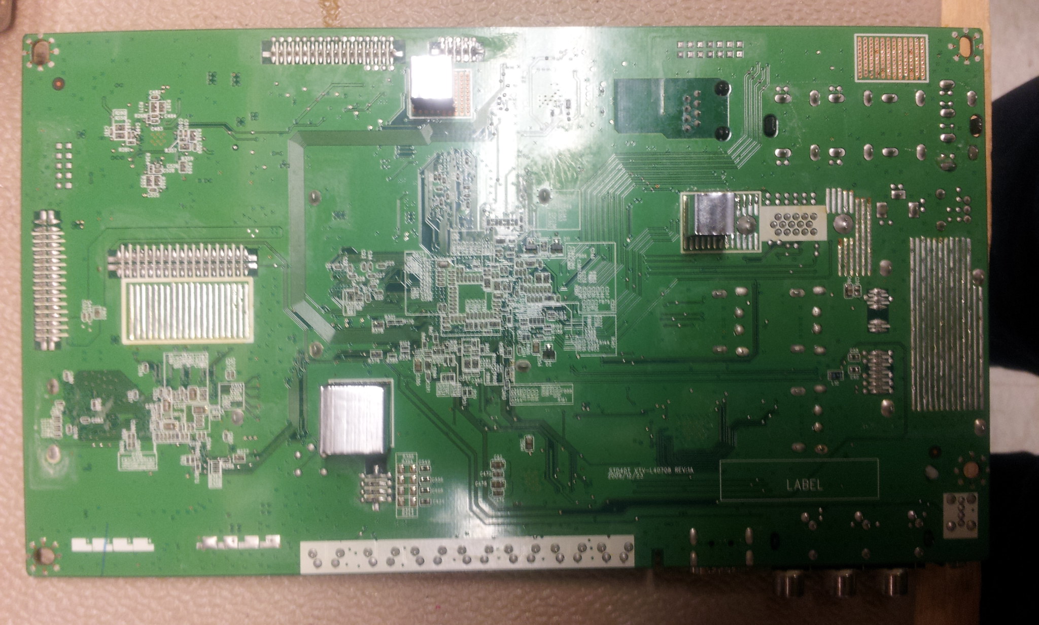

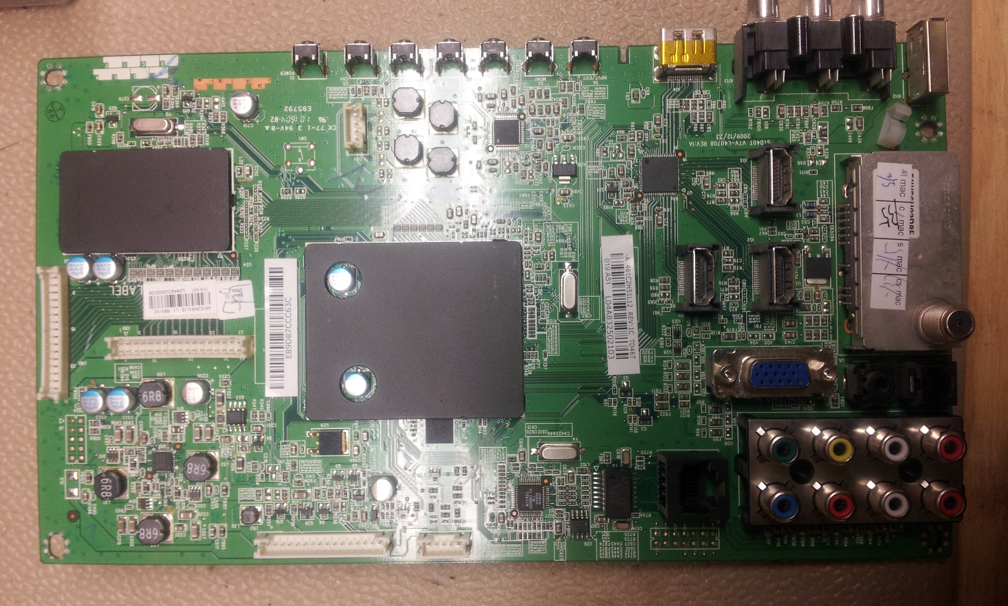

    LCD tv power supply turns on as soon as its plugged in to ac power. Has 5vdc
    standby, 24vdc to inverters and 12 vdc to main board. The Power command to the PS is constant 3.45vdc, button does not turn it on or off. The Inverter command is .47. I can make the inverter turn on and then substitute a dim command and I can vary the backlight brightness.
    Basicly the main board is shot. no control of P.S. on/off, not turning back light on, does not give a dim command. No Menu can be seen when jumpering on the backlight and dim control. Backlight works fine.
    The main board is a 461C2H51L12 Rev.1C. I could not find a new or used replacement. I found a troubleshooting guide (not much help) but no service manual or schematic. I checked the SMD transistors associated with pins
    13 power on and pin 16 inverter. They checked good. Ayny Ideas? Pointers?

      Power supply can be turned on, backlights can be turned on and dimming controls all work is jumpered simulating the commnans from the main board. #13 is Power on and
      16 is the backlight on command and I think 14 or 15 is the Dim command 4.5vdc makes the screen bright. I know the PS and inverters are fine. I can turn on the tv simulate a dim cmd 4.5vdc to make back light bright. The main board does not give any sighns of life on screen. No OSD no audio when supplying audio through HDMI switching throught the inputs. Disconnecting the T-Con did not change anything.

          Most main boards are expensive to buy new and even used. The voltage regulators are good as are the caps, and SMD transistors. hard for sure with no schematic
