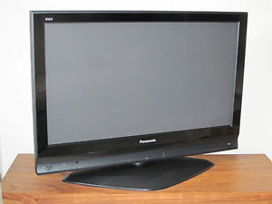

    i have a panasonic the green light flashes over and over then goes constant after a minute the x sus and y sus light come on why its flashing then when it goes constant it goes off
  • adamp91gvm
    • Jan 2014
    • 699
    • uk
    Re: panasonic tx37px70ba
    13 blinks i have
      Check the service manual for the 13 blink cause.
      • adamp91gvm
        • Jan 2014
        • 699
        • uk
        i have and i have found a post about 13 blinks so got the heat gun out wish me luck
        • adamp91gvm
          • Jan 2014
          • 699
          • uk
          no joy
            To repair a TV, or anything, try to break down the problem.
            - What does 13 blinks code for? Check the manual.
            - Check the causes of this 13 blinks if available - for example if it says A Board+3.3V down check the 3.3V, if it is not present then trace back.
            - Don't just randomly try stuff or shotgun replace parts - you'll spend money, waste time, and learn nothing.
            Even if you did "fix" the TV with the heatgun, I would hope you would not return it to a customer, or sell it like that. It is very likely just to die in a couple of weeks. With a BGA, a proper reflow technique, and ideally a full reball, is really necessary.
