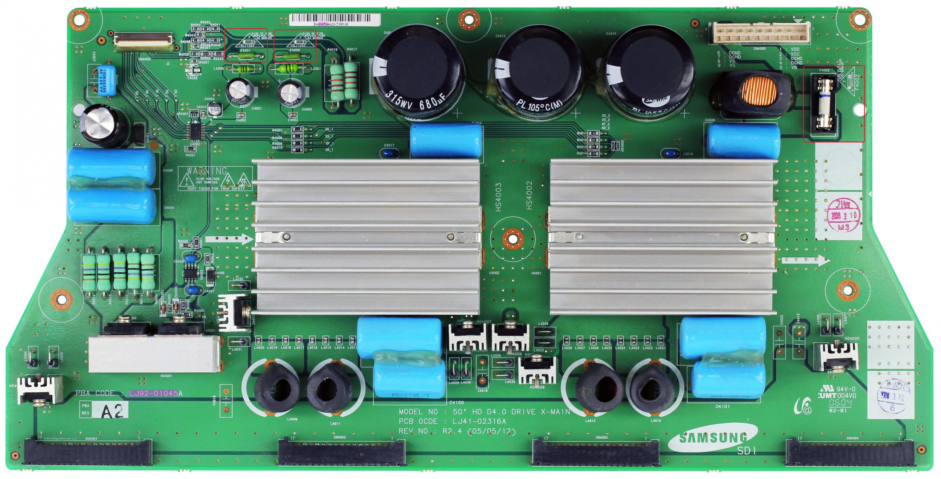

    Looks like failed XMAIN. If it's the same as below, Shopjimmy has them cheap at $24. You could start checking all the vltages are present and correct, maybe check the fuses and also see if any of transistors, didoes and IPM modules have shorted. I think there was one not too long a go that just needed a fuse replaced but at $24, I would not bother trying board repair with IPMs.
    It was this post but it has the next generation of panel and boards but ou may be lucky it's just a fuse otherwise I would replace the Xmain

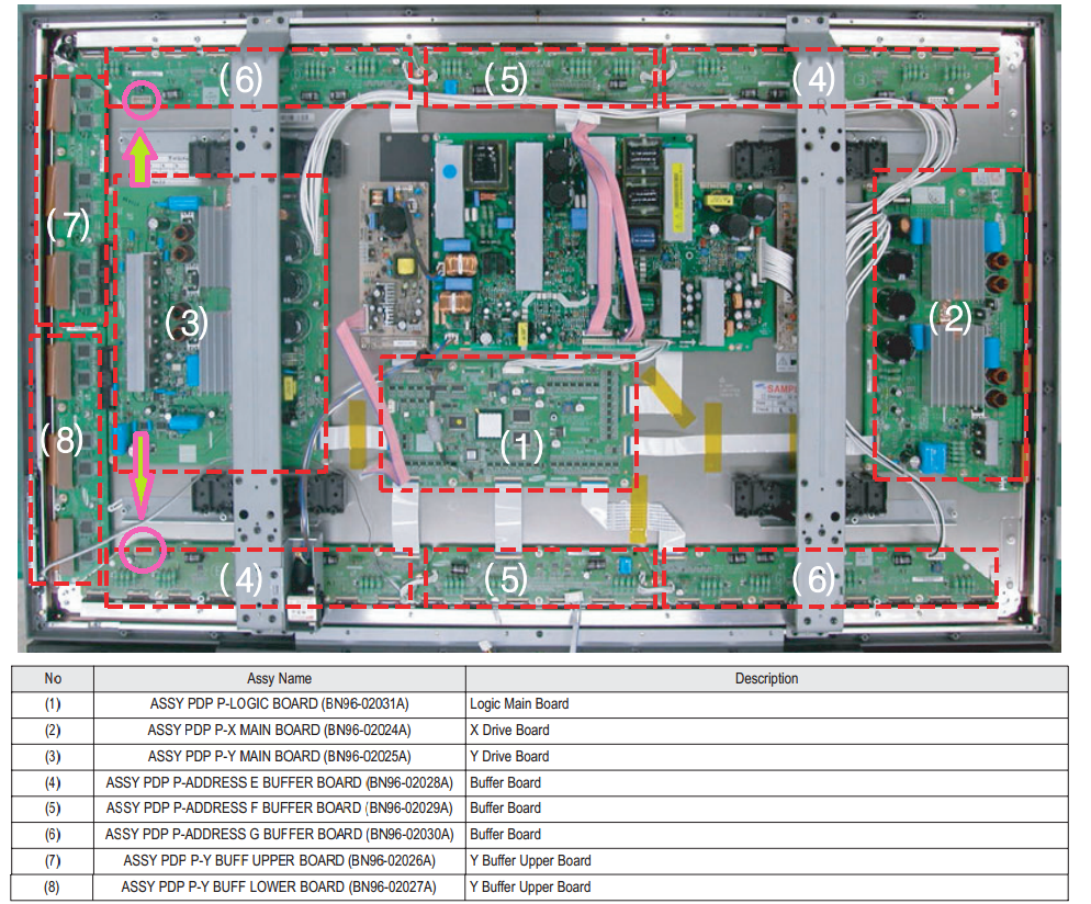

            Tried replacing X-MAIN and still having problem. Something strange I noticed is that there are two unused power-ports, circled in PINK attached image. Not sure if they are supposed to be connected to something, I can't find a definitive answer... While TV was open I looked at all caps, none looks bulged and all fuses looked intact. Tried to take a picture or two but they were blurry because of bad lighting
