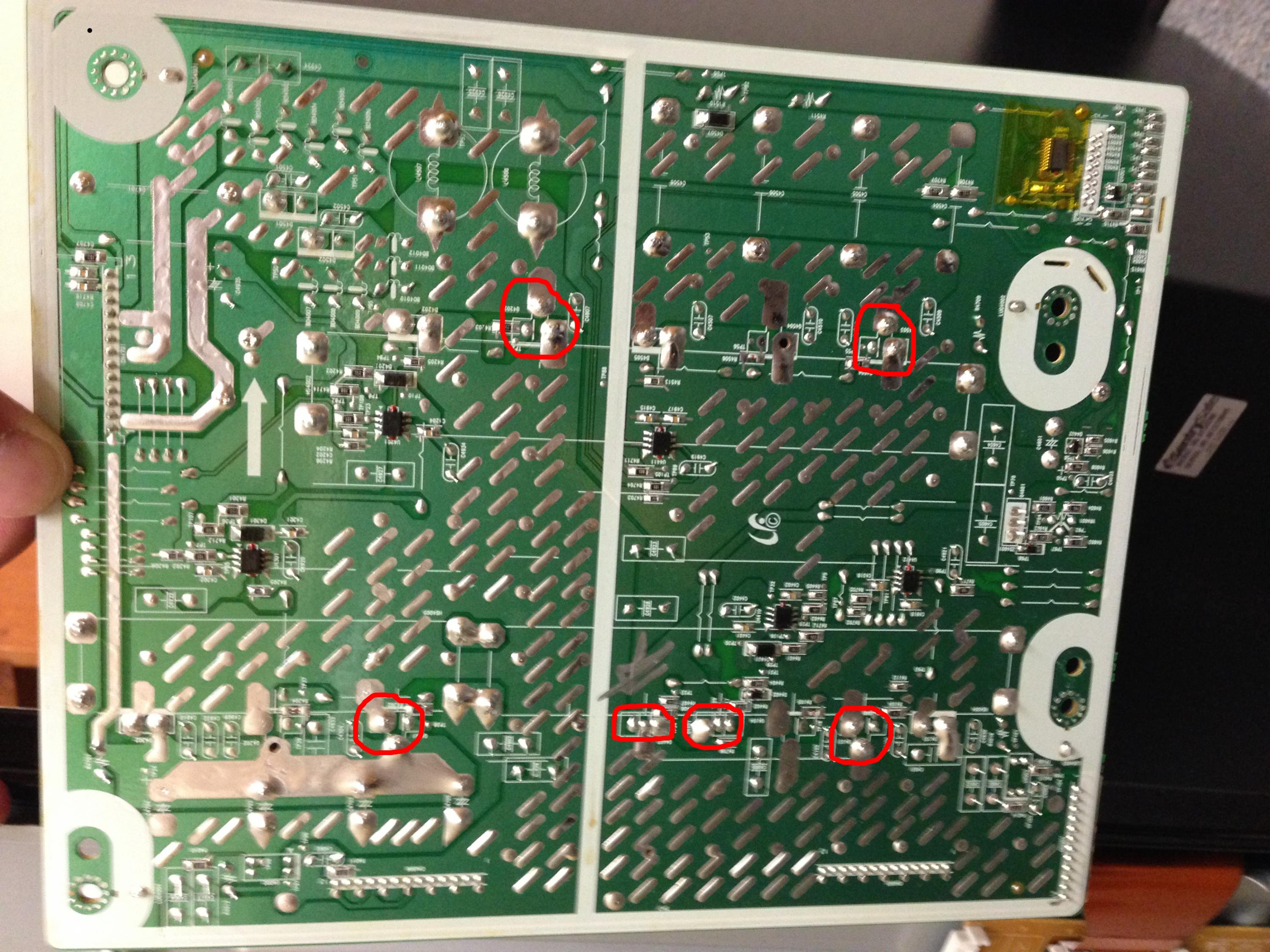

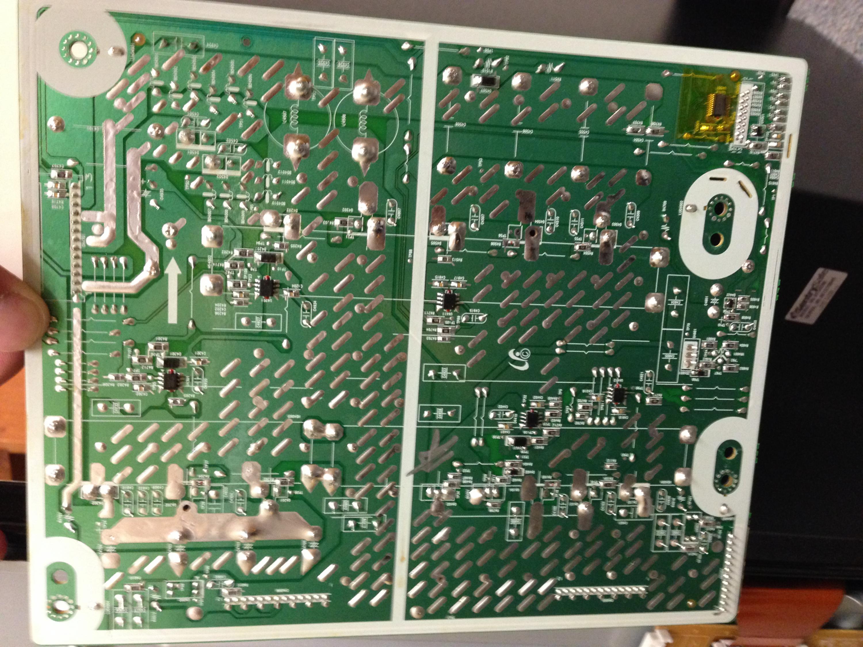

    Could you remove the X-main board and take a couple pics of the bottom, green side of the board.
      I've attached a pic of the bottom of the X-Main
        Re: Samsung PN51D550C1F - Clicking...HELP!!!
        OK, see picture.
        Set multimeter to diode mode. This is marked with a diode symbol -:>|-
        For each circled device:-
        Mentally number the pins 1-3. Order isn't important.
        Put your red probe on pin 1, black on pin 2. Note reading.
        Repeat for pin sets 1-3 and 2-3.
        Any readings that test below 100 are a sign of a bad device - make a note of any.
        If no bad readings are fine you should be good to go on replacing Y-main only and fix your TV for $40.
        After doing this, make sure to download Samsung firmware update from the Samsung website, you will need a USB stick to install it. There is a tech bulletin about a firmware bug on the control board damaging the sustain boards (X- and Y-main.) Installing the update should prevent repeat failure.

          When doing pins 2-3 on certain diodes, I would get a reading of 1. I'm prettying sure I followed your instructions correctly. Would that mean the board is bad?
            Is that "1" the same reading your meter gives when the probes aren't touching? If so, that's fine.

              Yes, it's the same reading I get when the probes aren't touching.
                OK, if that's all you got, you should be good to go on just getting that Y-main replaced.
