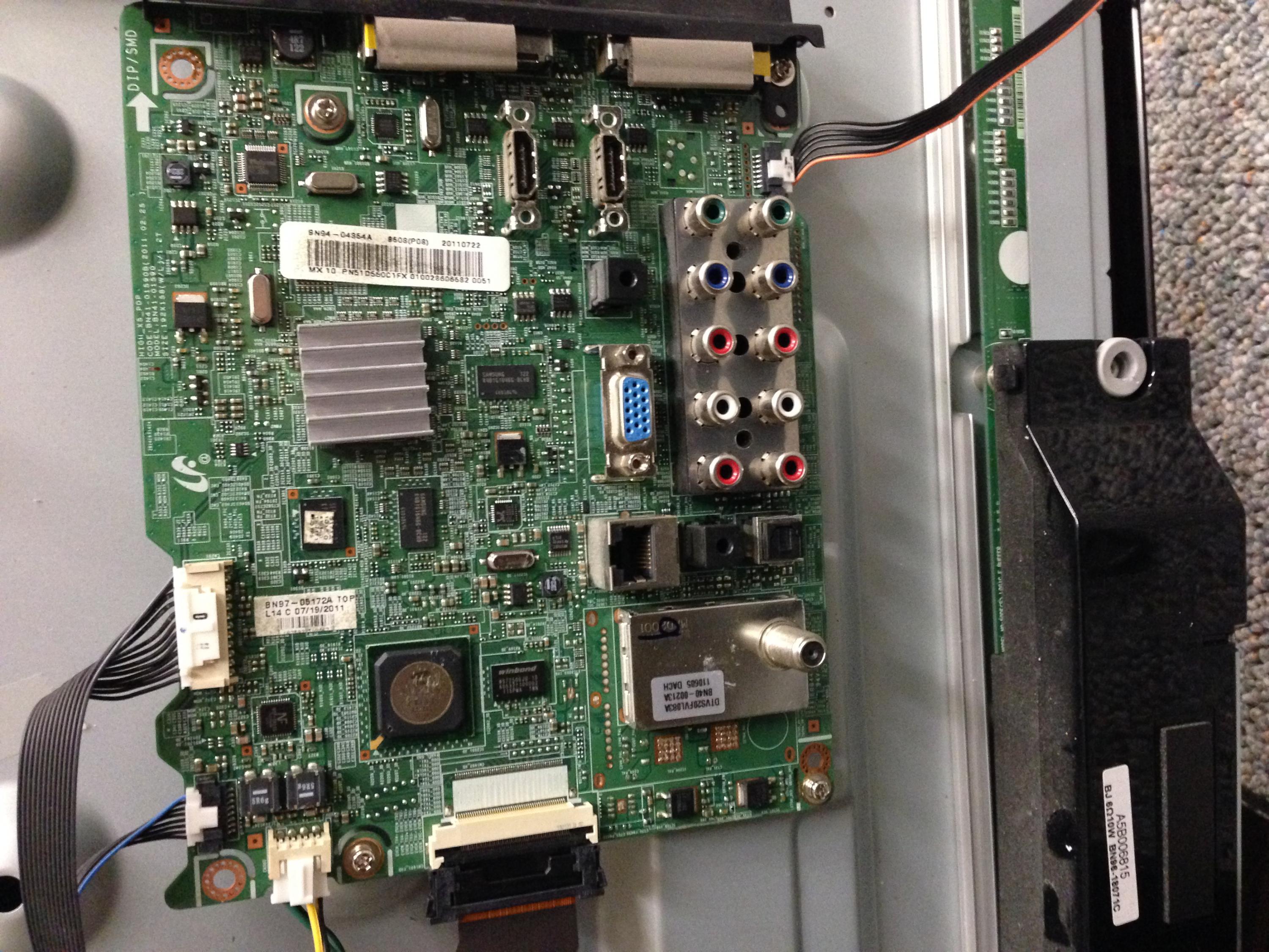

    A good first step would bee to post pictures of the boards inside the TV so we can see what we're dealing with.

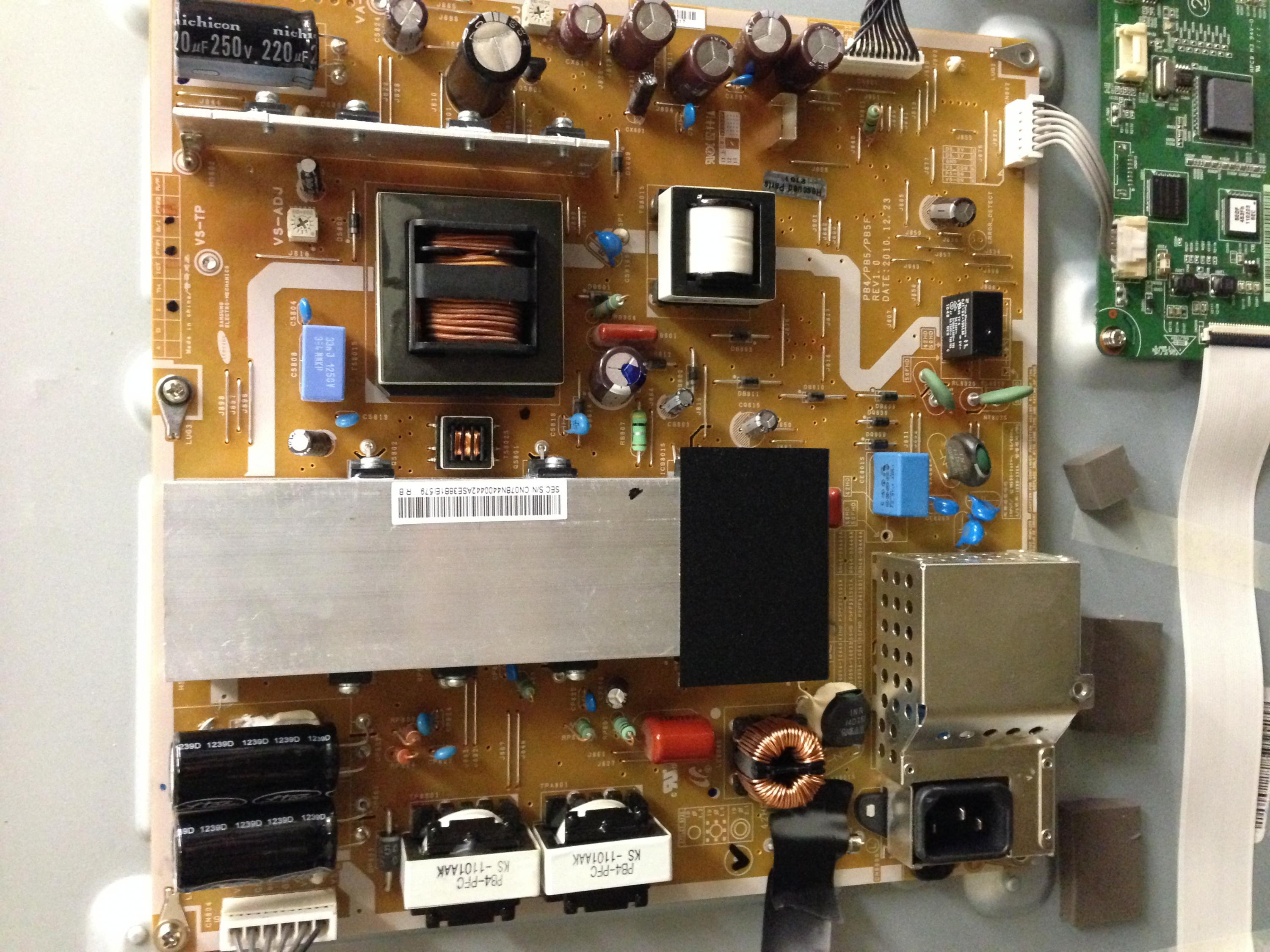

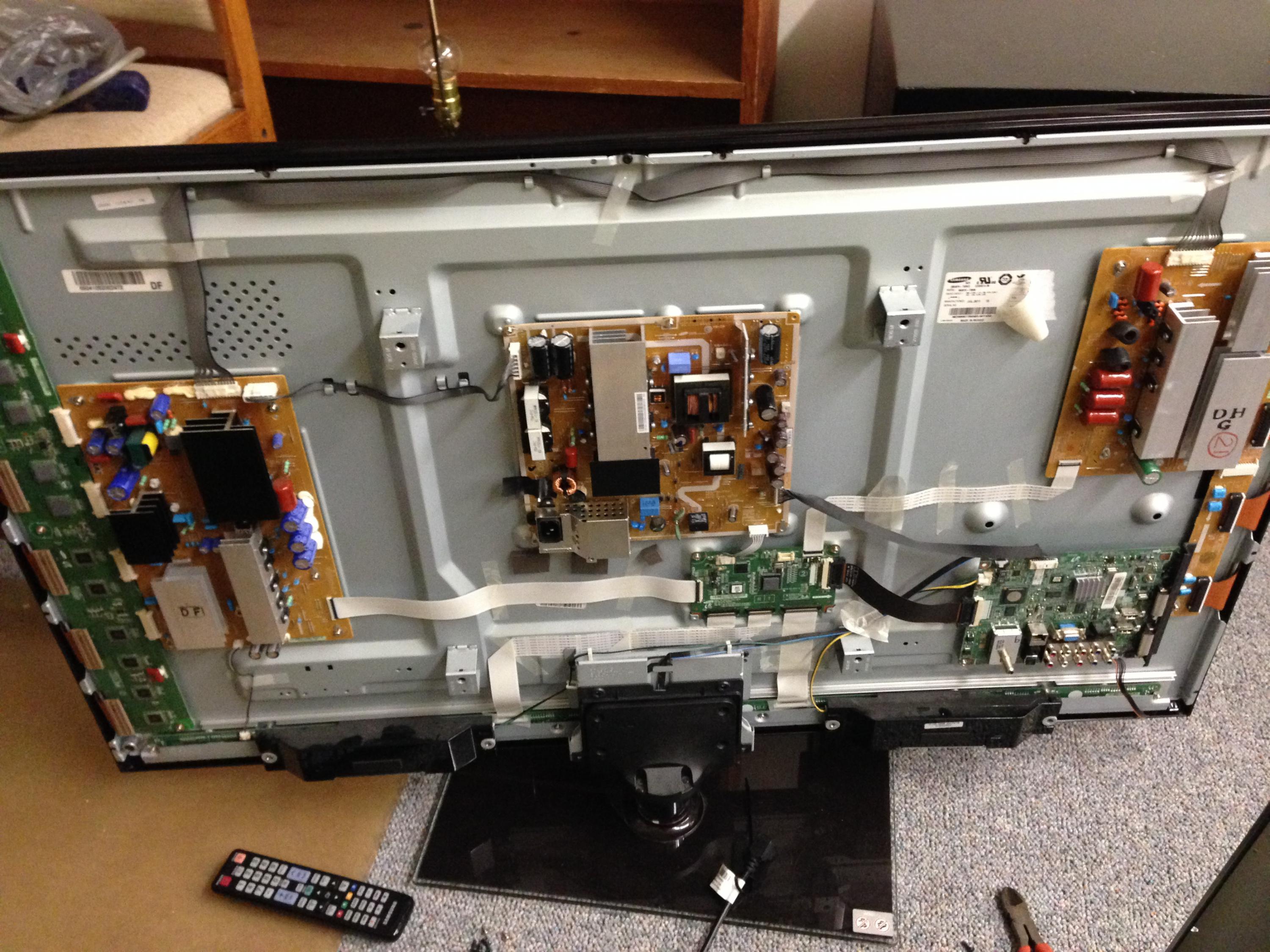

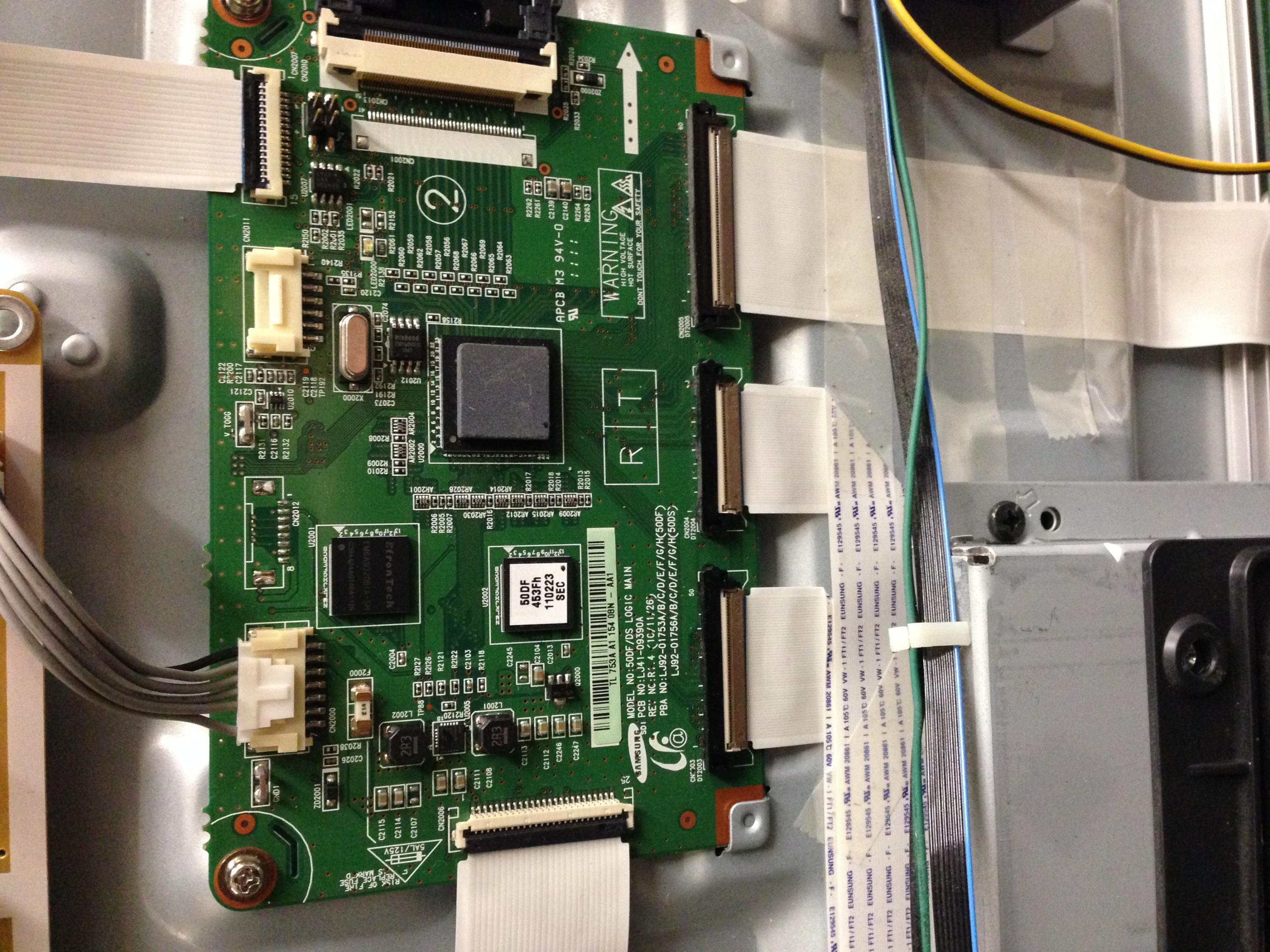

      Attached are pictures of the boards

        A popular failure with these is shorted FETS on the Y-SUS board.
        Worth checking the buffer for shorts too, as these can sometimes cause the Y-SUS to fail....

                OK, see this board - top left:
                https://www.badcaps.net/forum/attach...2&d=1397955423
                Do not touch any exposed metal on the power board whilst AC power is connected or shortly after.
                I'm assuming only basic multimeter knowledge: if you're more advanced let me know.
                Plug in the TV but put it into standby. If not possible, unplug it for now and have someone plug it in when needed (later.)
                The points marked VS-TP and VA-TP are of interest.
                Set your multimeter to the highest volts DC range. Usually 500, 600 or 1000V. Or if your multimeter is autoranging, use the Volts DC mode. DC is marked by solid and dashed line sometimes. Do not use the AC range (marked by a squiggle.)
                Place the black probe on the chassis of the TV: the metal backing of the plasma panel. This is your common/ground point.
                Then touch the red probe to the VS-TP point, note reading should be near zero.
                Turn on the TV. A helper is useful, you can also use the remote if it goes in and out of standby.
                Note if the reading changes throughout the clicking cycle. Repeat for the VA-TP.

                  When unplugged, both read to be 0.0V. During the clicking cycles, I measured VS-TP to be 1.3V and VA-TP to be 0.0V

                    OK. Now you see the two large left & right hand boards? Left one is Y-main, right is X-main. I want you to unplug the power connector for the Y-main (going between power board and Y-main.) Now repeat the test for VS-TP and VA-TP.
                    Note: Do not plug in the connector while the TV is running or within 2 minutes of switching it off. Always remove the connector with the set OFF.

                      When the Y-SUS board is unplugged, VS-TP was measured around 200V and Va-TP was measured around 58V. Both started to drop after the first click stopped
                        Re: Samsung PN51D550C1F - Clicking...HELP!!!
                        OK, sounds good - probably got a bad X- or Y-main board. Plug the Y-main power back in. On the top of Y-main, find the grey connector going to X-main, unplug that, and check VS-TP and VA-TP once again.
