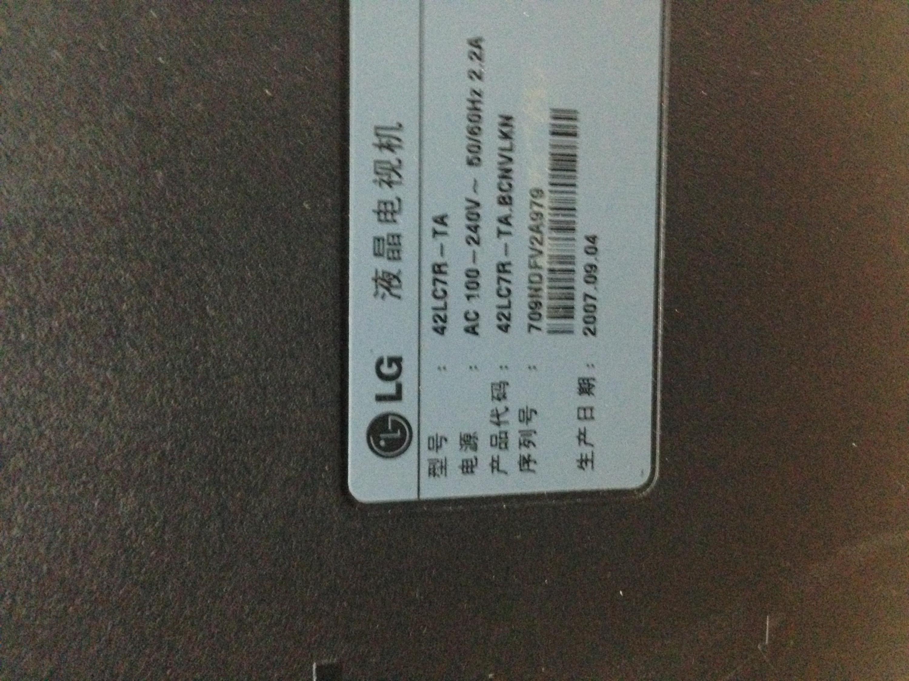

lg 42lc7r
    lg 42lc7r

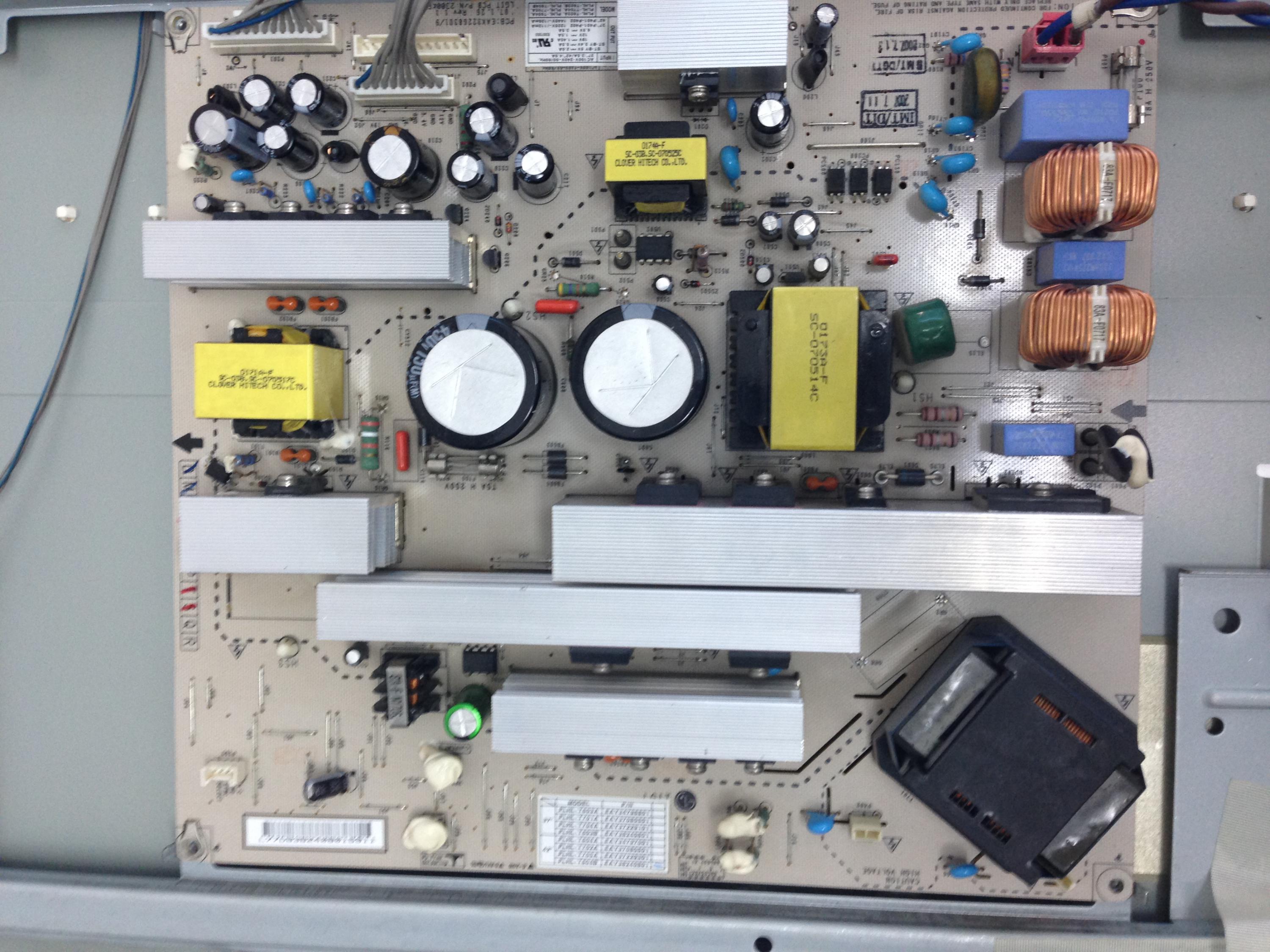

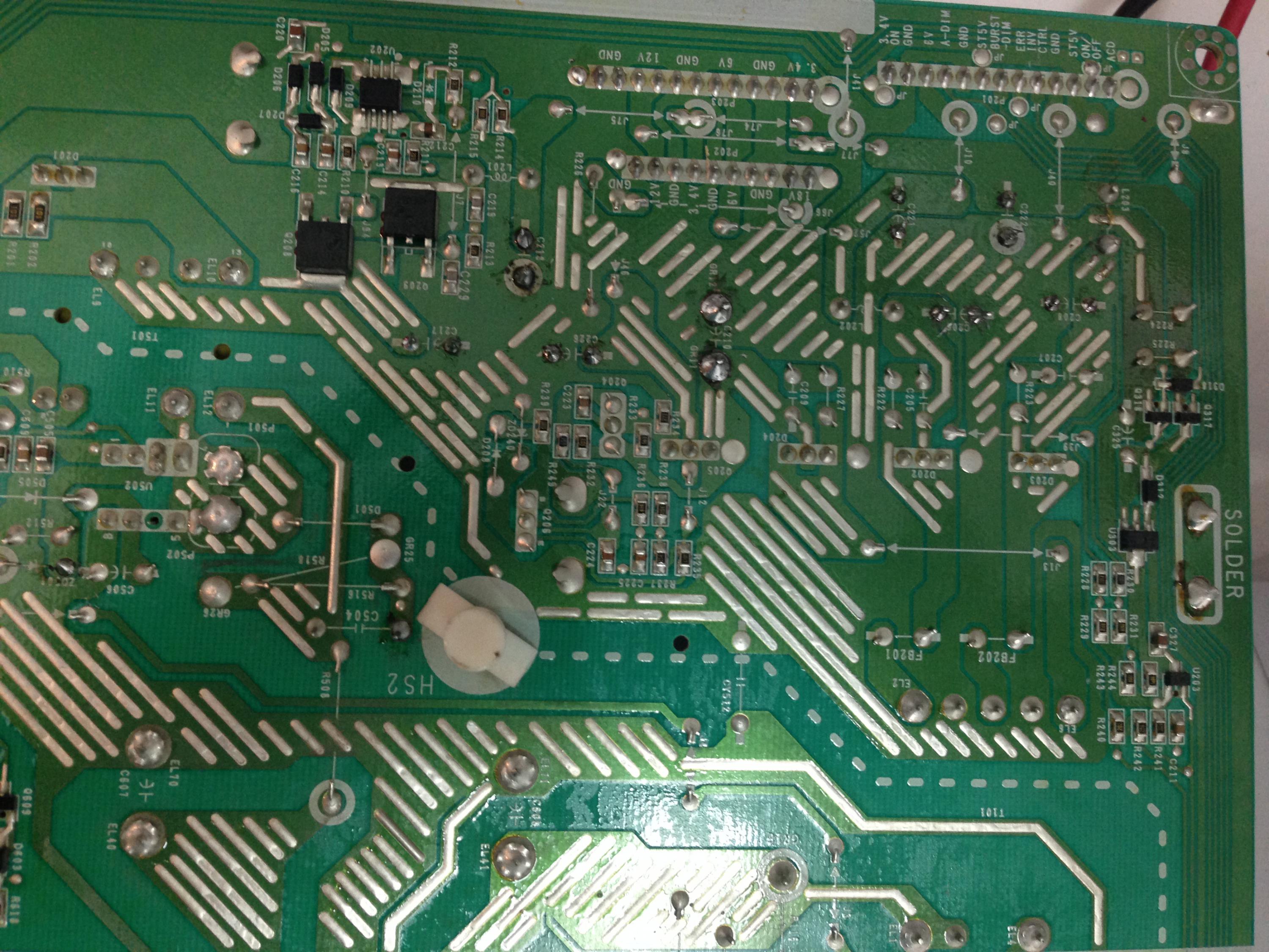

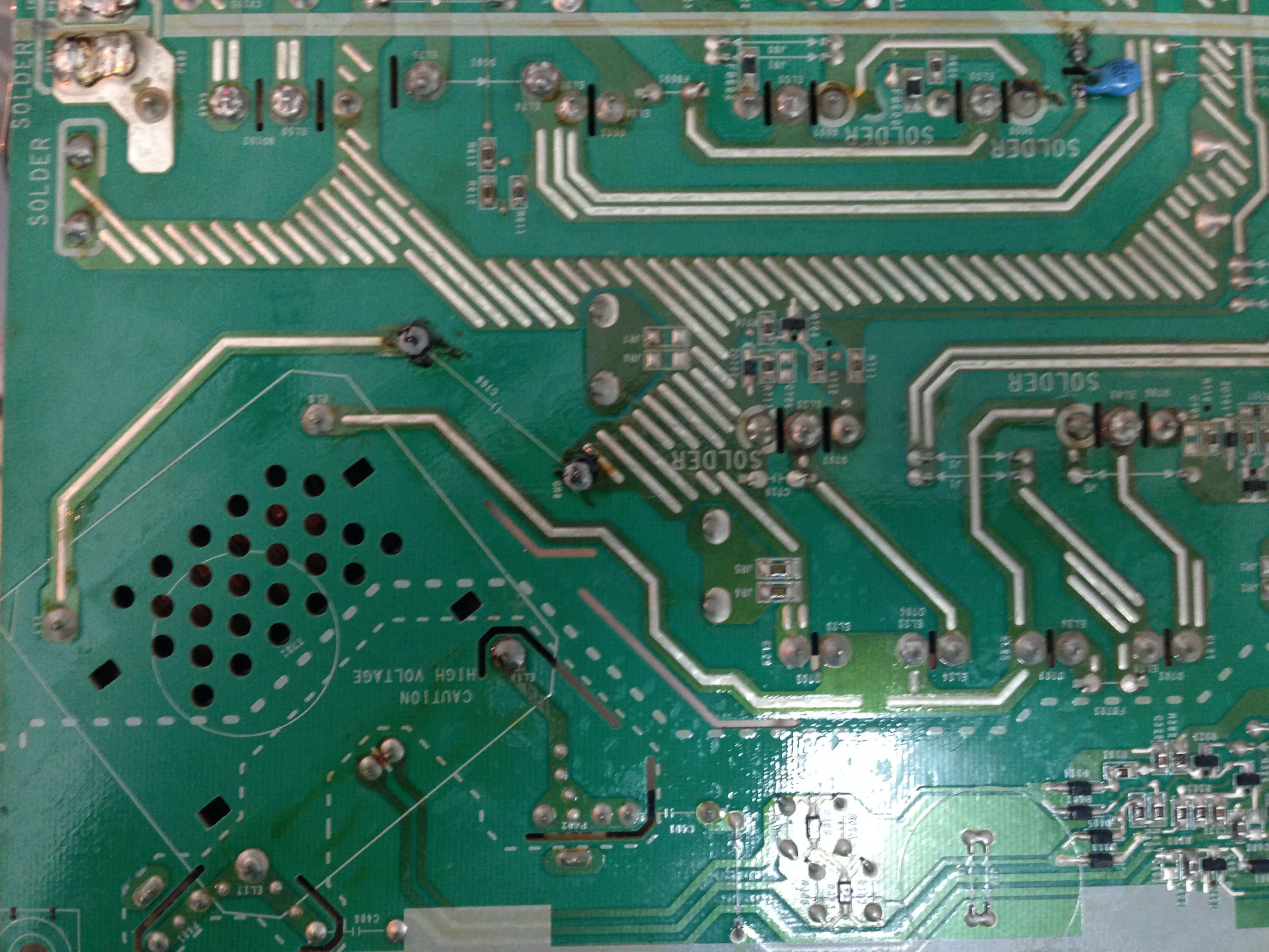

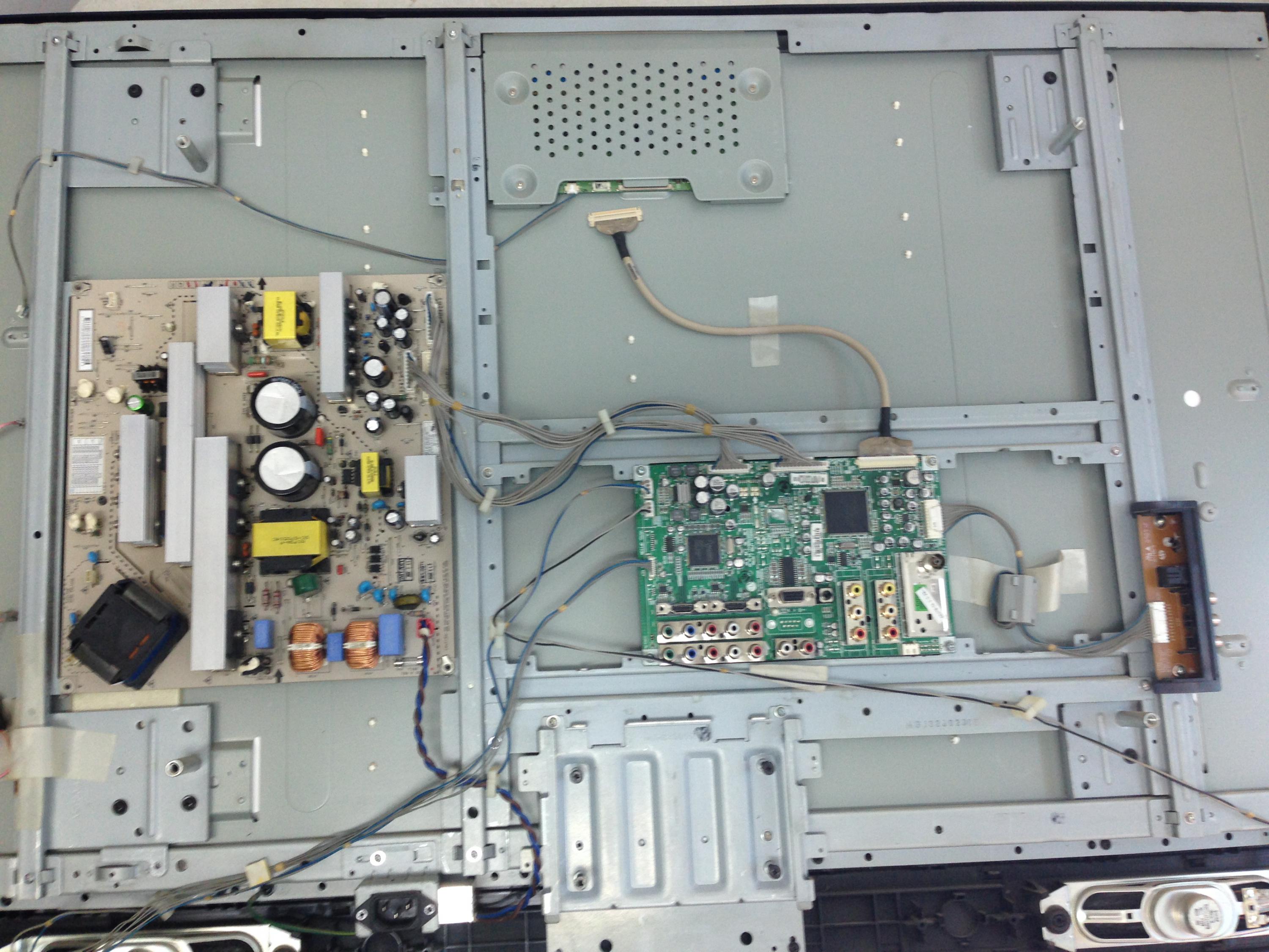

    hi all

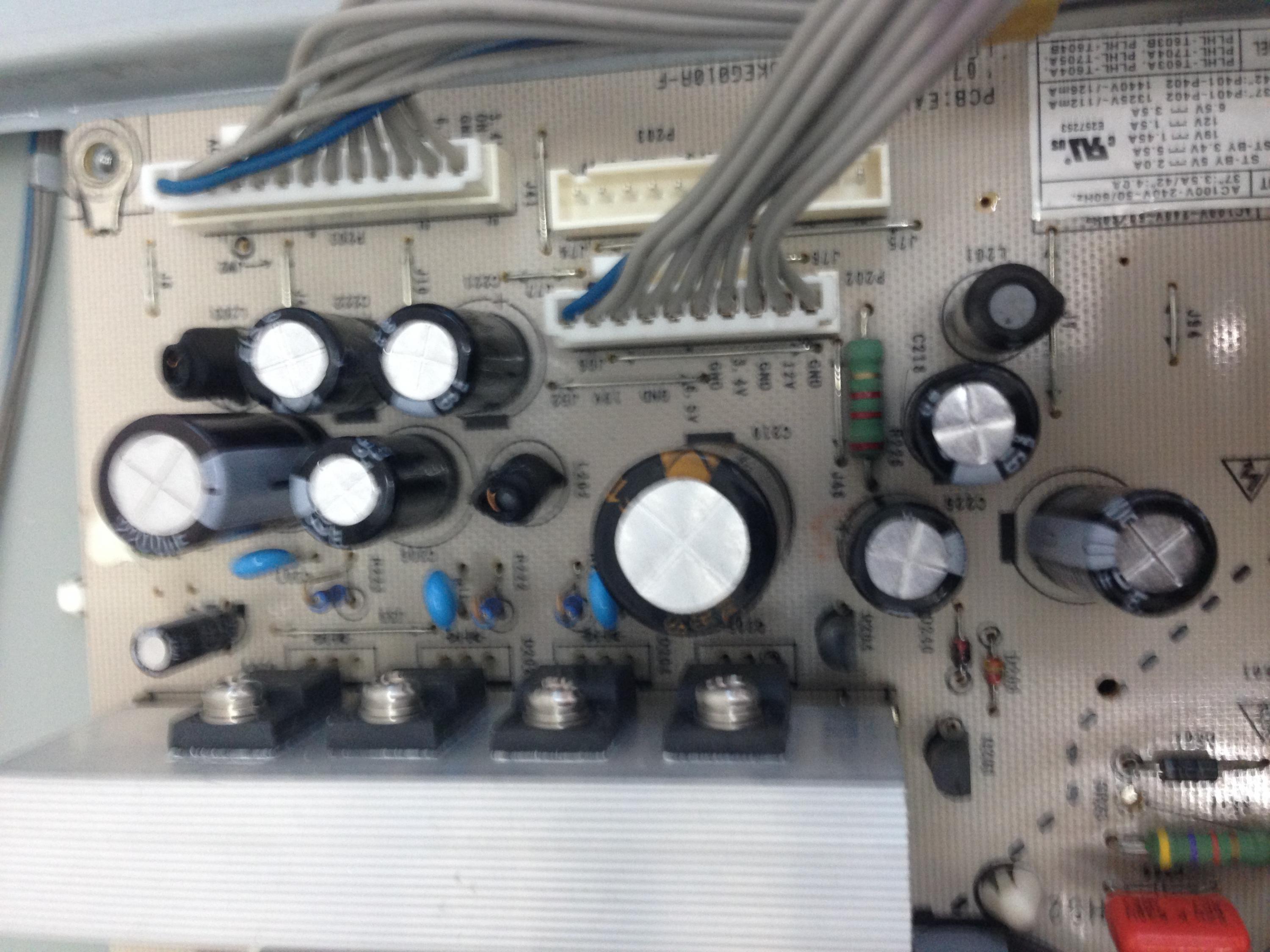

    i find 10 bad caps thet replace in new ones, low esr
    when click for on , the ledswitch from red to green and blink
    after 5 or 7 blink the led turn to red and Hear a strange noise from the speakers.
    psu eax32268301/9
    Re: lg 42lc7r
    whan i press to stat the green led blink and the transformar make a buzzer sound and after 3 or 4 second it no blink at the ccfl lamp and stop the buzzer sound and i see red led.
      Re: lg 42lc7r
      i test all the caps for esr and they test good {after i replase same of them}.
