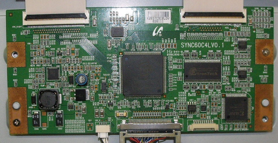

          I can not see anything marked with that. Forgive my ignorance but where to I tap in to check those voltages? here is a TCON board pic.
            Re: Proscan 40LC45S Ghosting bad color
            On yours, I see VON_P, VON, VOFF, and AVDD test points. Little gold pads, white silkscreen next to them.
            You use your meter, red probe on point, black probe on chassis, report the voltage reading.

              Wow do you have some good eyes! took me a while and a magnifying glass but here is what I got VON P=22.68V VON=18.53V AVDD=15.11V
                Check VOFF too, if you could.
                So far, those are all good, so I suspect the panel.

                  Voff=7.45v

                      Voff should be negative, is it?

                        Sorry, Yes it is negative.
                          Tcon is working. Probably panel.

                                    Well looks like one for scrap. I got a TCON board just to give it a shot and same thing so I will need to scrap this one out.
