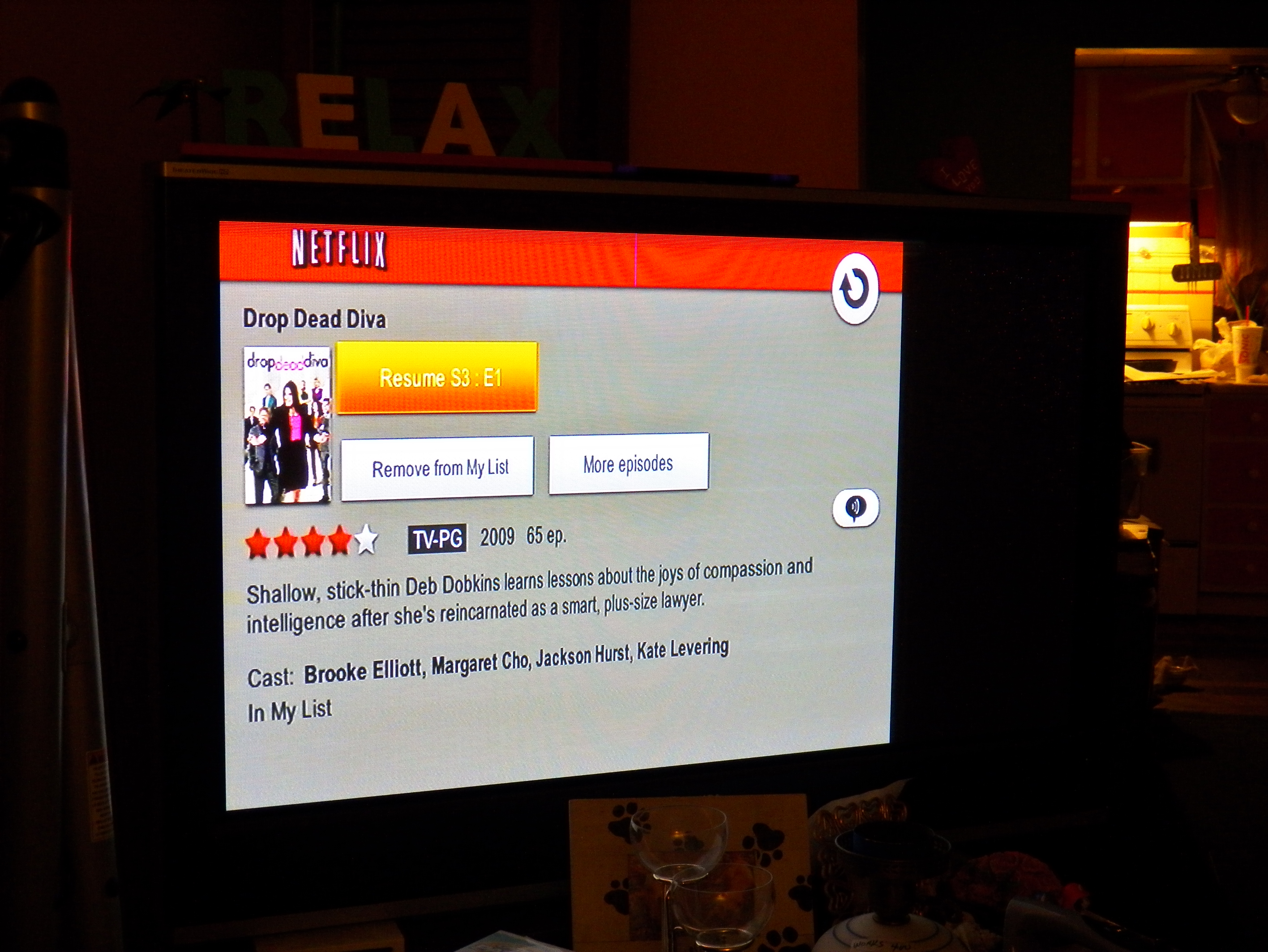

    Hello everyone.
    I recently bought a new scaler board for my TV, because through trial and error and some research I found out that the scaler needed to be replaced. The one that I bought came out of a 42" display, and that's all the display that I have on the TV now, the other 8" is pitch black, the screen doesn't extend to it, and the picture displays only to the 42" edge. Any ideas on how to fix this?

        Re: 50HP66 Display Problems
        very familiar with these Toshiba sets. post a pic of screen pic, description of problem. thanks
          Well I posted a photo. This is what's it's doing, it's just not filling up the whole screen. :/
            Is the 42" scaler board compatible with the 50"?
              Yes it's supposed to be. (same part number and everything) From what I can figure out though it needs a firmware update which I can't find anywhere
                I wonder if in the service menu a person can set screen size?????
                  I've tried that, and there is not an option for it. The only thing that I know is that on the back of the Scaler board there is a USB port for a technician to apply a firmware update.
