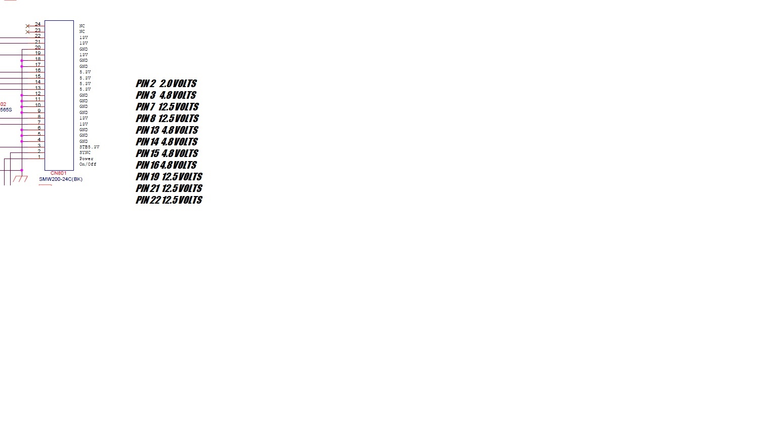

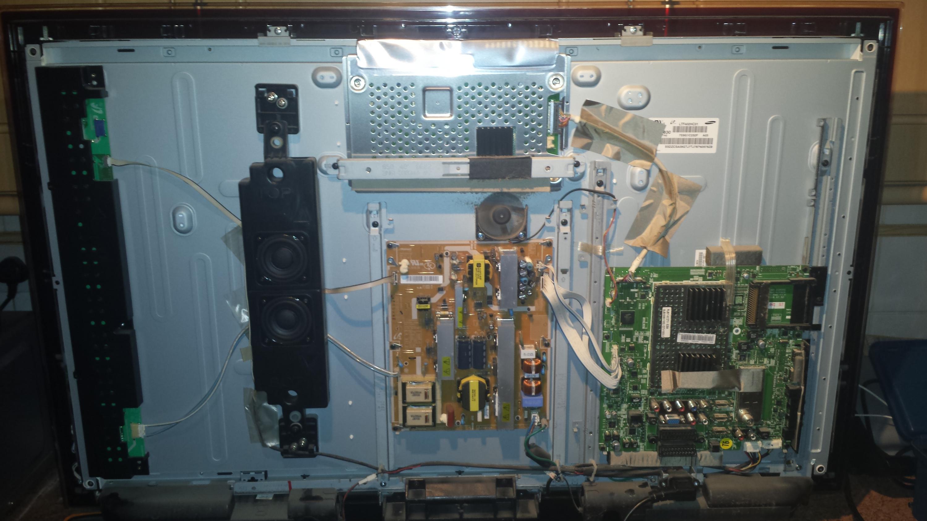

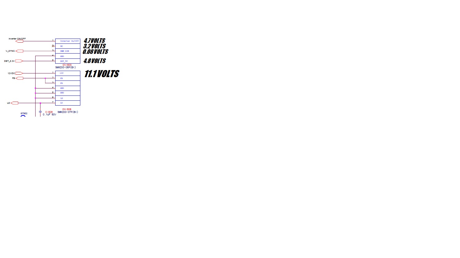

    Hi guys bought this tv today was told the screen will go black after a while but still has audio so been running it for a while today but everything seems ok
    any ideas ive attached voltages and pictures of the chassis and boards

    might of knocked a connection taking it apart, try cleaning and reseating them all

      I've since changed the psu due to having a spare just in case it was that all voltages I thought the 12V was running low at 11.1 but they are still the same with replacement psu, so testing now, could it be the panel ? Well if it goes on me
        Re: Samsung le40a756r1m
        I've had an LE40A656 which would reboot when the 13V went below 11.5V. (There's a 12V and 13V rail, they are different.) In that case it was bad capacitors. I'd advise replacing them anyway on these models as they have a high failure rate.
          ok thanks m8 ill try change them all
