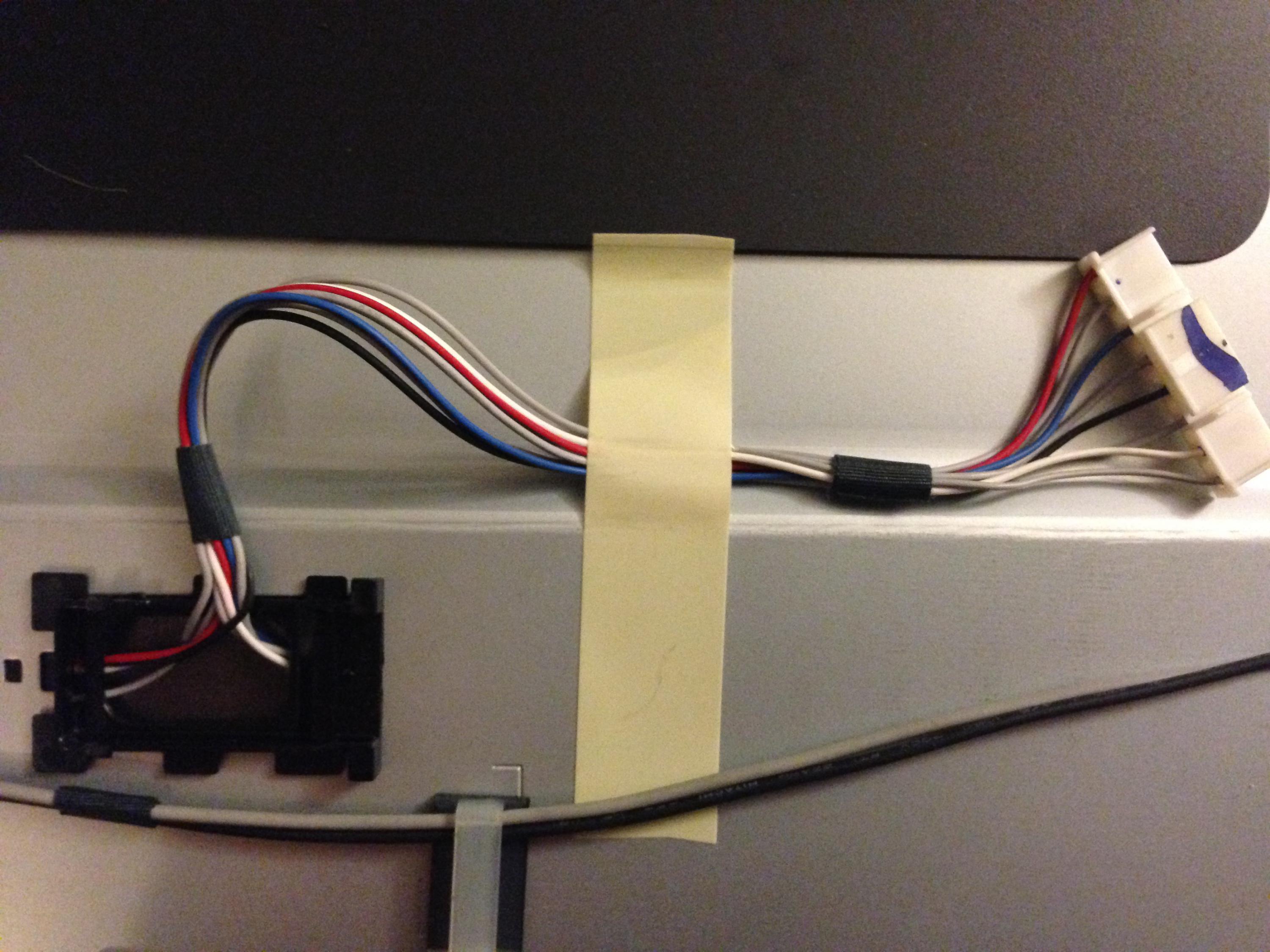

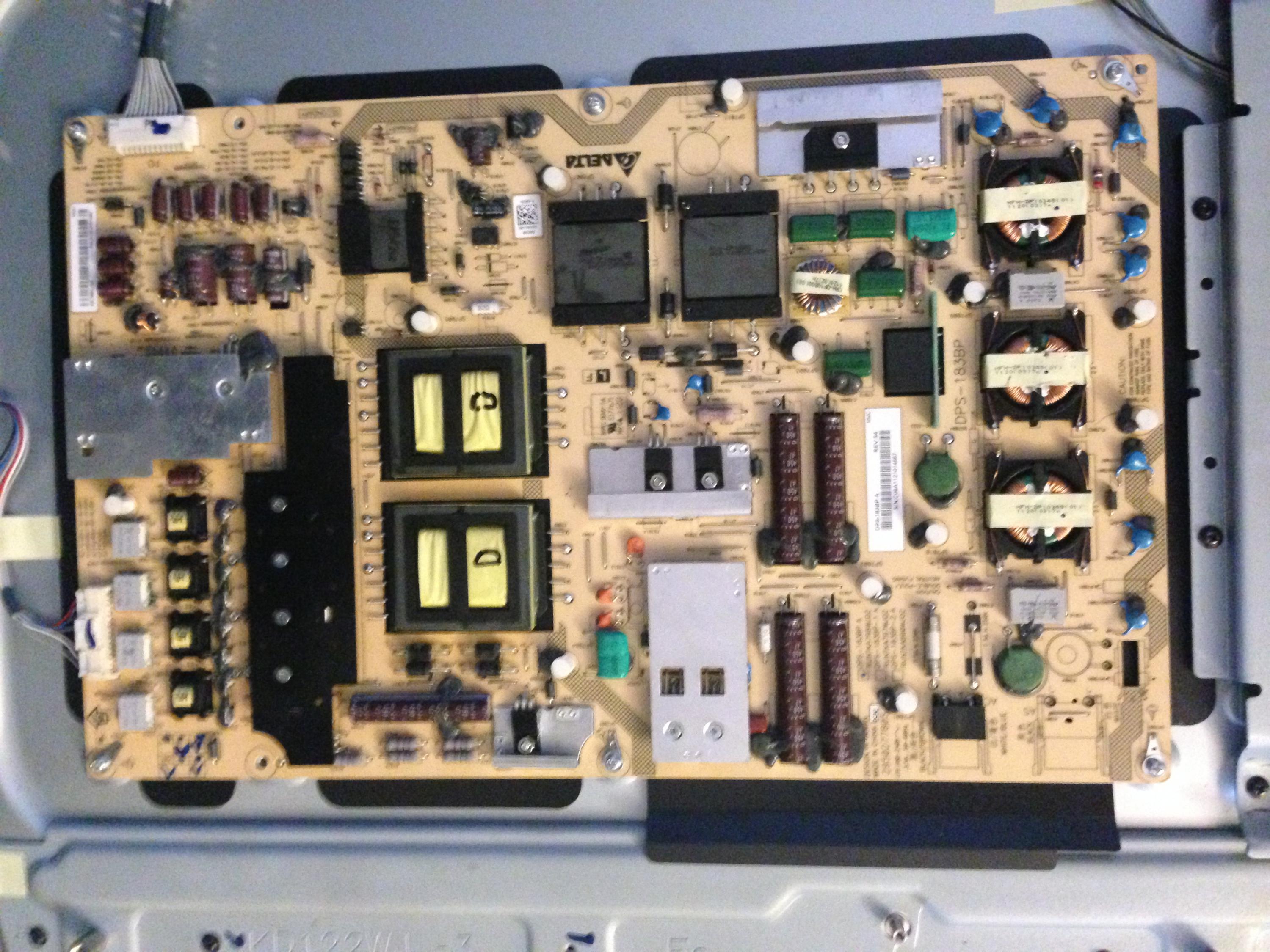

    Would love some help! I'm assuming I need to order a new PS board now? I unplugged the power after the pop and smoke, but I want to say that the tv was still doing a 1short/1long error code. I was kind of paranoid and didn't want to make things worse.

    Well I'm thinking.along.the.lines.of.power supply as well.but for.good measure I'd.ohm.the two cables and.check.for.ground shorts. especially when the TV behave differently when you pulled the back cover off you might have moved a wire and that wire shorted to ground they're going to be black wires and blue wires you need to check and see if the blue wires are shorted against the black wires or if the blue wires are shorted to the chassis of the TV.

      Thanks for the reply! Sorry, just to clarify, I need to ohm the blue and black wires for ground shorts. I'm out of the house, but from this pic I took on the phone (sorry it's blurry), there's only one black and one blue that is part of like a 7-8 pin connector? just above the transformer that went bad? bottom left in the picture. Is that right?

        OK. Ohm the black against the frame of the tv. Then the blue wires against the frame of the tv. Basically on your voltmeter red lead to each wire in the looms, black lead on the frame. Look for a dead short.

          Here's a better pic. I actually removed the board. Not sure how to get to the end of those wires, but I'll do some digging.
          Regardless, I'm going to have to buy a new PSU right?

            Got it. I missed that last post before I posted an updated image. I'll have results in the morning.

              Ok gave it a go. And didn't get any response in the voltmeter. No beeps. This was testing the black and blue wires when the PSU was detached, but that shouldn't make a difference right?

                Had my dad the electrician double check. He said no shorts. Any other thoughts?

                  Ordered a new PSU and it's on its way. Opted not to go eBay route bc of another thread suggesting possible bad inverters on the cheap boards. When I install the new PSU, will I need to reset anything or will it just plug and play?

                    I'm pretty sure you're on the right track see what happens with the new power supply re post

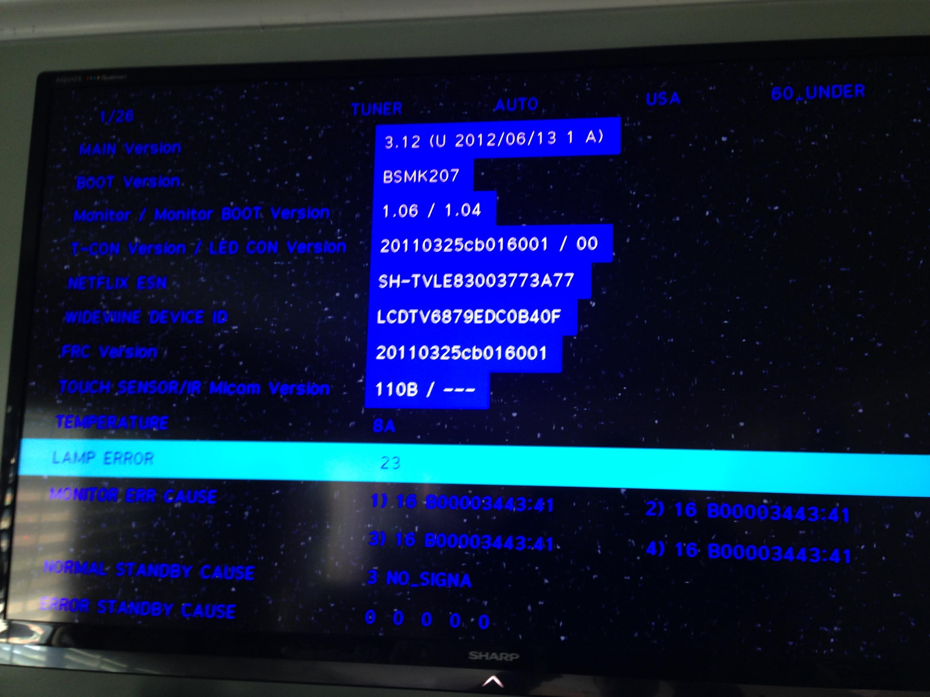

                      Alright guys, I installed the new PSU and lamp error is still going 1-1, but i bypass it with vol down, input, power, and it works! I've been trying to figure out how to reset the lamp error. I've gotten to the menu by holding channel down & vol down, here's the picture below, let me know if it says anything else unusual. There's an on/off choice on the second page of the menu for "Lamp Error Reset" I've tried to turn that on and then power the tv off but it doesn't reset the lamp error. Any suggestions?

                        Ok did it! I did two things and don't know which one did it. Went to the menu again and using the channel down button on the tv went down to lamp error reset. Turned it on, then took the tv remote control and pressed the "OK/Enter" button. Then turned the TV off. I then unplugged the TV and held down channel up and vol down while plugging in the TV power. No error light!
                        I'm still a little curious on the lamp error listings. The image above also had monitor error causes. Anyone have any insight to those? I have these high hopes and super low expectations that this fix is going to last, being it's the first time I've ever done something like this.

                          Detail display 1 Slow flashing - 1 Fast flashing - Cause
                          Inverter/Lamp system failure Flashes once Flashes once Lamp error

                            Thanks Nuala, I had information on the light codes, I was actually referring to the image I posted that listed the reference codes of the monitor error.
