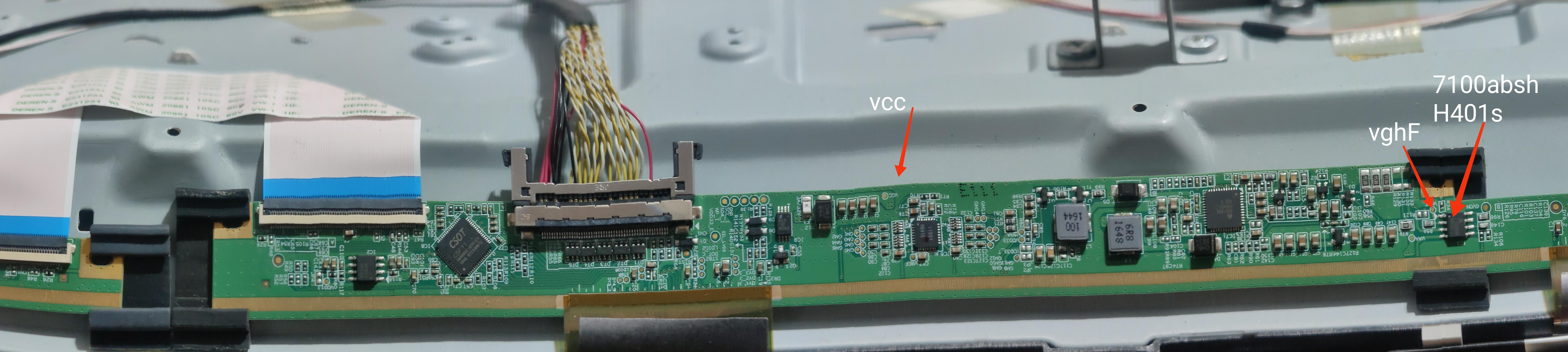

    Hi everyone;
    Backlight is ok also we have audio from tv but black screen out!

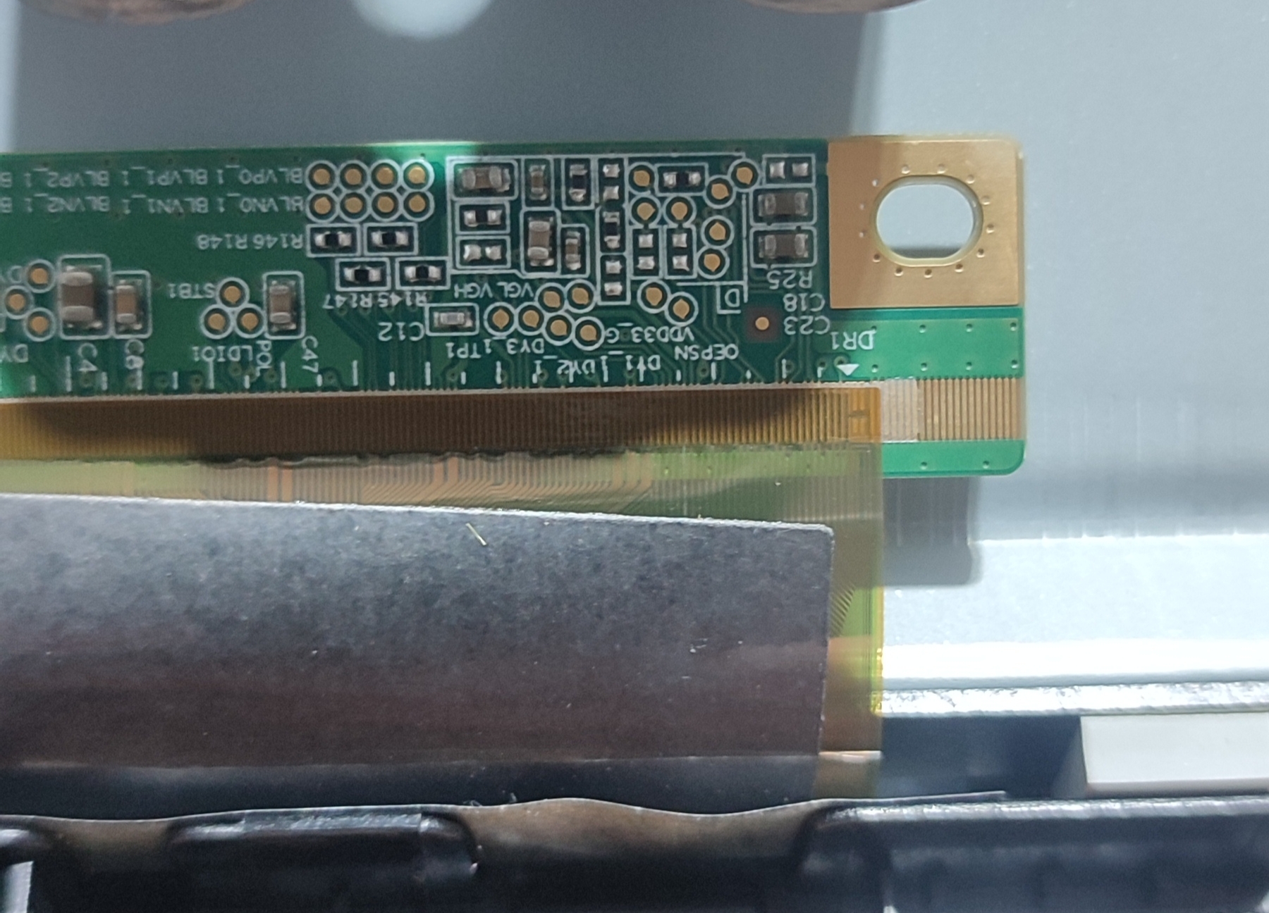

    TICON is placed on the address board in this model (image uploaded). And two address boards pluged to each other. I released one side to sure about broken on that ( I guessed that the panel is defective) but i can't be sure about other side because TICON placed on that.
    Vgl voltage: 0.11
    Vgh voltage: 0.63
    Vcc: 12.2 ok

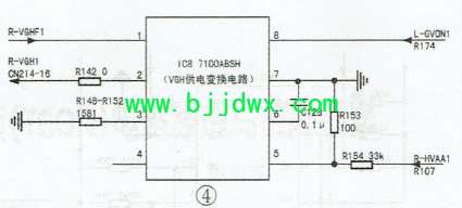

    ic part 7100Absh have 3.3v on pin 4 and 2.3v on pin 8. Other pins zero. (Pinout uploaded)

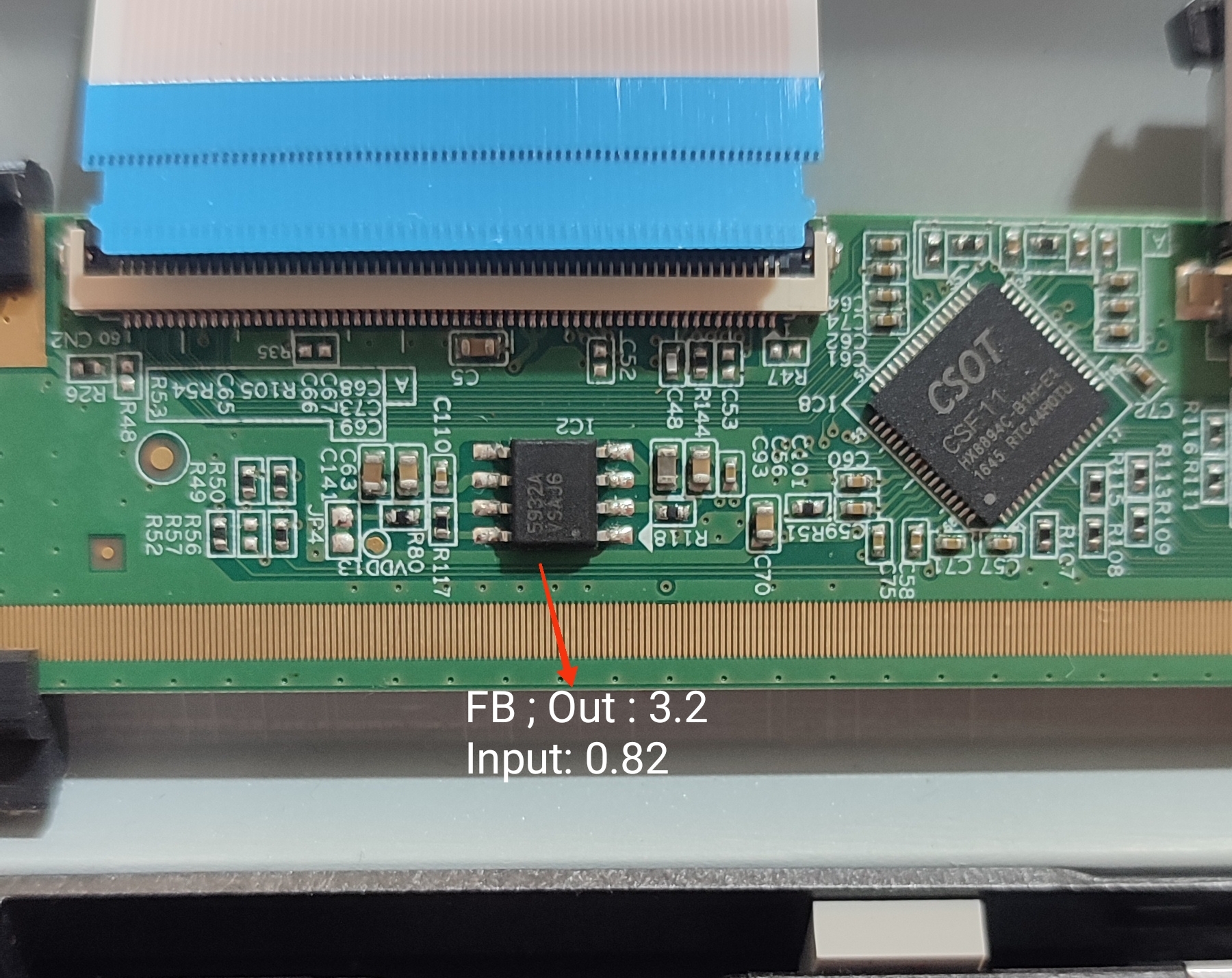

    Regular ic part 5932A have 3.3v on FB;Out pins. The input has low voltage (about 0.8).
    Need help!
