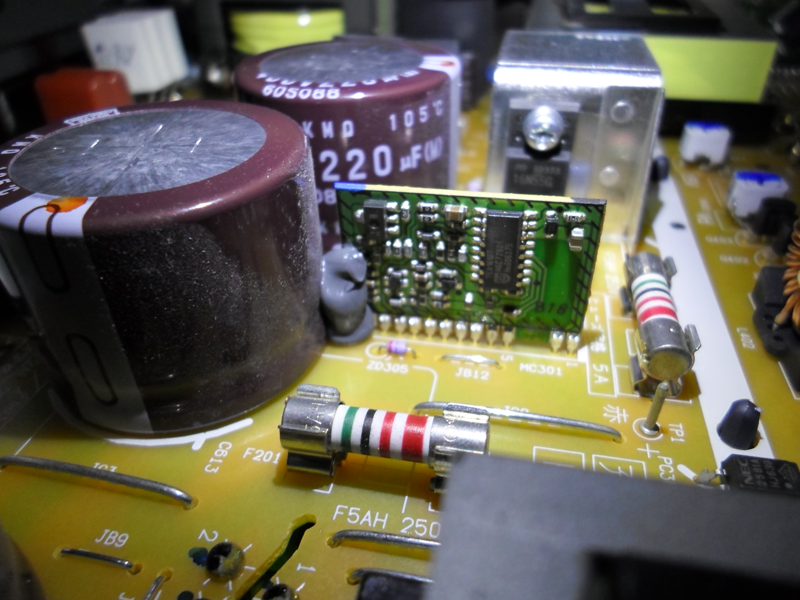

        So I did press on them this morning before turning on, and TV turned on normally, but I noticed a few minutes later TV was off giving 10 blinks.
        That same cycle repeated after unplugging it.
        So I shot some freeze spray on both MC201 and 301 and now it won't turn on at all, just gives one click and then the 10 blinks.
        My modules look a little different than the others, which cap is it?
        Does it still seem like those caps?

          Re: Panasonic TH-50PX75U Plasma 10 blinks?
          Usually one to the left of the IC. This is the VBIAS voltage for the IC, about 12.5V from memory.
          When it becomes leaky, VBIAS drops and IC does not work properly, hence 10 blinks.
          So see if you can check voltage across it, be careful not to short anything.

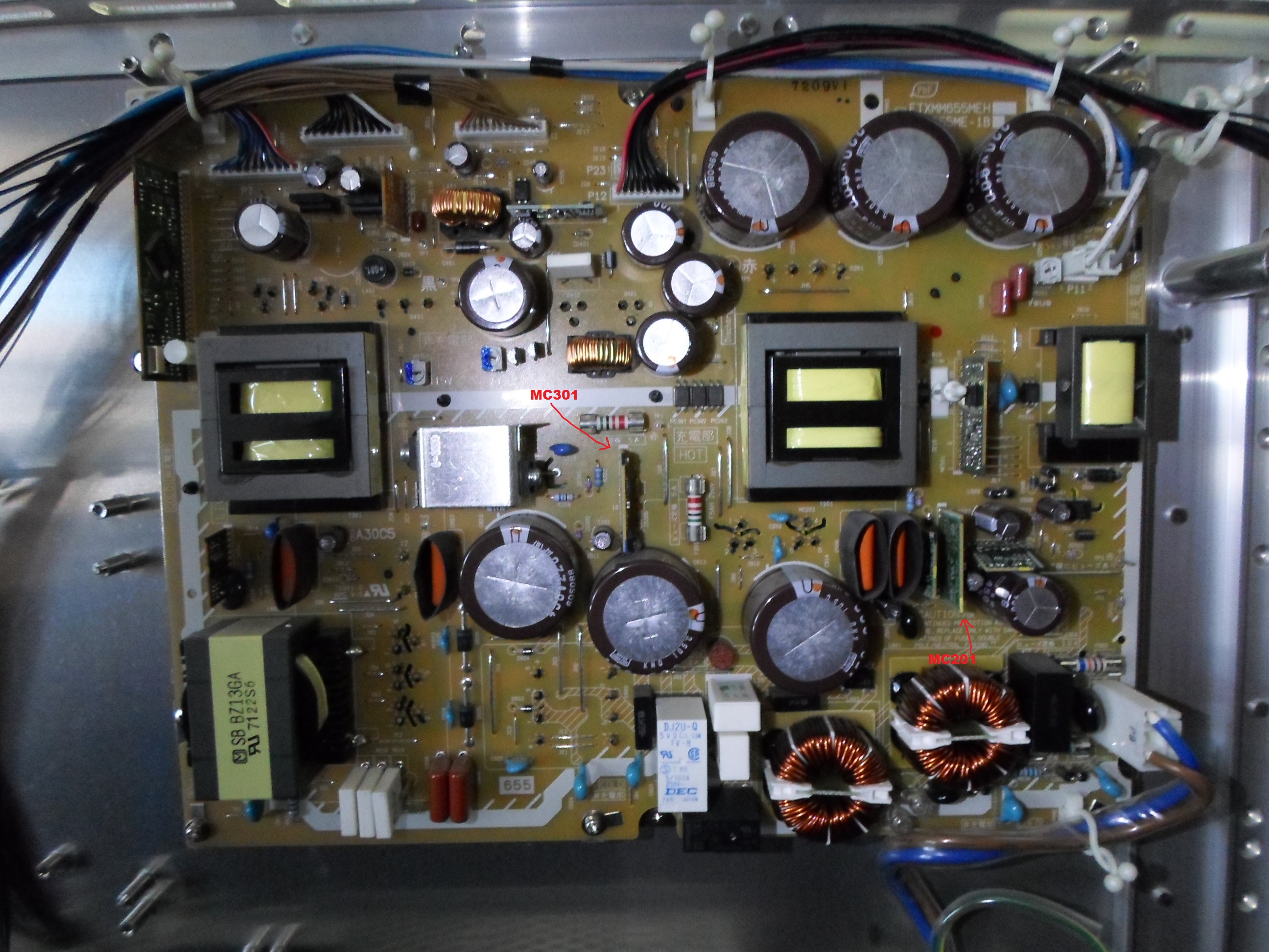

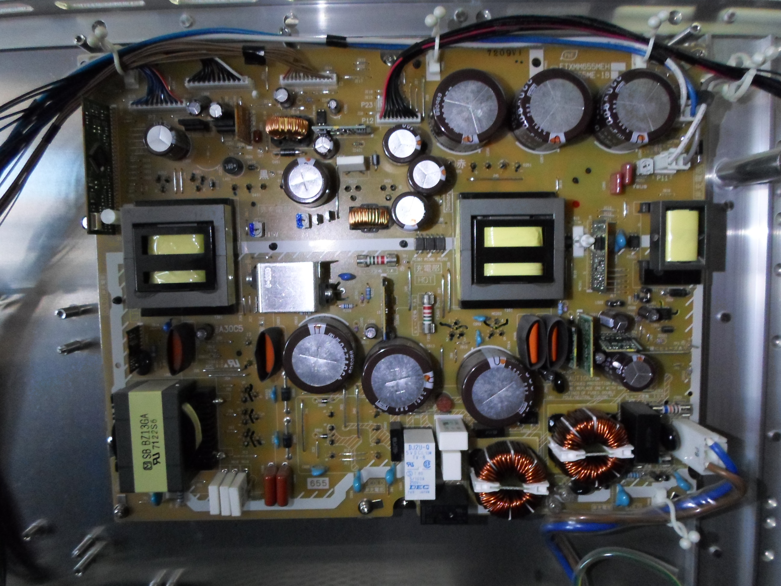

              Could you highlight MC201 and MC301 on this pic so we know which is VSUS and which is 15V/VDA.
              https://www.badcaps.net/forum/attach...4&d=1394290631
              But that does sound bad.
              • kevinm34232
                • May 2012
                • 1884

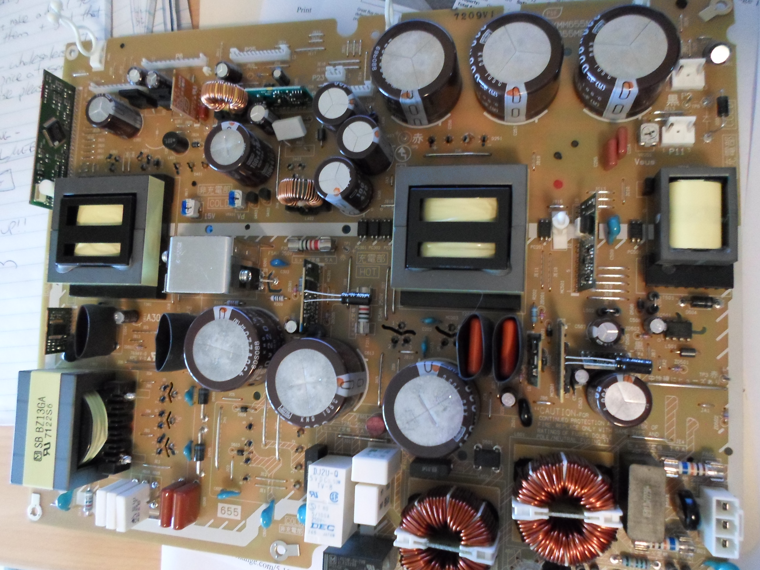

                OK here it is

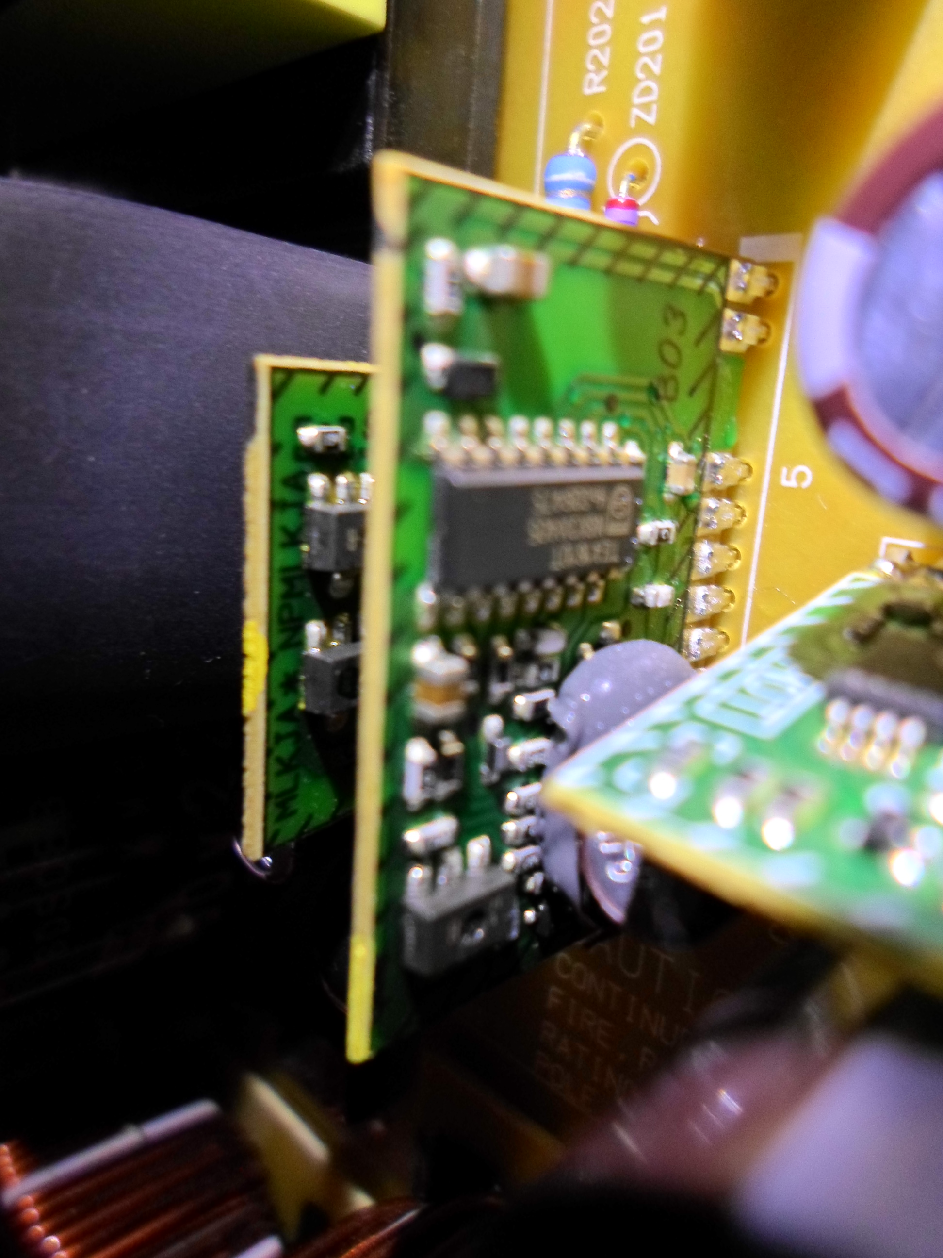

                  OK so MC301 is for 15V/Vda, MC201 is for Vsus. So it could just be MC201 fault. Both should have 12V bias voltage once relay clicks (I believe they're on the same supply rail.)
                  I think you should replace both caps. 1uF/25V.
                  On these 2007 sets missing Vsus will trigger a 10 blink fault but only if turning on (green light flashes then clicks off, 10 blinks...) I had 42" with a false Vsus detection error causing 10 blinks. Missing 15V will also trigger a 10 blink fault but it will do it immediately after a few green flashes. In the case of missing 15V, you may be able to put set into standby.

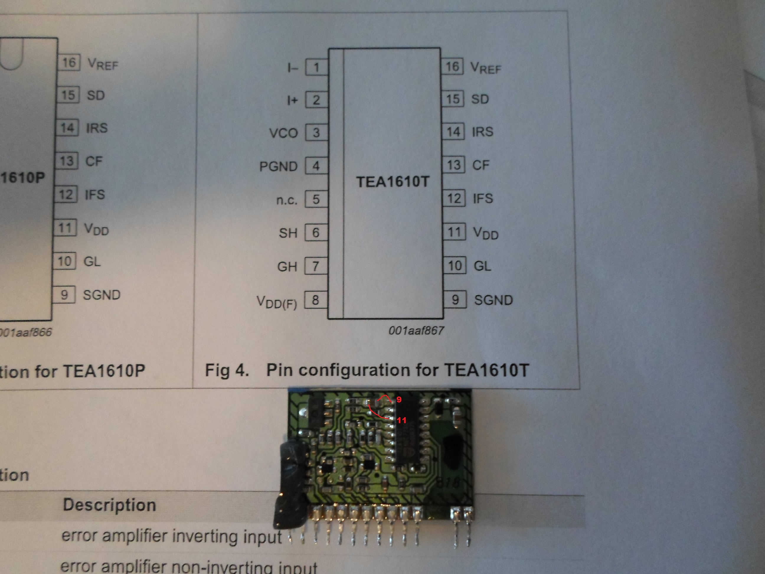

                            OK got the modules out. The other posts are I saw seem to be based on the TEA1611 chip but it is this cap right to the left of the IC.
                            Ill probably remove old cap and connect the negative leg directly on pin 9 of IC, and positive leg to pad connecting to pin 11.
                            Ill Let you know what happens.

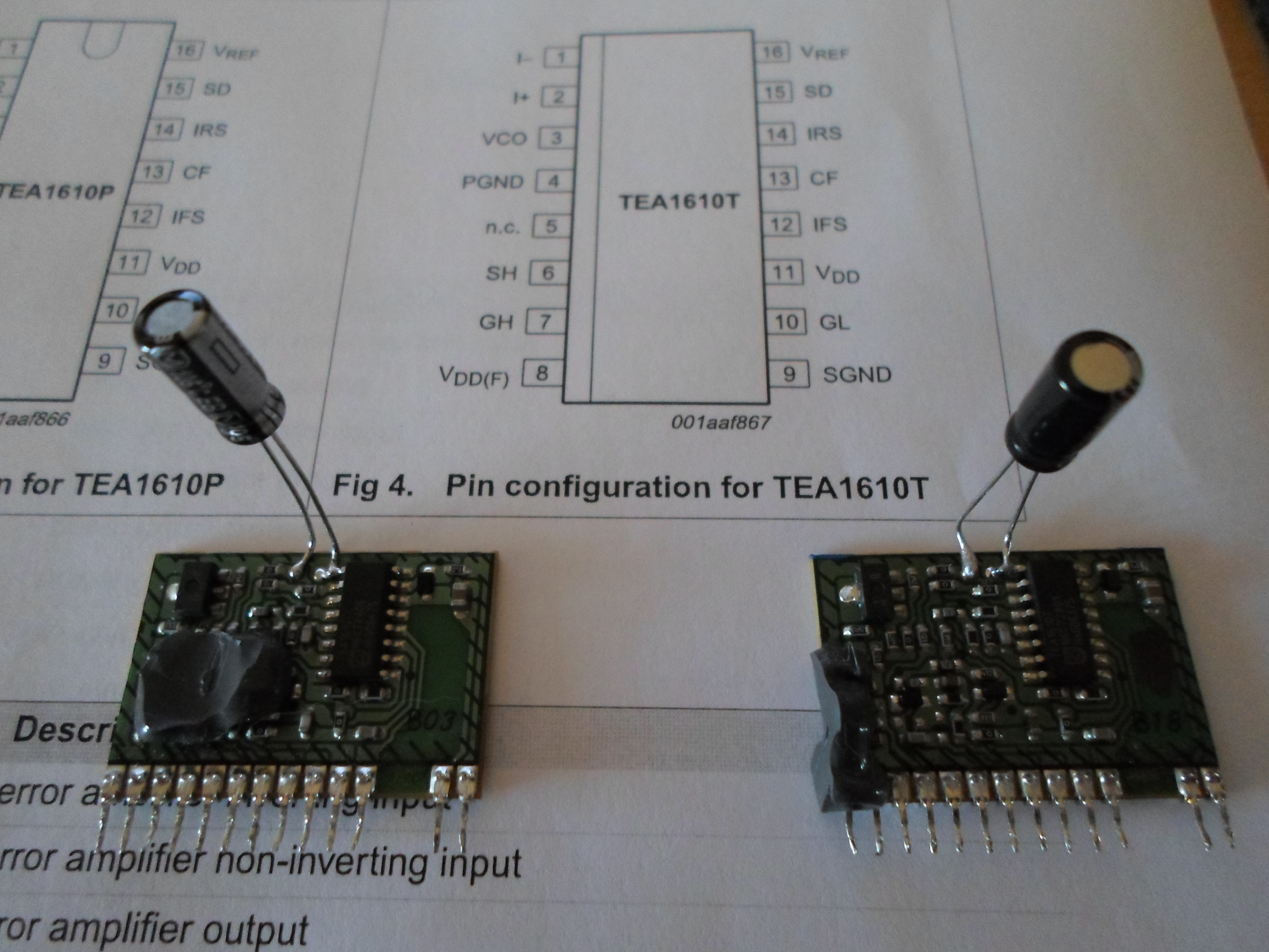

                              With new caps...
                                Neat, I would use glue to secure them though.

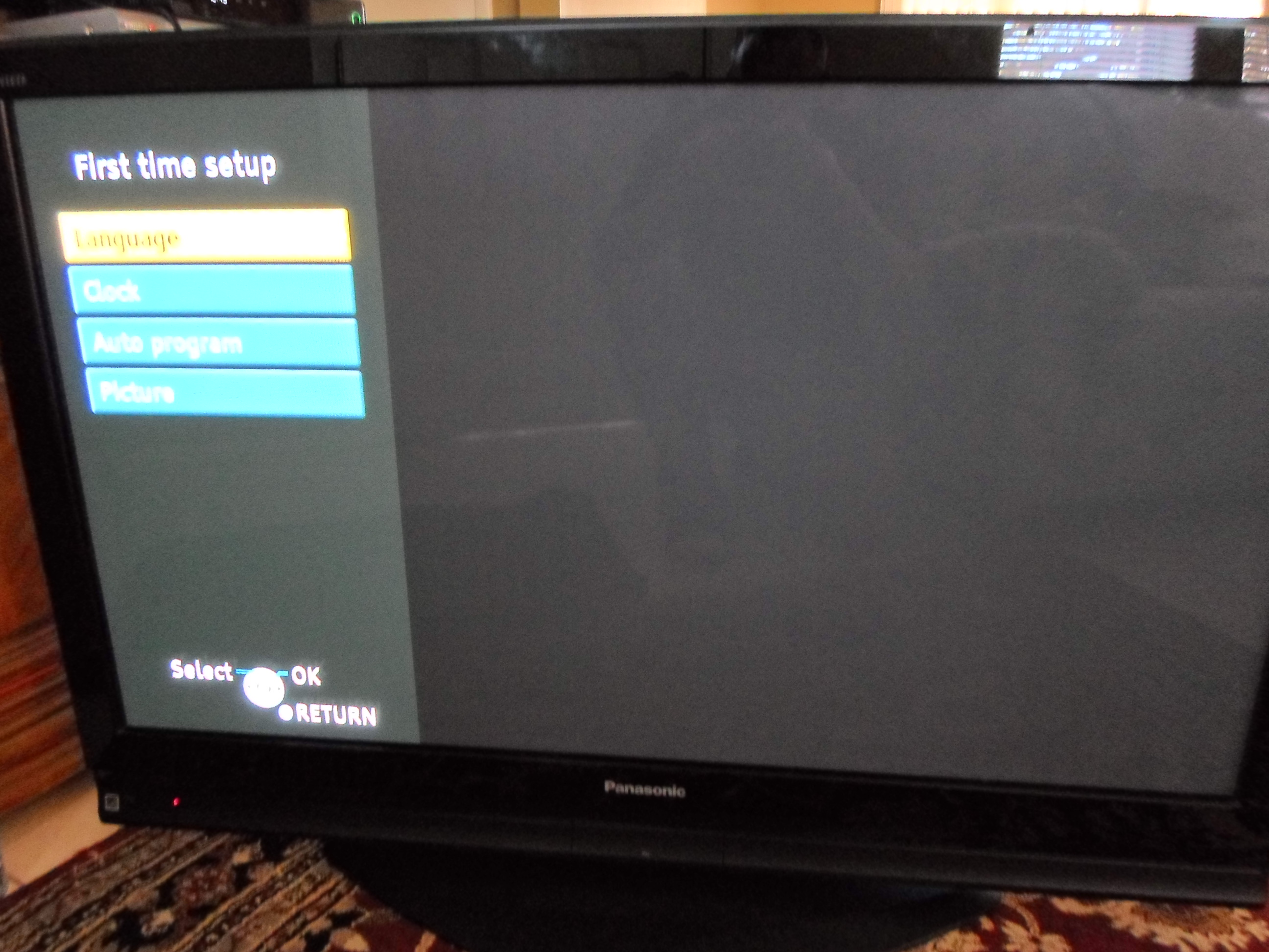

                                  Ill glue em.
                                  Awesome, TV came right on!! Let's see how it goes for a few days.
                                  As always big thanks for the help!
