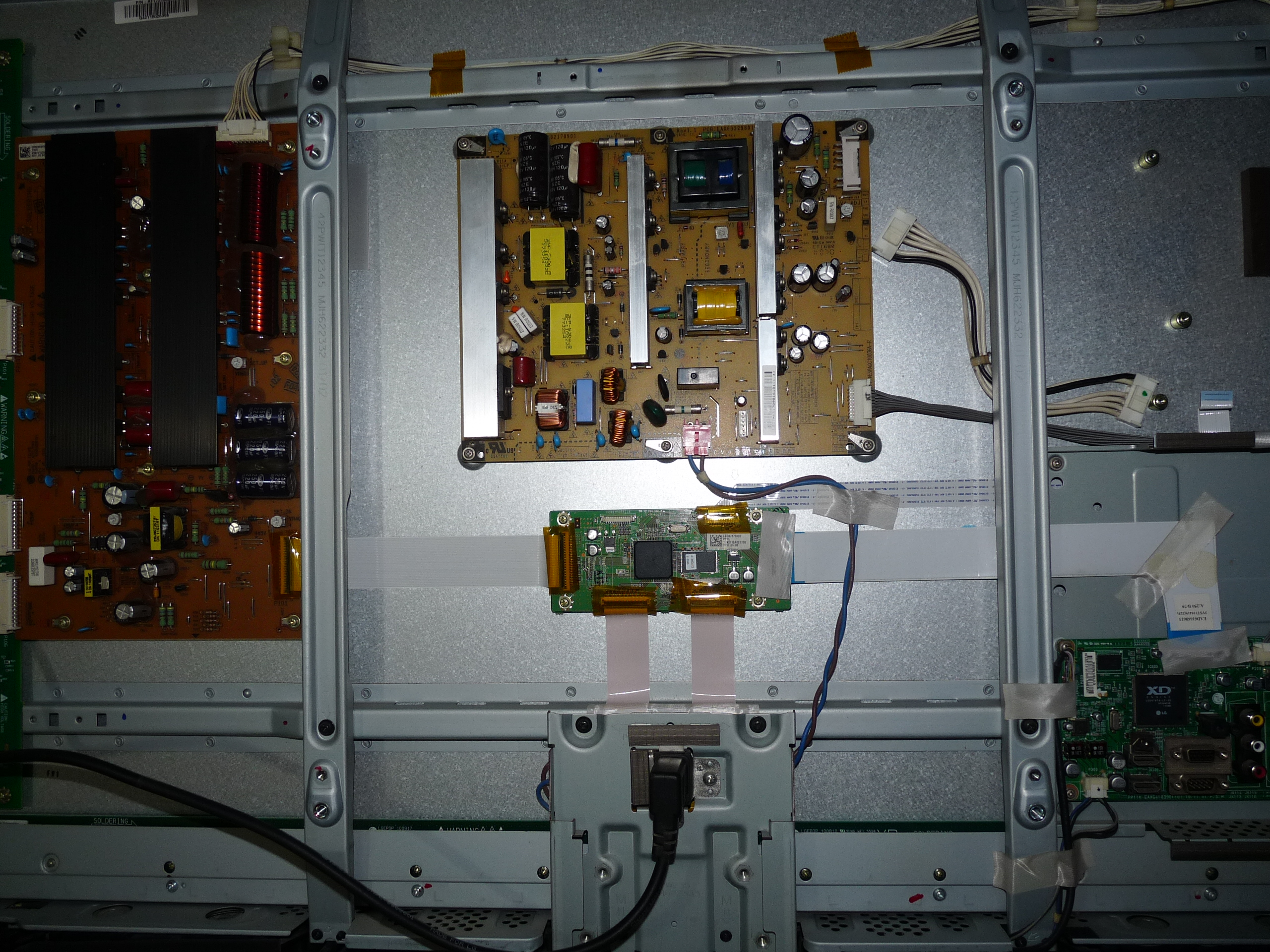

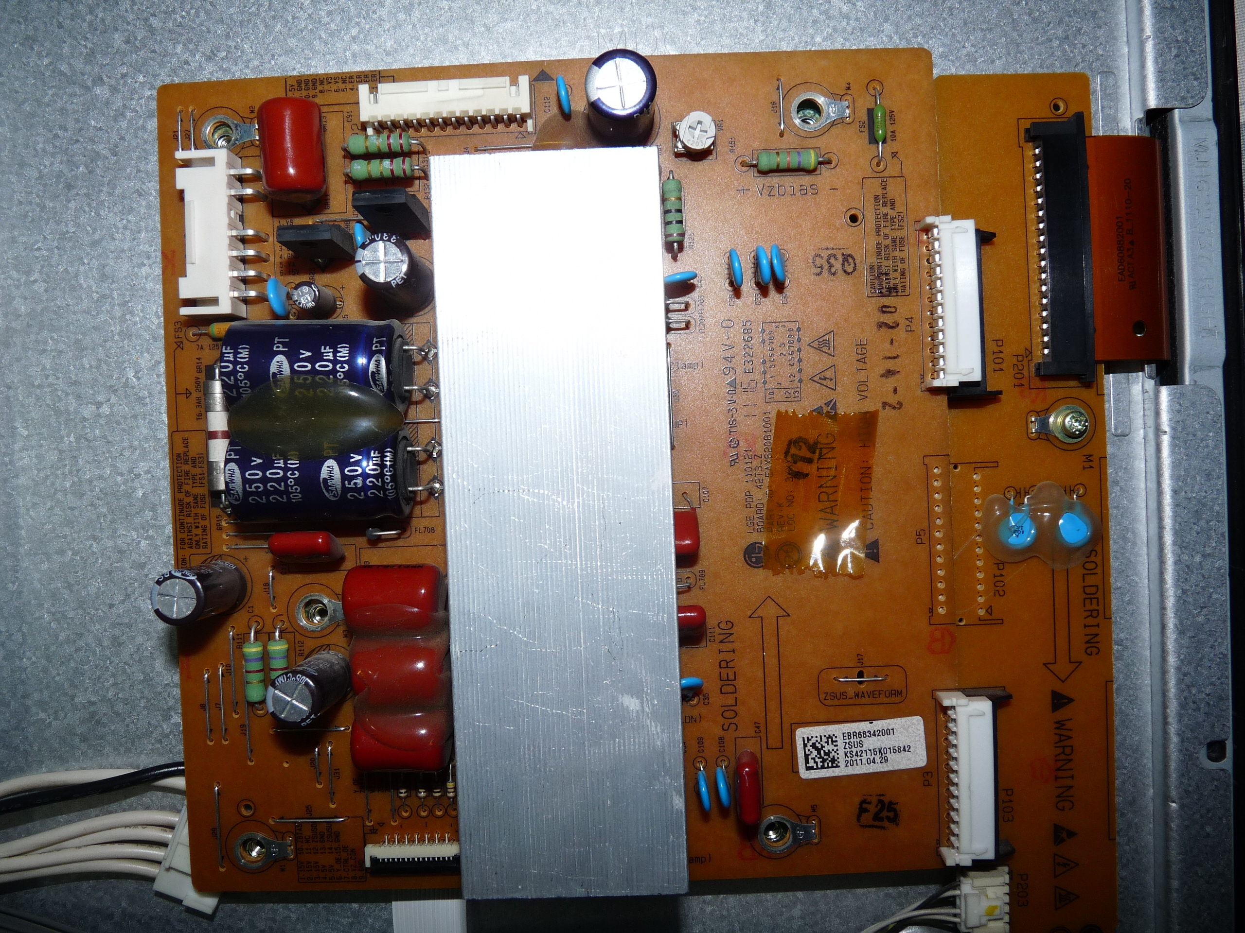

    I have 3 years old LG 42" PT350 tv. Which recently started making humming noise and eventual failed to turn on. It only clicks and then go back to protection mode then clicks and so on. I checked va vs on power supply they are within specifications which is va 55v and vs 203v. So power supply seems ok. when i remove the z-sus board from power supply tv turns on but without any picture which is expected.

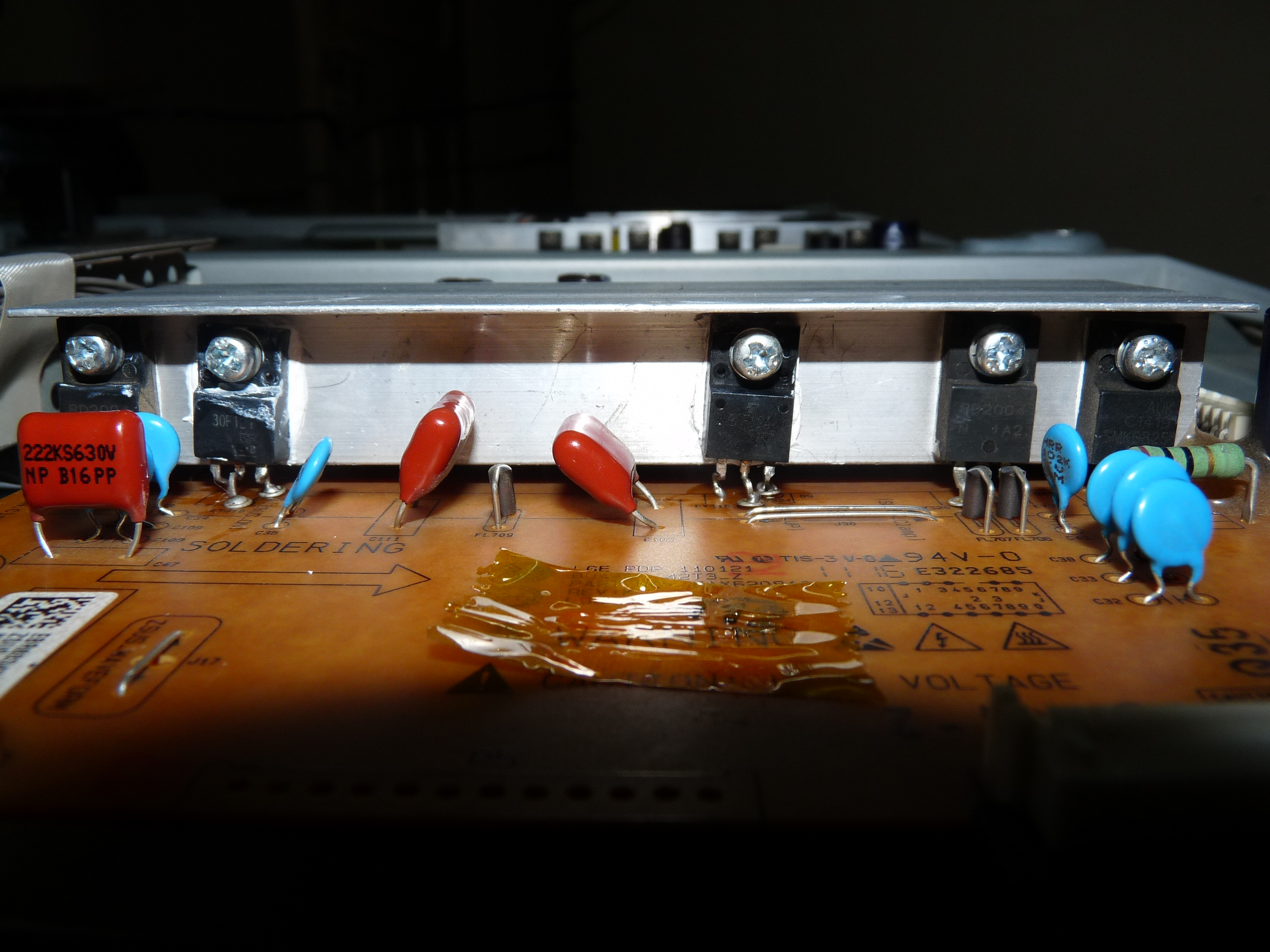

    So removed z-sus and found two 30F124 shorted. Replaced them and reassembled again. Turned it on to find that symptoms changed a bit. It was clicking with more delay now. Then i turned off and removed the y-sus from z-sus board and tried running again. It made humming noise again and back to same clicking with short delay.
    Opened z-sus again and to my surprise 30F124 both are shorted again.
    Seeking experts support on this.

    When you replace an IGBT, it's important to also replace the driver IC which goes with it.

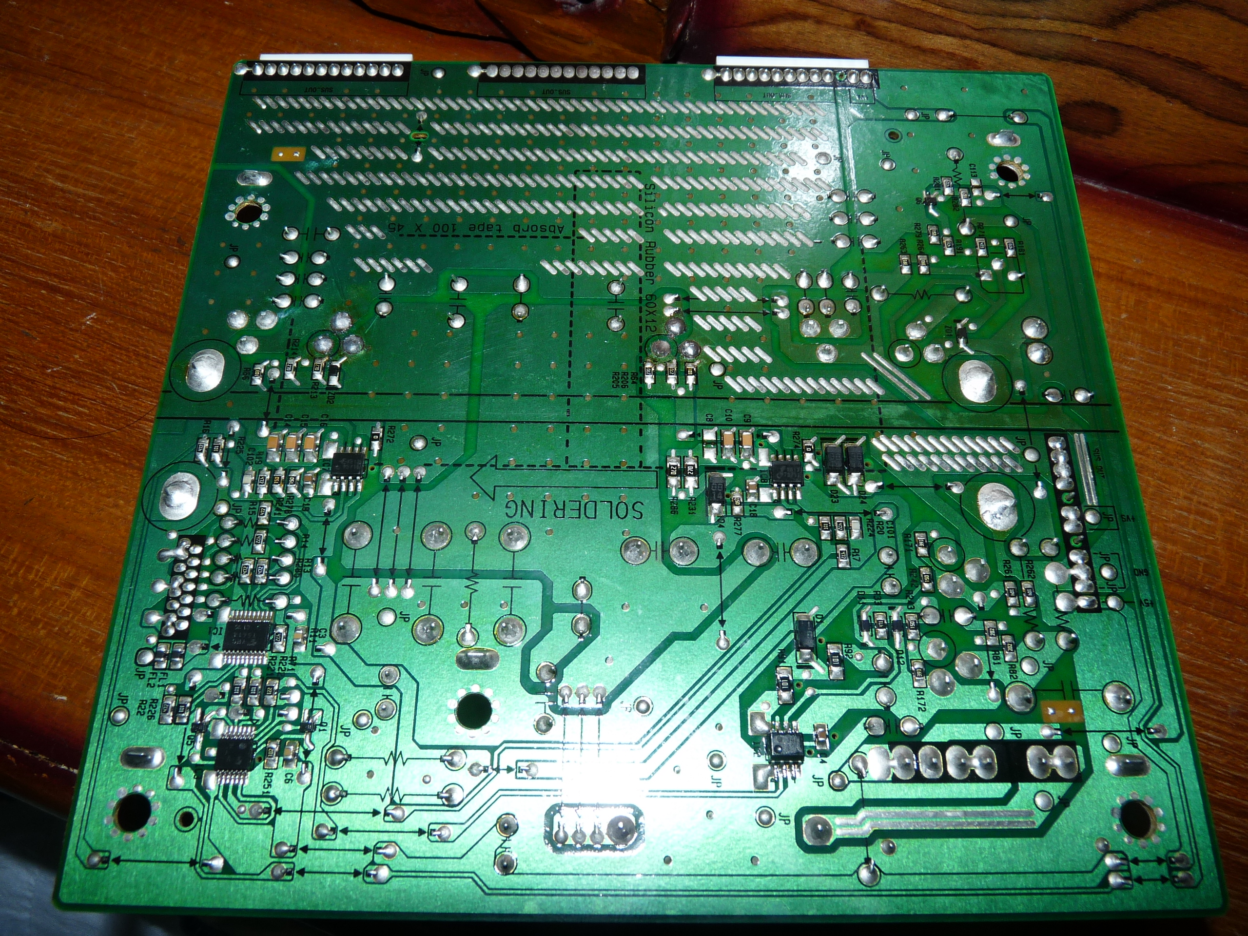

        Can you post a picture of the bottom of Z-sustain board? The green coloured side.

          Here's back side pic
            Re: LG 42PT350R Clicking Array
            driver ICs are IC7,IC8. (I assume you replaced the two IGBTs with solder marks on them?)
            Replace these along with the IGBTs.
            Check all resistors around IGBTs too.

                More than likely FAN73711, high side IGBT/MOSFET driver.
                http://www.fairchildsemi.com/pf/FA/FAN73711.html
                If resistors are OK, no need to replace them, but as they cost so little, it could be prudent to replace them regardless.
                Also check Y-SUS for shorted IGBTs; if you find any, you will need to repair both boards as a bad Y-SUS can damage Z-SUS and vice versa on these newer panels with "chained ERC".
                Forgot to mention check the little zener diode ZD2 near one IGBT - if bad use a 18V to 22V SOD-323 zener.
