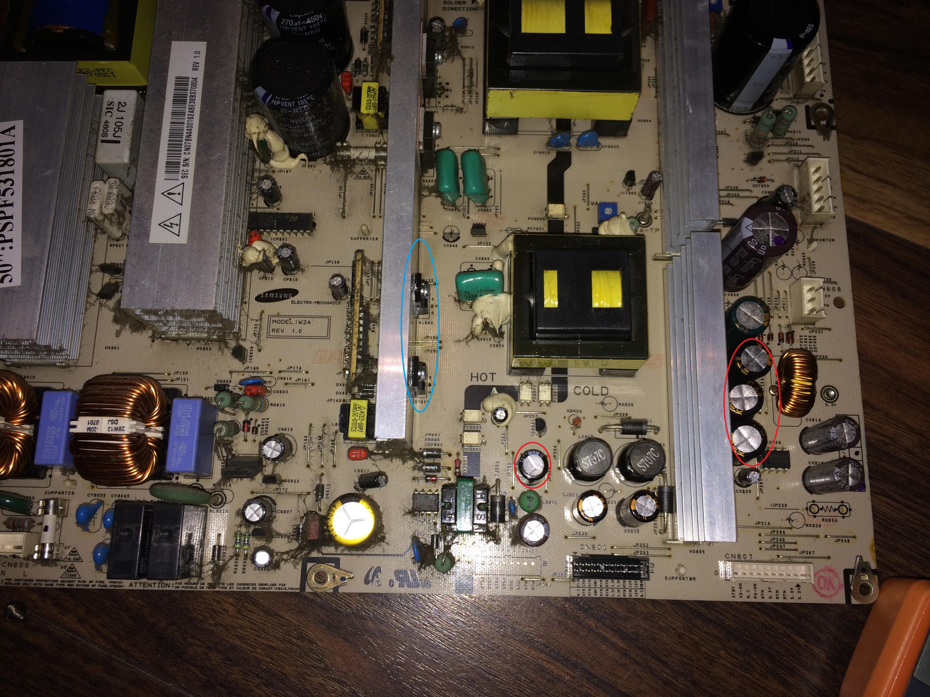

                      OK guys i'm going to (hopefully) bring this thread back to life since i'm having a similar fault on the same board (i.e. the relays clicking and no power coming to the TV).
                      I've followed both nogger and Tom's fault finding guidance as far as measuring the resistance across the FETs. My VS FETs are dead on with 11ohms across them but my VA FETs had been completely blown apart and i replaced them. I'm getting 10Kohm across them both. These replacements are Fairchild FQPF 9N50C FETs on QX801 & QX802.
                      Before i go any further though, i'll go back and explain the fault so far...
                      The TV is my mum's and when the fault started it was just the clicking and the tv still worked then it died completely after a while. They asked me to have a look so after a bit of researching online, the fault seemed like it would be blown caps.

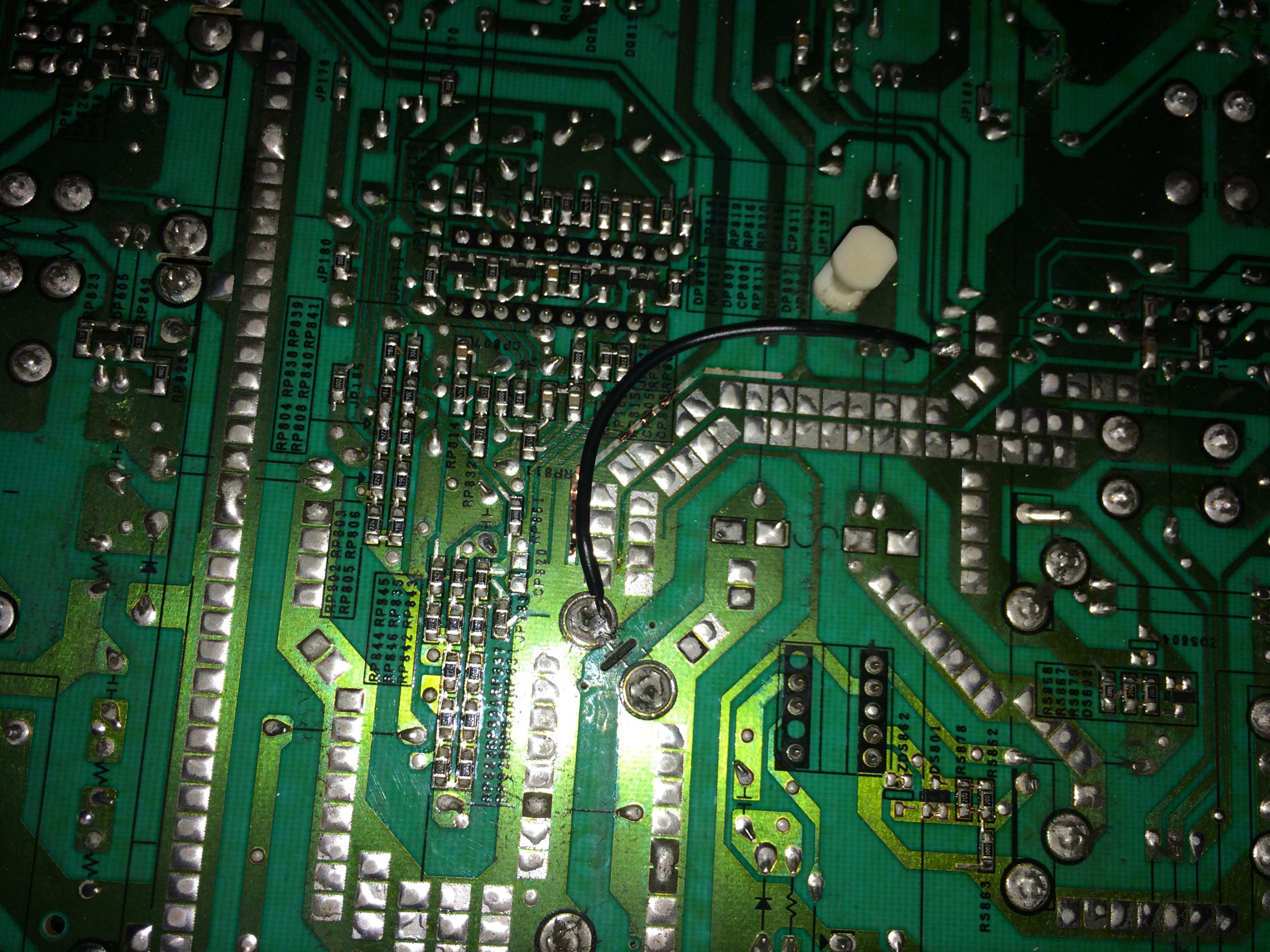

                      I checked it out and there were a few blown caps (which i'll mark on an attachment) and the two VA FETs had blown themselves to bits. There were also some scorch marks on the underside of the board which i'll also include pictures of below.
                      Another strange thing i found, was that one of the tracks coming from one of the big huge caps (CP803) had stripped off a lot of the solder resist and the bare copper was showing and it had also been stripped off in parts. So i've bridged this with a bit of wire between the pin of the big cap to the next solder joint on that track. I did test this cap by sticking the meter across it in ohms to charge it then switching it to Volts DC and it did charge and discharge though i didnt make note of these values and i didn't bother taking it out of the board either but the cap looked ok on the top side so i'm guessing/hoping its ok.
                      The fuses are OK too.
                      So going back to the readings across the FETs being 10Kohm, clearly there must be a problem here! I'm going to go ahead and assume there's a problem with the resistors and those diodes(?) (DX804 and DX803). I can't make out the markings on them to order new ones. Can anyone help me out here?
                      There may also be other issues with this board so if there's anything else i should check out, please let me know! And as with dailafing above there, i'm just a bit of a hobbyist and by no means an expert but i'd really like to fix this thing myself. I do quite a few electronics repairs but nothing too major so it'd be good to bring a TV back to life!
                      Re: the attachments, the caps i replaced are circled in red and the FETs in blue.
                      Thanks for any help anyone can provide!

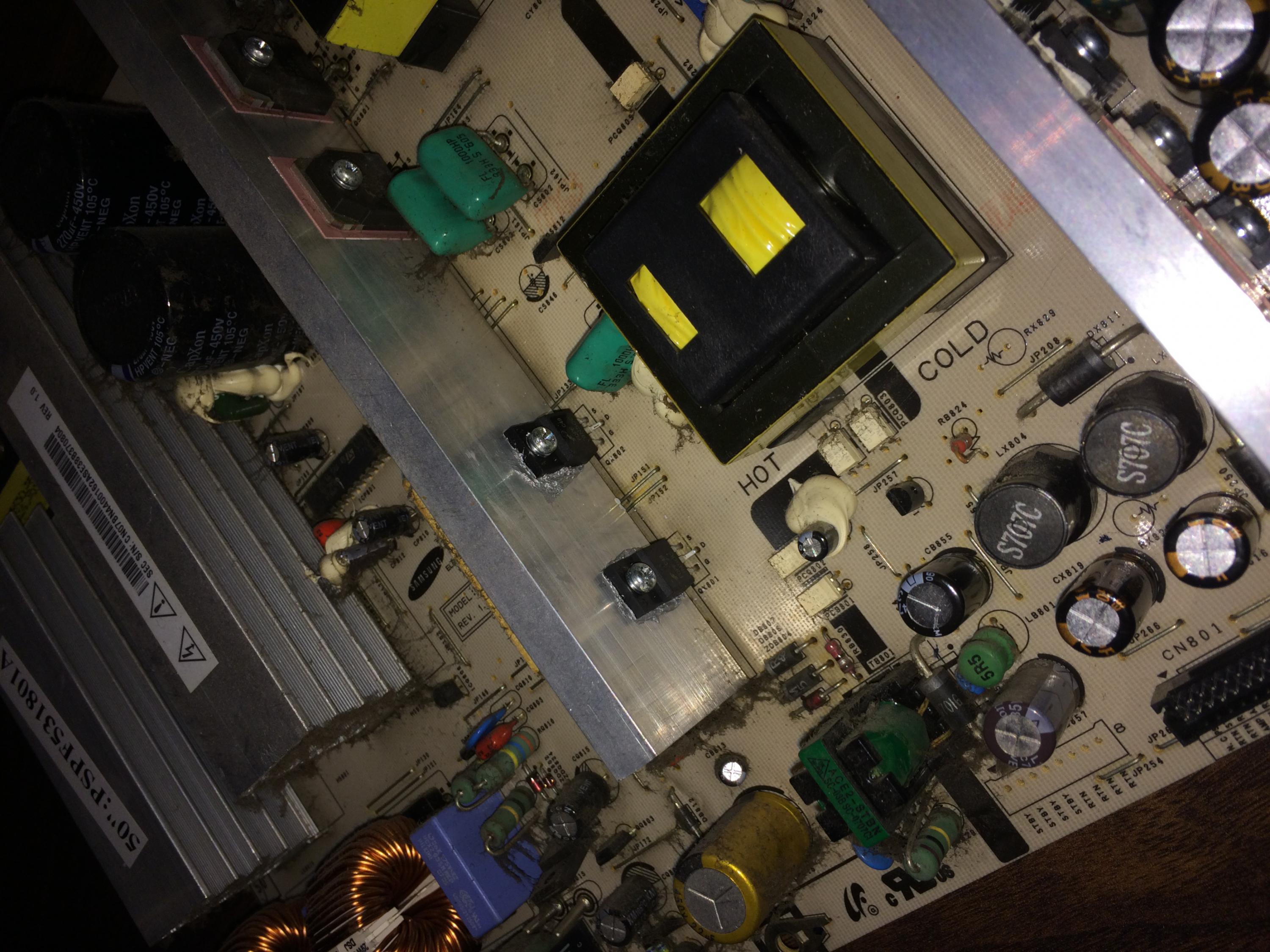

                        I'd be cleaning that board. First thing I notice is it's a 50" Samsung this PSU is from.
                        If it's a 50" TV you're working on then the FETs you used are under rated compared to the originals.
                        F802 T8AH, 250V
                        QS801,QS802 FQA18N50
                        DS801,802 kds184
                        ( RX867, RX869), (RX862 and RX878). 20ohm (2012)
                        RX863 and RX868 10kohm (2012)
                        DX803,DX804 KDS184
                        RX802, RX803, RX832, RX833 100 (2012)
                        QX801 and QX802 FQPF11N50
                        RX804 and RX805 10k ohm (2012)
                        I was making a list for the same board which blew the Va and Vs ccts but I'll probably never get to it.
                        From what I've read and the kits I've seen , the KDS184 diodes will need replacing and there's a few of them under the board.
                        schematic if you don't have it, covers the 42/50" PSUs

                          Oh! Thanks! That's very helpful. I think I'll reorder the FETS, replace the diodes and resistors just to be sure and see how it goes then.
