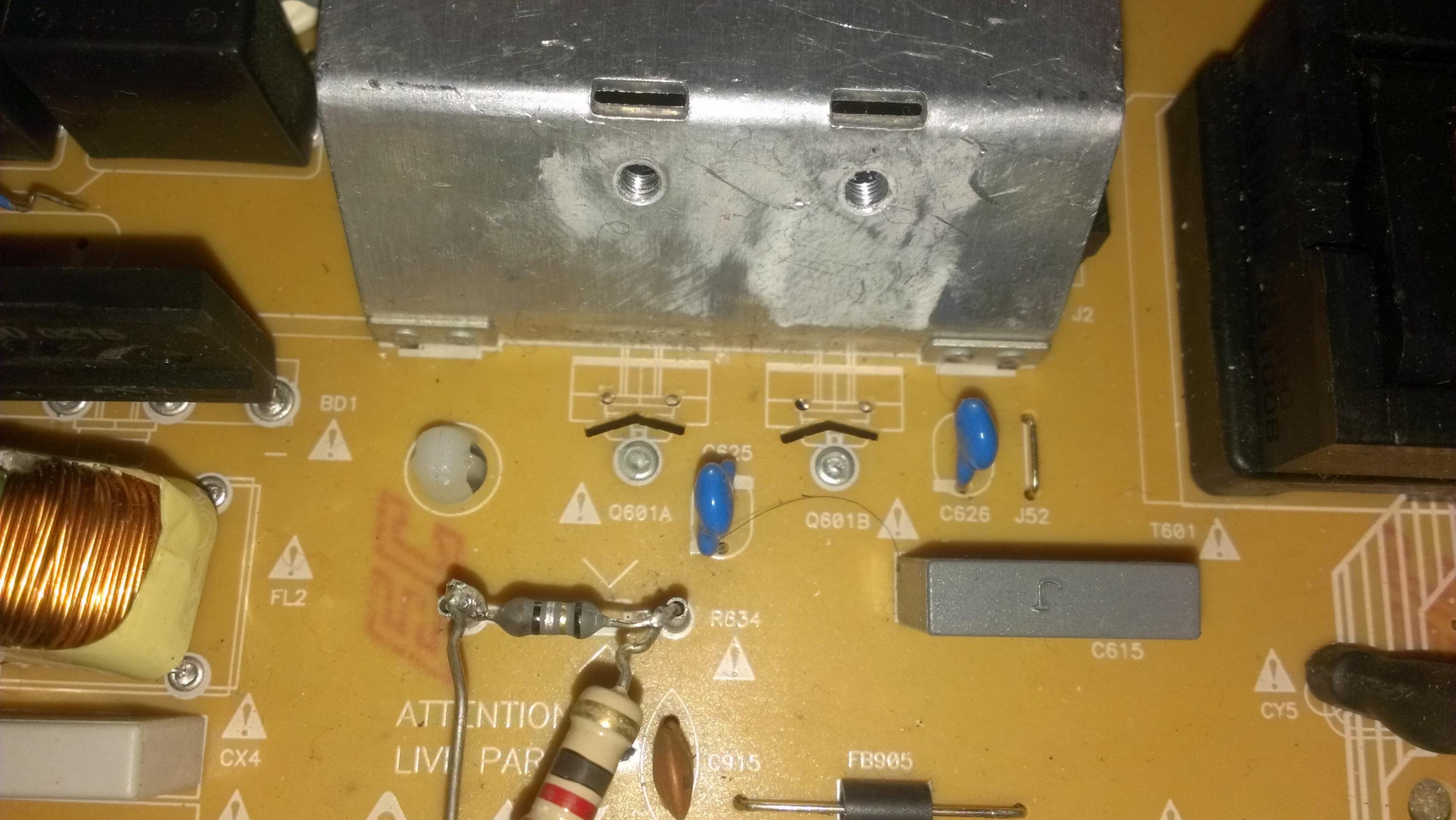

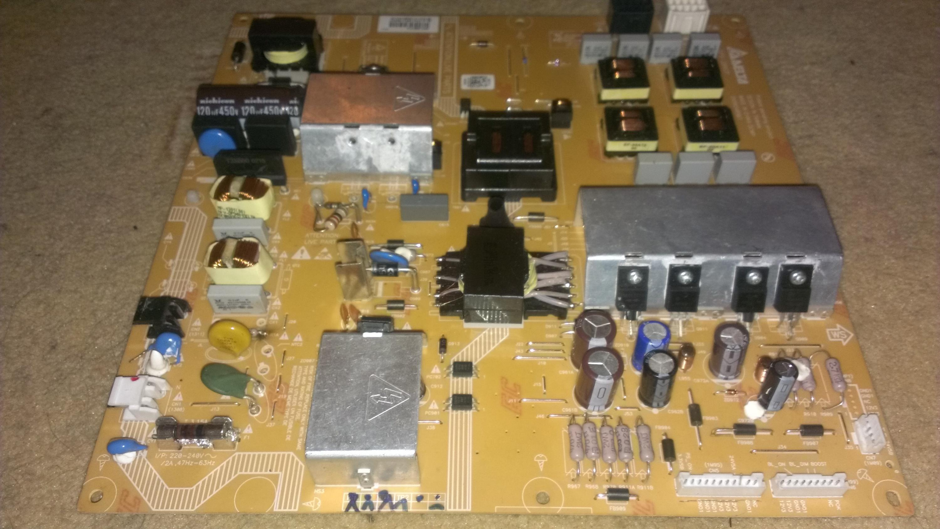

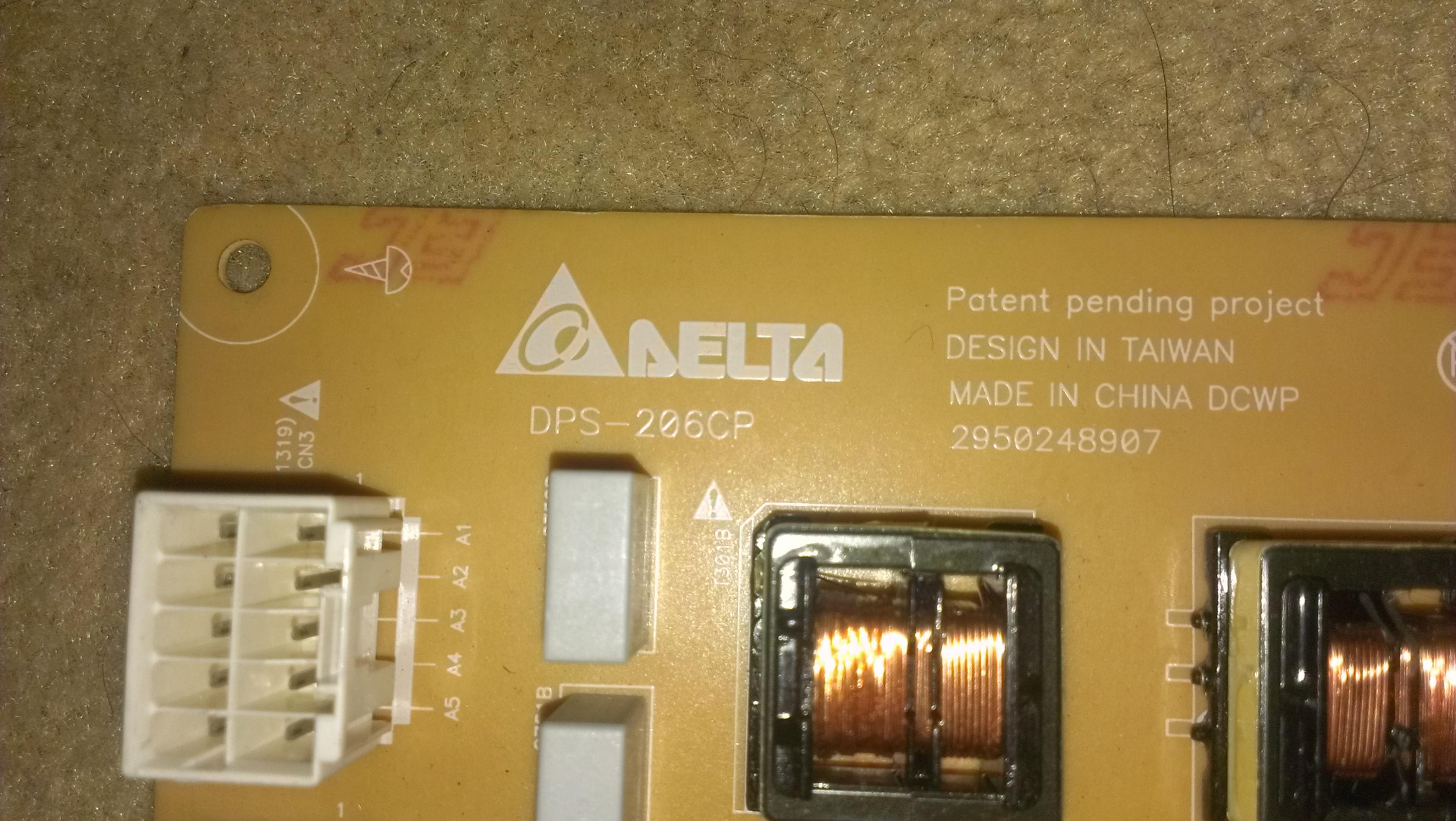

    i am trying to repair this psu which the previous owner has removed two components from and lost them, he promised to find them and send them but it doesn't look like thats going to happen.
    I've found a shorted diode which hopefully is the only fault if i can undo the other damage.
    the missing transistors are q601a and q601b
    does any one have this psu or the circuit diagram?

    Re: philips psu 40pfl5605h delta dps206cp
    the answer is:
    q 601a = 5n60c
    q 601b = 5n60c
