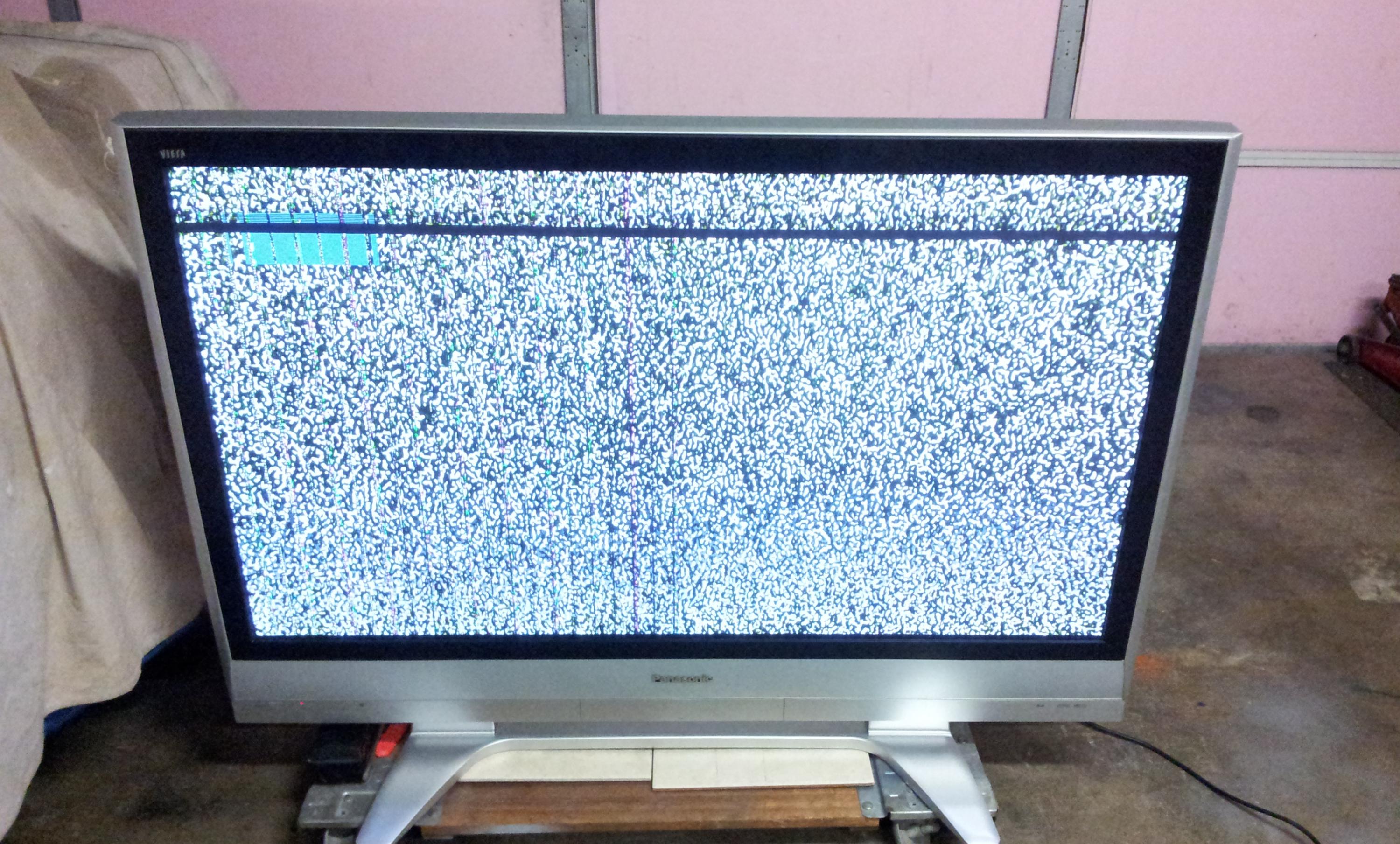

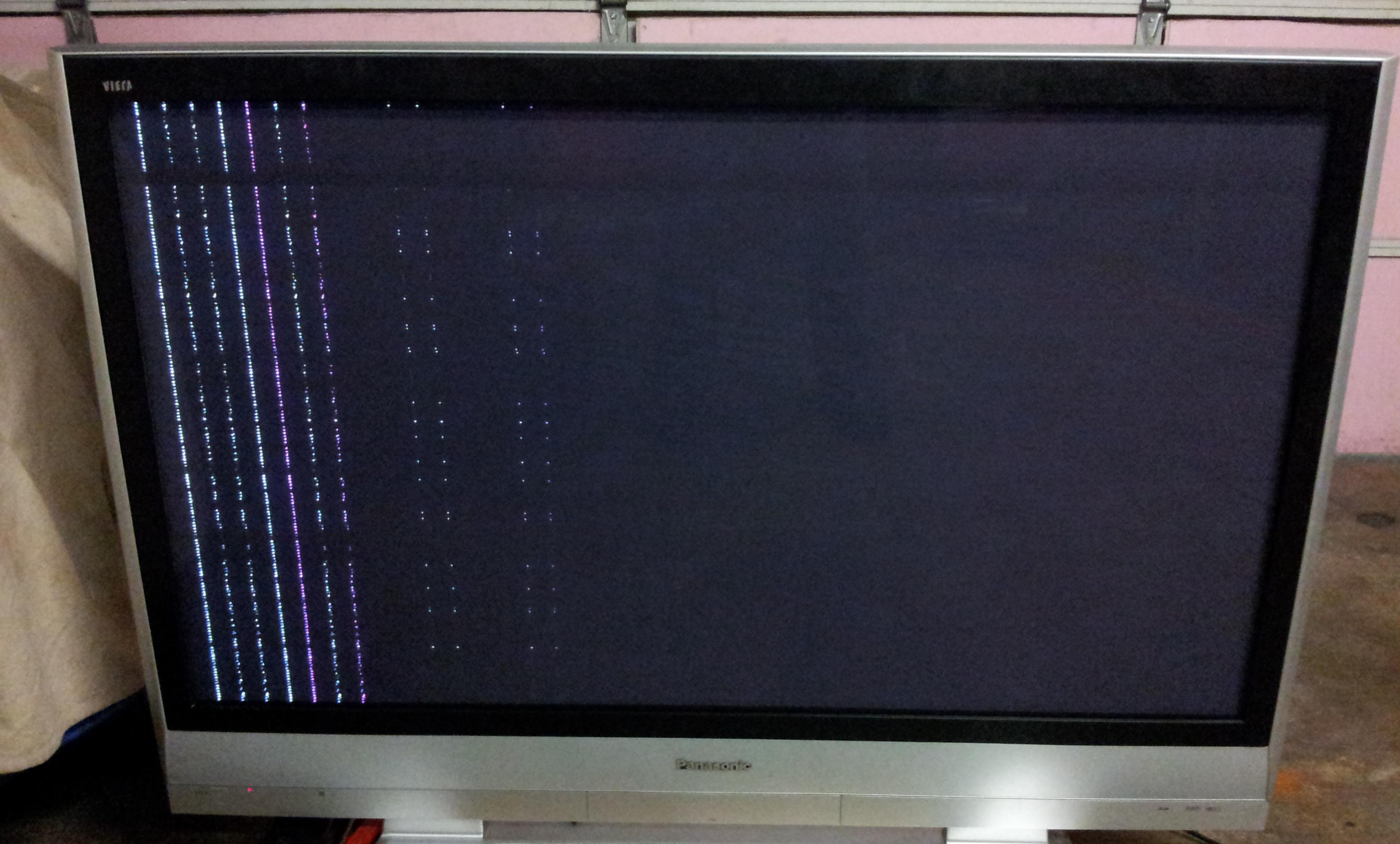

    Panasonic TH50PX60U
    The set has vertical lines on half, I have checked the ribbon cables. The set doesn't have any flashing power LED codes, it powers up and please see the pics below on what it shows.
    Part it, scrap it or move on?
    Re: Panasonic TH50PX60U
    Horizontal line looks like panel fault, but vertical lines could be D board problem. Are you able to access service menu?
    • procharger
      • Jan 2014
      • 13
      Yes, I seen SOS 6 & 8
