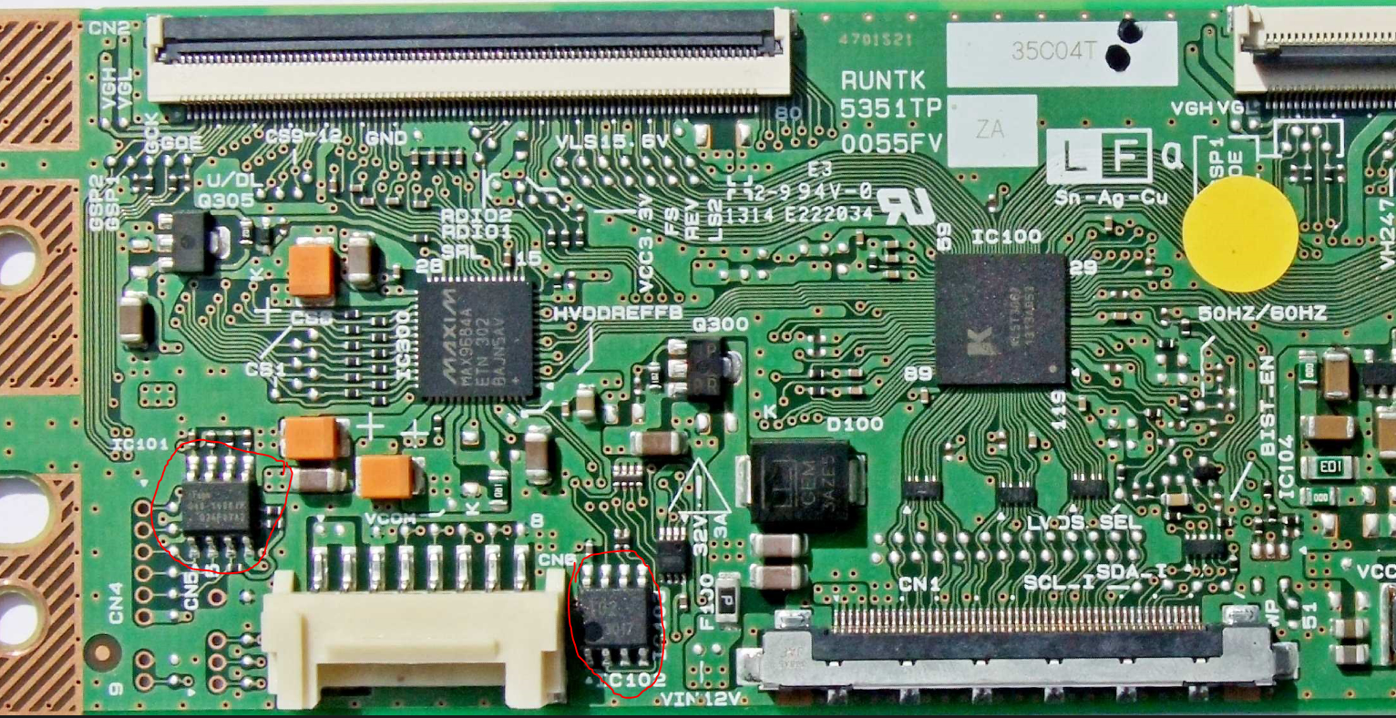

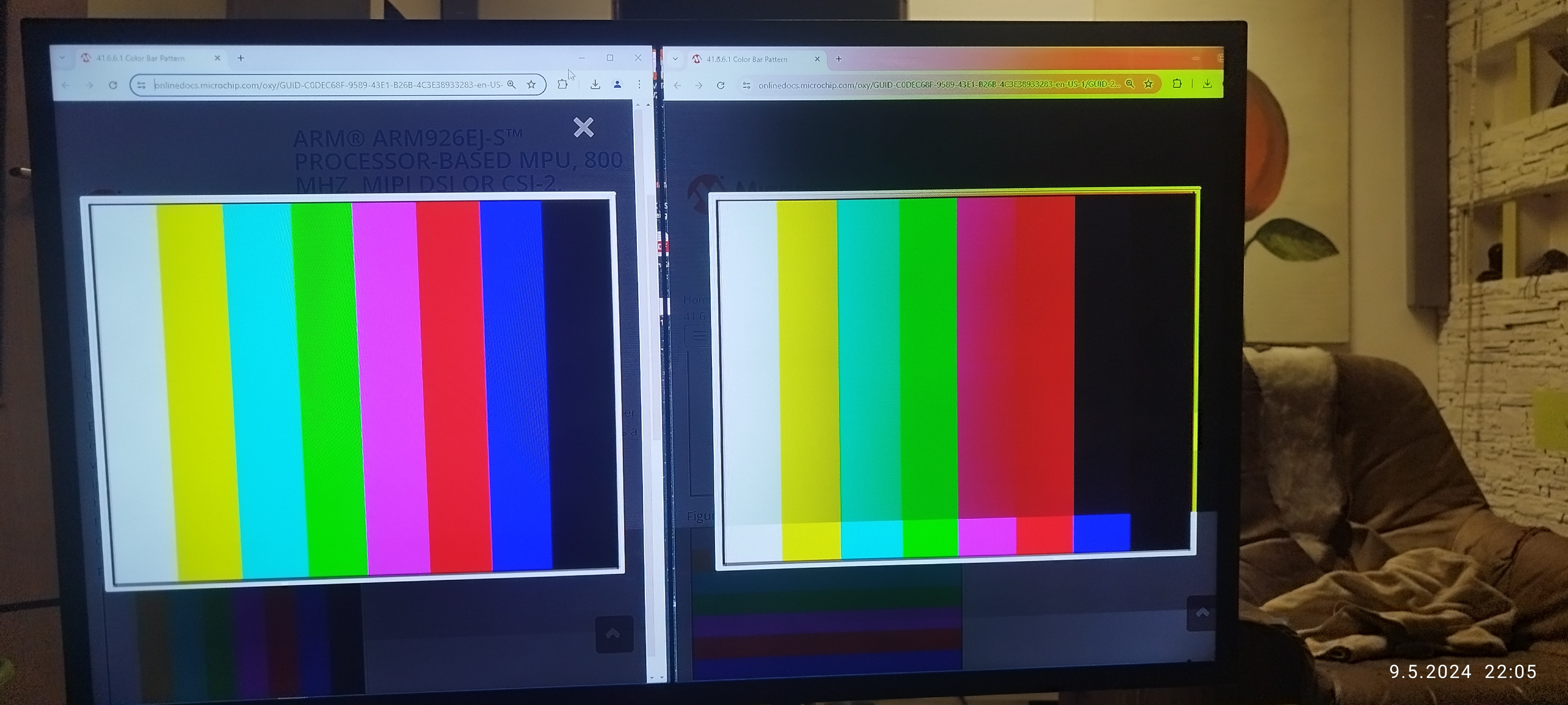

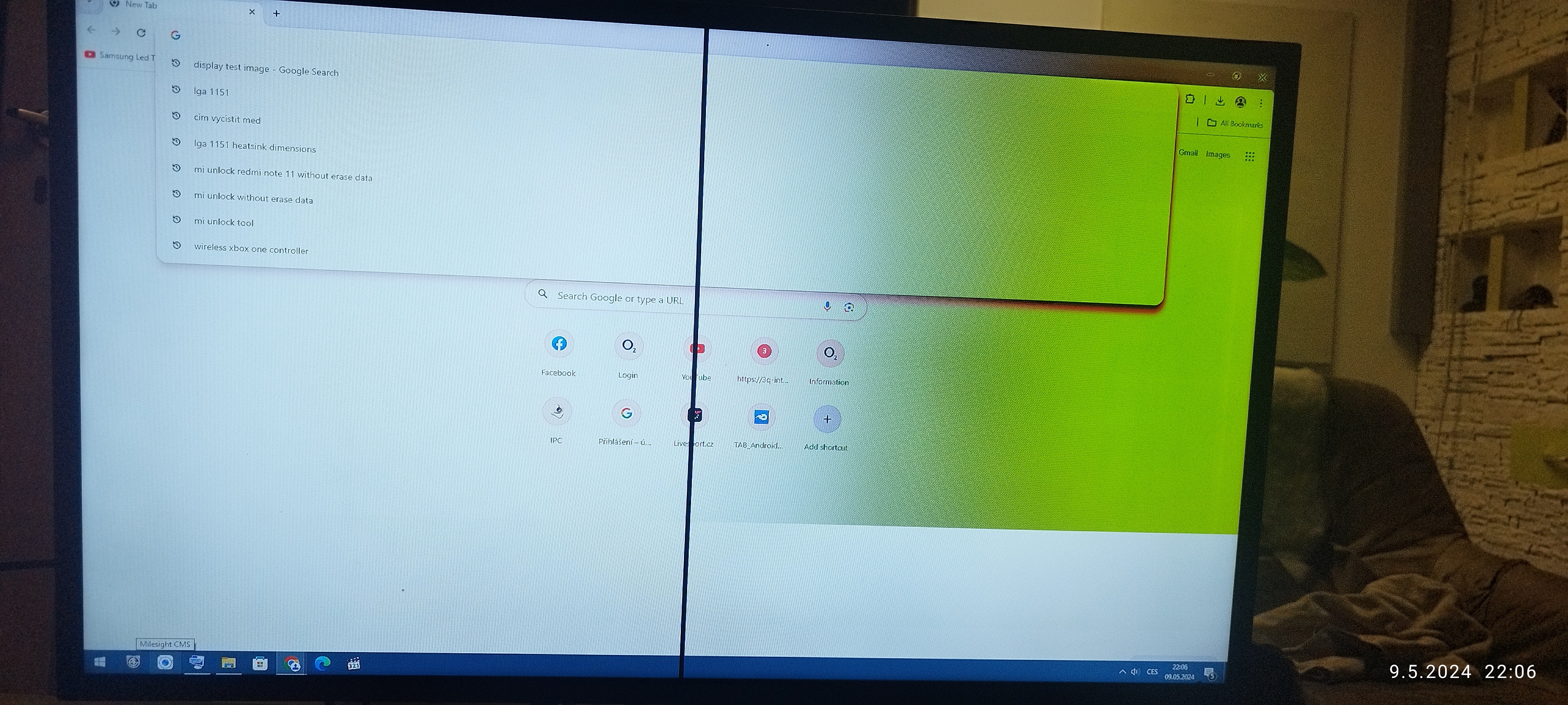

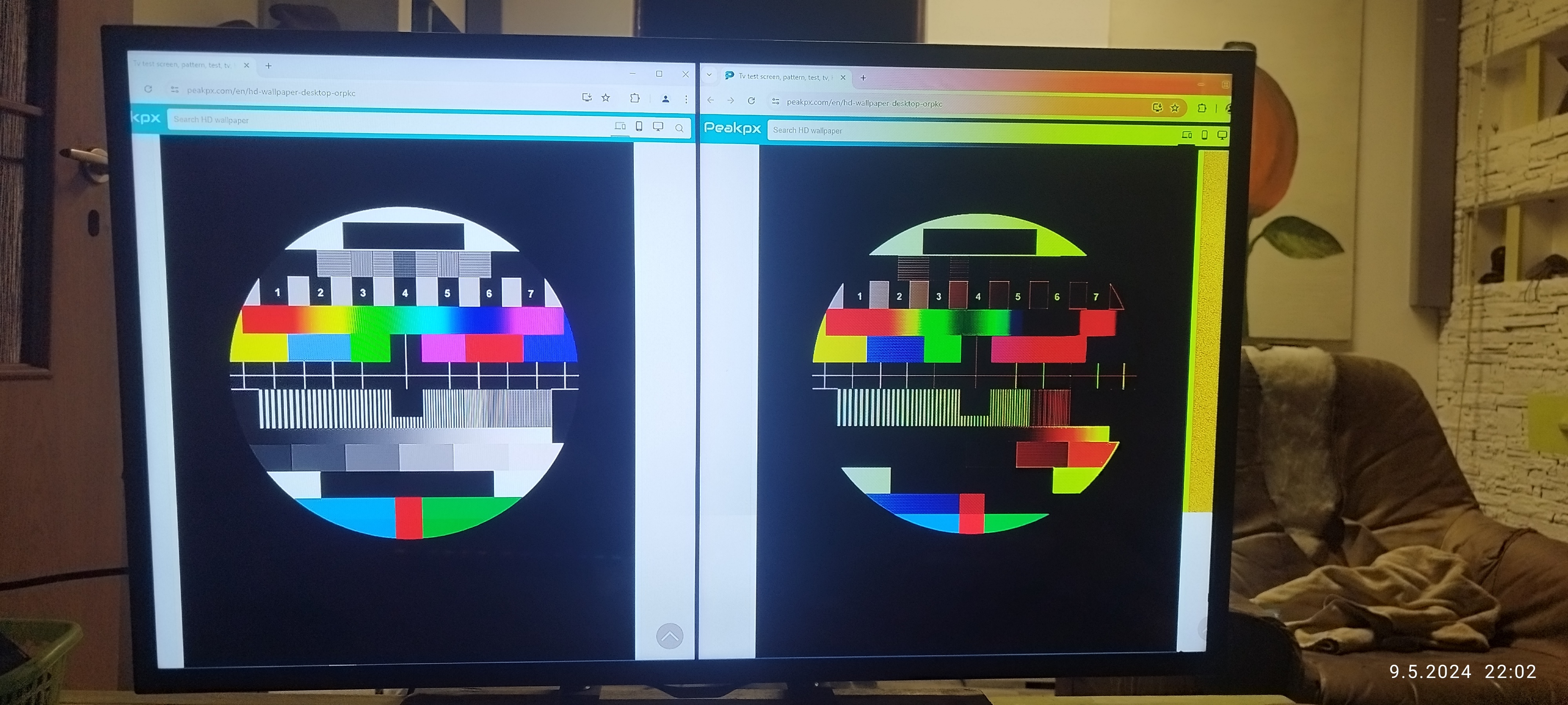

    when I received this TV, there was a faulty T-con (missing all voltages, only 12V OK), black screen, sound OK, backlight OK.. So I replaced the T-con and now it looks like this.. Thank you Very much for any hints, what I must to check or measure etc.. Have a nice day and sorry for my english 🙂

    By looking at the position of your display I can say that the e-prom IC installed in this t con does not have the correct software. Please replace the 8 pin e-prom IC with the old t con board. Your problem will be solved.yo

      What you showed in the photo is a motherboard and a dc/dc converter and it has nothing to do with the T-CON firmware!

        Transplant 2 chips from the native (original) T-con (Spi Flash EN25F40-100GIP and Eeprom 24C02).
