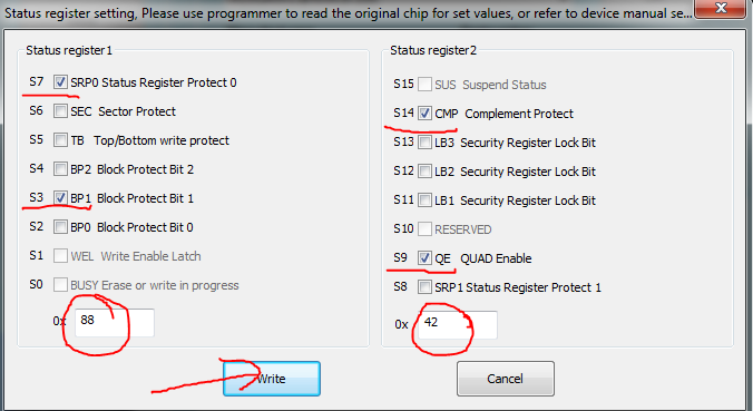

    Hello, i have a TV Samsung UE43MU6105KXXC.
    The TV doesn't turn on and no standby light. The problem started after a power failure
    Could someone please check the file i dumped from 25Q40CL?

      Thank you Lotas. I will test it by using Neoprogrammer.
      Could you please give me some advices? When i push the button write to fix the status registers nothing happens.
      Is this normal?
      With Asprogrammer, it was impossible to tick the box QE when i fix the status registers

        What was supposed to happen? I'm just tired of explaining to everyone how to correctly record a dump on this chassis ("MU series")
        1. First you need to delete all status registers (uncheck all the boxes and click "Write")
        2. Erase the chip.
        3. Write down the corrected dump and check what was written down.
        4. Set the status register (0x88, 0x42), check the boxes and click "Write"
        5. Everything is ready, solder the chip in place.

          Thank a lot for this useful advice.
          I didn't know that i need to delete all status registers before erase the chip.
          I will test this and give you the result
          • Willail
            • Jan 2016
            • 29
            • France
            Hello Lotas,
            I follow your advice for the writing of the chip and the tv starts.
            I use Neoprogrammer. It is impossible to tick QE with ASprogrammer 21013 fix
            You are the best.
            Thanks a lot Lotas
