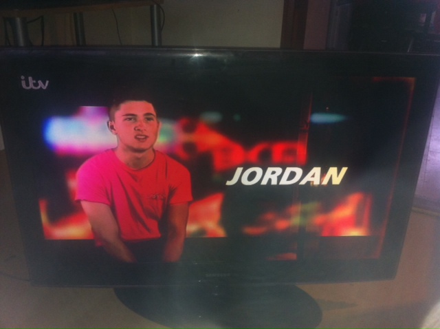

    hi guys got this model but the colours seem bright plus on the right hand side of the screen when the images change they seem to take ages and the original image is still there when it changes
    possible tcon fault ?
    thanks
    Re: Samsung le40a656a
    Panel ... Tab bonds
    Sometimes fixable, but success rate isn't great

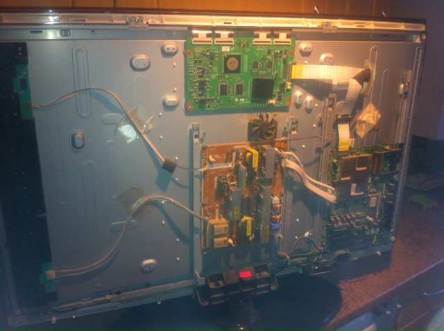

      I have a V3000 with the same issue, I fixed it by using soft yet quite stiff thermal pads cut to the length and thickness I needed, these were from a busted T-con card. As Tom66 has said, very much a hit and miss affair with mine sometimes needing to either warm up for five minutes or a mild twist to get it working properly, stays fine once on and been over a month now.

        Thanks for the help guys strip for parts it is !

            So stripping as we speak
