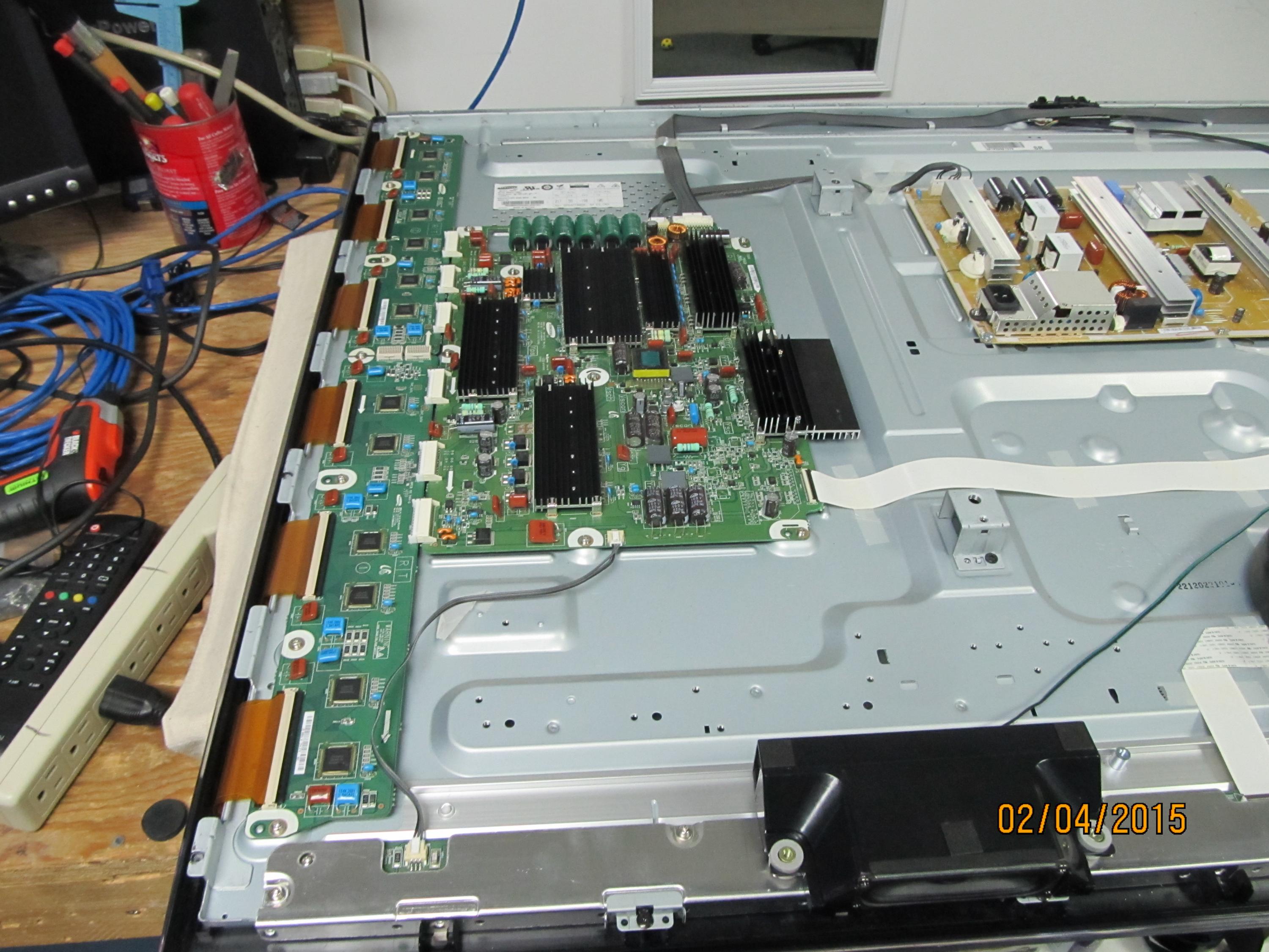

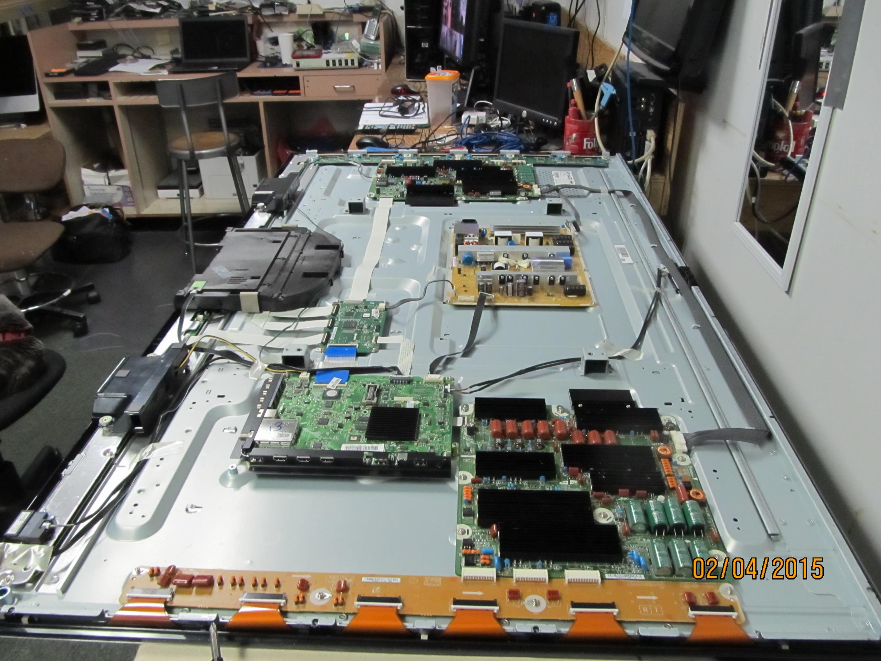

              Re: Samsung PN64E8000 won't come on
              I doubt your new power supply failed again, it is very possible you have a bad Y sustain. What is the LJ92- part number for your Y main? If you could also upload some pictures of the back of the tv, that would help as well.

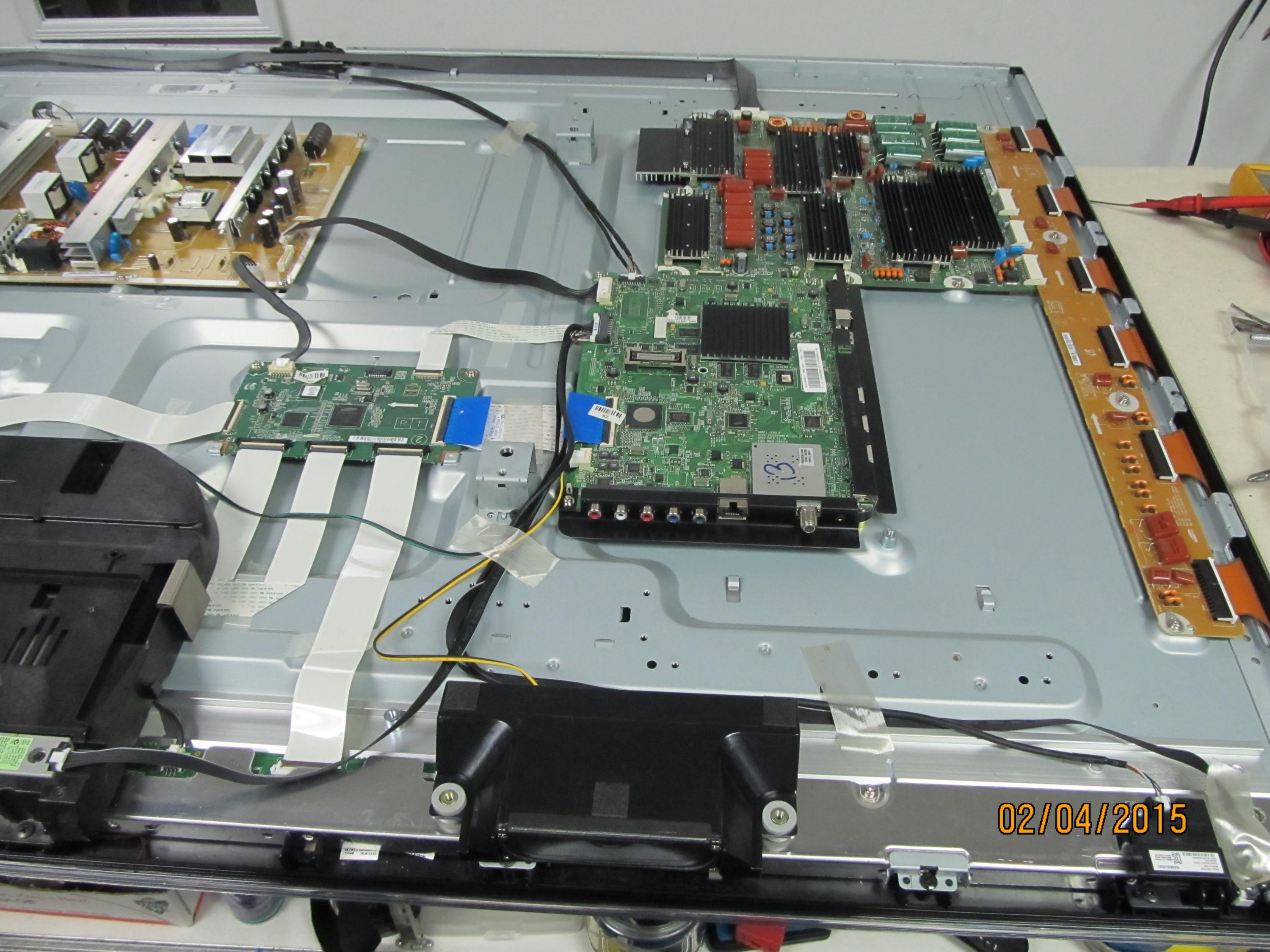

                  Ok picture 2 you have your Y-sustain board and 2 skinny boards called buffers attached to it. So looking at the tv from the back, your Y-sustain board will always be on the left side and your X/Z on the right. After making sure everything has been unplugged for a while, unscrew the Y-sustain and check the pins under that green transformer. I have had a similar model with cracked solder joints on both the Power supply and on the Y-sustain board. If the transformer does not have cracked joints, look at the large diode and transistor pins along with heat sink joints. If still nothing, you could do a quick check on the X/Z sustain for bad solder joints as well.

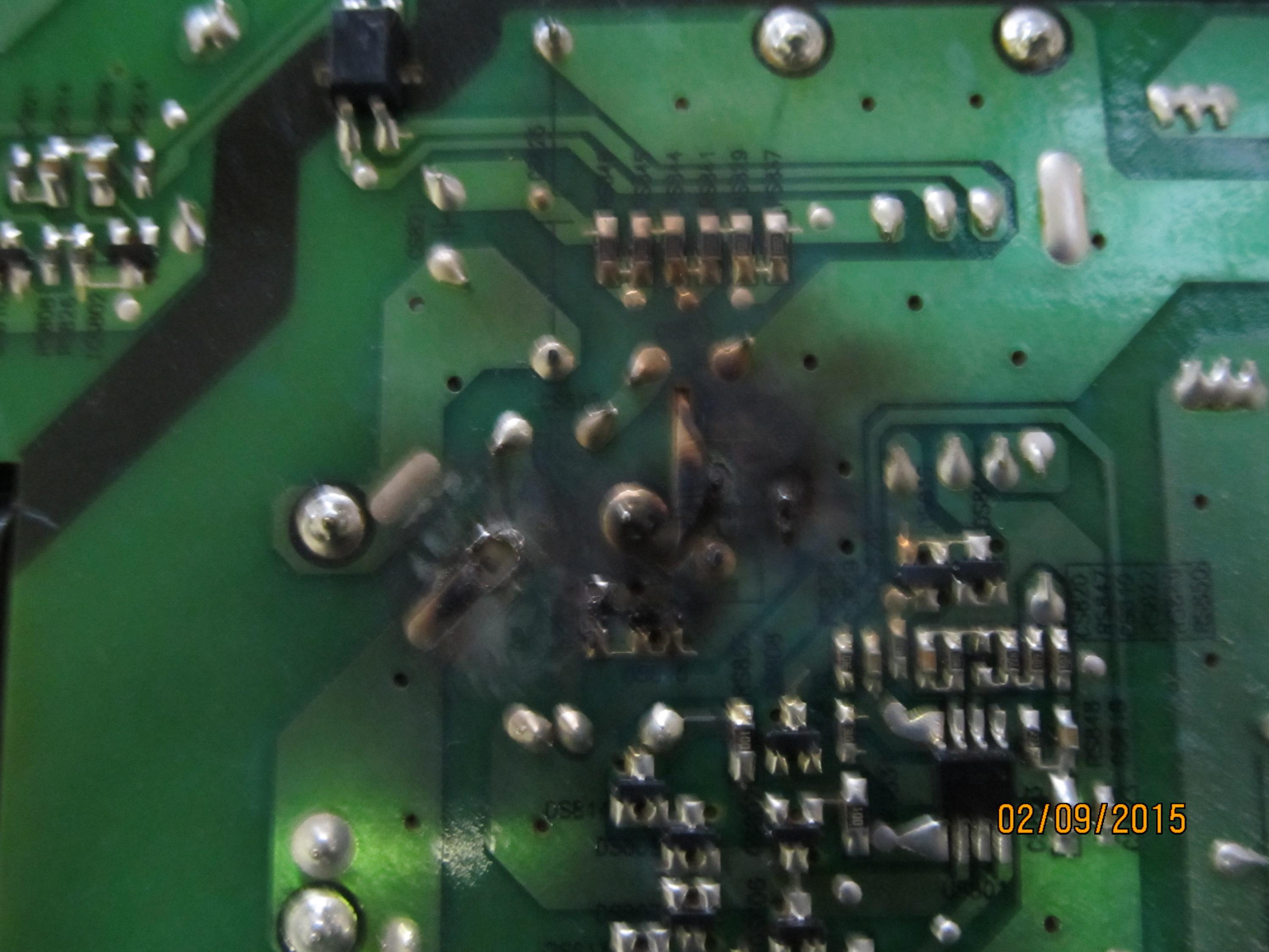

                                  Well, I wish I had pulled the power supply board and looked. It has burnt traces and a blown transistor QS810. Anyone know the value of it>
                                    The PN of it is written ln the front of it. IMO as your not that experienced I would recommend you replace the whole PSU as that transistor going bad could have damaged alot of other things.
