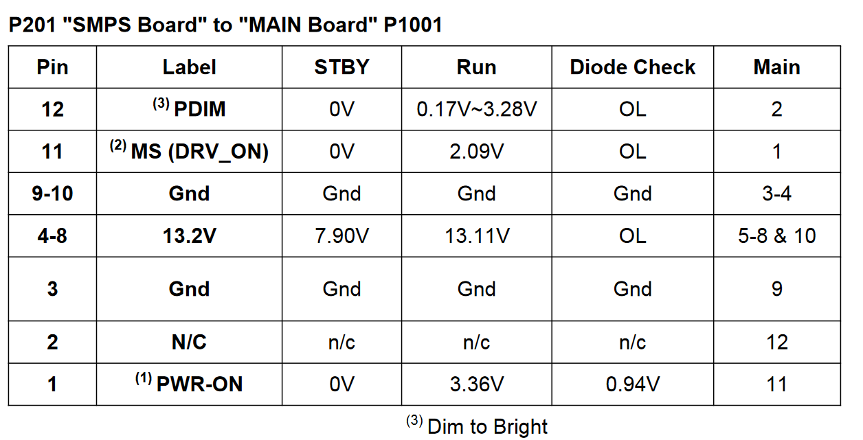

LG 49LJ550M-UB Looking to do some mods
  • Diah
    replied
    Originally posted by KxngCrooked8
    So, I was able to get my hands on a small variable voltage power supply. I hooked up 3.3V to PWR_ON, DRV_ON, and PDIM pins and the LEDs are still flickering. Plus, I'm getting the 105-110V at the LEDs which, according to the service manual I have, says that happens when the TV is in STBY mode. I'm not sure if that has something to do with the flickering. Any other ideas as to why the flickering may occur but only when powering it with my power supply? It still works fine for 15-20 mins if I plug the cable back into the main board.
    If I can't solve the flickering, I'll probably go the dummied video in route using some HDMI signal generating device.
    external power supply.. cant be used.. it had different Ferq as yours PSU.. this why we use step down circuit get fed from PSU and it out put will be same Freq.
    Leave a comment:
  • KxngCrooked8
    replied
    So, I was able to get my hands on a small variable voltage power supply. I hooked up 3.3V to PWR_ON, DRV_ON, and PDIM pins and the LEDs are still flickering. Plus, I'm getting the 105-110V at the LEDs which, according to the service manual I have, says that happens when the TV is in STBY mode. I'm not sure if that has something to do with the flickering. Any other ideas as to why the flickering may occur but only when powering it with my power supply? It still works fine for 15-20 mins if I plug the cable back into the main board.
    If I can't solve the flickering, I'll probably go the dummied video in route using some HDMI signal generating device.
    Leave a comment:
  • Diah
    replied
    Originally posted by KxngCrooked8
    [USER="303198"]thank you for the input. I'm currently using 2 x AA batteries to provide 3V as the signals as that is something I read in an LG service manual for testing backlights. If I need 3.3V, is there a relatively simple way to accomplish that using the voltages on the board already with some additional components? I'm going to look up the step down circuit but I'm a relative novice when it comes to designing electronic circuits.
    Step-Down-Regler i use in hand always TS2596CM533, just because i can have out pot of many range V. but you can use only for 3,3V .. the out put put in Cap filter 22000uf 25V
    Leave a comment:
  • maneatingmonkey
    replied
    What I was getting at is that it might be possible to make a dummy plug to trick the TV to thinking there's an input. Or just repurpose an old Chromecast or Android TV box. Actually you could probably just plug in a USB with a JPEG and put the TV on slideshow mode.
    But if you did want to hack the hardware, it would make more sense to find the power on signal on the motherboard and tie that to high if you are keeping the mobo in place. Otherwise remove the mobo and drive DRV_ON and PDIM directly.
    Leave a comment:
  • KxngCrooked8
    replied
    maneatingmonkey I appreciate the input. I'll try sending the 3V to the PDIM pin as well and see what happens.
    The reason that I want to bypass the signals is for the auto shutoff. You are correct that I could plug in a video input, but I'm hoping not to do that. I plan to mount this on a wall as a false window of sorts (my apartment only has windows on 1 side and having a more natural source of light from the other side will be nice) eventually nowhere near any video inputs. Additionally, this is just a fun little project for me to tinker around and try to learn a little bit.
    I do plan on using the mainboard for the audio yes. I have a component to 3.5mm adapter and have the TV set to component input. With my testing, just the audio signal isn't enough to keep the LEDs on. I'm hoping to keep using the mainboard, while cutting the wires that are sending the signal I'm trying to emulate. Then I'll wire a small power supply into those signals to provide that signal constantly and hopefully keep the LEDs on. I'm hoping to use a variable voltage power supply for the PDIM signal as well to be able to vary the brightness.
    Diah
    thank you for the input. I'm currently using 2 x AA batteries to provide 3V as the signals as that is something I read in an LG service manual for testing backlights. If I need 3.3V, is there a relatively simple way to accomplish that using the voltages on the board already with some additional components? I'm going to look up the step down circuit but I'm a relative novice when it comes to designing electronic circuits.
    Leave a comment:
  • maneatingmonkey
    replied
    Originally posted by KxngCrooked8
Name:	image.png
Views:	206
Size:	83.9 KB
ID:	3245542 ​
    Would a lack of PDIM signal cause flickering LEDs? Still open to any ideas.
    Yes a lack of PDIM signal could absolutely be causing the flicker.
    But TBH I'm not sure why you want to bypass the signals from the mainboard if you want to use it anyway for audio. Unless a sleep timer has been specifically set, the screen shouldn't turn off so long at there is a video input connected.
    So hook up a laptop to HDMI1 and load up a 10 hour YouTube video, making sure the PC audio is set to TV speakers. You can the change the input on the remote either by pressing SOURCE, DOWN, ENTER repeatedly (if the selection starts from the current source), or doing the same thing but each iteration pressing DOWN an additional time (if the selection starts from the top each time).
    Leave a comment:
  • Diah
    replied
    well you have Video Out put on the mainboards which you can plug any other Tv or monitor to see the menu.
    if you want to ignore the MB. then you need to Diy step down circuit to have 3.3V from yours PSU fed it to Power_ON and Drv_ON and Pdim...
    Leave a comment:
  • KxngCrooked8
    replied
    I wish it were that easy. The reason that I am doing this project in the first place, is because the LCD screen is broken. So I can't see any of the menus to adjust things. I also tried to mess with the settings when the TV did work and I could never get it to stay on indefinitely. It would always timeout/go into standby after some amount of idle time.
    I would also like to carry out these mods so that I can eventually use a variable voltage power supply to adjust the brightness of the LEDs.
    Leave a comment:
  • Diah
    replied
    Originally posted by KxngCrooked8
    Diah
    I'm not sure what you mean by "check the LED BL if one turn off". Sorry. Could you explain a little more? The LEDs come on just fine if I power up the TV normally using the logic board. The issue is that the LEDs won't stay on for an unlimited amount of time. Something in the logic of the TV is shutting down the TV after some amount of idle time (seems to be 15-20 mins).
    forget what i wrote,, when you have working LED with MB connected... turning off because No signal. of course this function can turning it off from setting menu.
    Leave a comment:
  • KxngCrooked8
    replied
    Diah
    I'm not sure what you mean by "check the LED BL if one turn off". Sorry. Could you explain a little more? The LEDs come on just fine if I power up the TV normally using the logic board. The issue is that the LEDs won't stay on for an unlimited amount of time. Something in the logic of the TV is shutting down the TV after some amount of idle time (seems to be 15-20 mins).
    Leave a comment:
  • Diah
    replied
    okay, since the screen out.. check the LED BL if one turn off.. this could be the reason.
    other wise as you said you want to use the audio... then keep the TV work as normal just with out screen...no need to do jumpers mode in case yours mainboard working
    Leave a comment:
  • KxngCrooked8
    replied
    Diah
    What I'm looking to do is to modify/augment the wiring of the TV to allow for the backlights to come on and, if possible, still retain use of the audio input via the component ports on the logic board. What I've done is removed the case of the TV and the LCD panel. I am working on building a "window frame" to put the remains of the TV into. Then I will hang the "window" on a wall of my home in order to provide soft light into my home. Does that make more sense?
    So far I've gotten the system/LEDs to power on using my little 3V jumper, but I can't get the LEDs to come on and stay on. They just flicker constantly. any input on to why this may be happening would be helpful.
    The audio side of things I'm not as worried about as that seems to work with or without my mods.
    Leave a comment:
  • Diah
    replied
    @KxngCrooked8
    what do you mean with "" I'm looking to convert into a light source/audio player.​"" ?
    could you explain the mode you are trying in more detail ?
    LG LED BL are critical as they used LED units build in zener diode
    Leave a comment:
  • KxngCrooked8
    replied
Name:	image.png
Views:	206
Size:	83.9 KB
ID:	3245542 ​
    Here is a table showing the expected voltages at each pin.
    I plugged the cable back into the logic board, powered up the unit, and took a voltage measurement at the MS (DRV_ON) pin. It was reading ~3.1V.
    As I'm looking at this again, I was jumping 3V to pins 1 and 11 (PWR_ON and MS (DRV_ON)). That means that I'm not pushing 3V to pin 12 (PDIM). Would a lack of PDIM signal cause flickering LEDs? Still open to any ideas.
    Leave a comment:
  • maneatingmonkey
    replied
    DW about measuring the current. For a 3V digital signal the midpoint is 1.5V, so theoretically any voltage above that should be treated as ON an anything below that should be treated as OFF. It's a little more complicated than that in practice, so I wouldn't rely on using on one battery.
    As for why the LEDs are flickering, I'm not sure. Does the service manual say anything about the MS pin? What voltage does it read when connected to the mainboard?
    Leave a comment:
  • KxngCrooked8
    replied
    I was able to measure voltage across the batteries. They are outputting 3.1V. I also verified that the 3.1V is making it to both the PWR_ON and the PWIM pins on the power board. This is true both when A/C power is connected and when it is not. I am not sure of how to measure the current. My electrical skills/experience are somewhat limited. I've only ever measure current with a clamp and I don't have one of them. I could possibly borrow one from work but will need to check. Since power is ultimately tied to both voltage and current, I assume the correct voltage with not enough current could also cause a lack of sufficient power to the LEDs?
    Update: decided to try running it with only 1 AA battery, giving me an output of ~1.6V. When I do that, the LEDs still come on and flicker. I find this interesting because this means that the PWR_ON pin is also only getting 1.6V, yet everything is still turning on. I also measured the voltage going to the LEDs for both 1.5V and 3V input signals. I was surprised to find that they were the same: fluctuating between 105 and 110V. If I'm remembering correctly, when I tested the power to the LEDs with the cable connected to the logic board, I was getting ~130V.
    Any thoughts? I'm honestly lost as to what is happening.
    Leave a comment:
  • maneatingmonkey
    replied
    Hey, so backlights on a TV are controlled by a PWM signal, whereby 50% duty cycle corresponds to 50% brightness, etc. You can't accurately measure this signal with a multimeter. A reading of 2.2V would correspond to a 3V signal at 75% duty cycle though. (Mathematically, it could also be a 220V signal at 1% duty cycle, but since PWR_ON is supposed to be 3V, we can assume a common signal voltage level).
    So if you wanted to run your TV at max brightness, in theory all you need to do is supply a constant 3V DC to PDIM. I'm not sure why this isn't working for you. Can you measure the voltage across the batteries under load? And maybe also the current being drawn from them?
    Leave a comment:
  • KxngCrooked8
    replied
    I came across a service manual for my TV model that explains how to test the LEDs by using a 3V power supply (in the form of 2 x AA batteries) and connecting that 3V to PWR_ON and to PDIM with the ground going to PIN3. When I do that, I am able to get the LEDs to come on, but they flicker. Based on some measurements that I took before I disconnected anything in the TV, the PDIM was ~2.2V when the LEDs were being turned on by the logic board. What I'm assuming is happening is that 3V is a bit high and the power board isn't able to output that amount of power continuously. I'm hoping that I can drop the voltage on my AA power supply to ~2.2V and try again to see if that solves the flickering issue.
    I'm open to ideas on if that sounds like the right track. Or to what you may think the flickering issue is caused by and how to solve it.
    Thank for responding!
    Leave a comment:
  • maneatingmonkey
    replied
    How are you driving the PWR_ON signal? That should also be around 3.3V, no?
    Leave a comment:
  • KxngCrooked8
    started a topic LG 49LJ550M-UB Looking to do some mods
    LG 49LJ550M-UB Looking to do some mods
    I have an old(er) LG 49LJ550M-UB that I'm looking to convert into a light source/audio player.
    The only issue I'm currently experiencing is that I can't get the LED's to stay on permanently. I still have the intact LCD panel and have fiddled with all of the settings trying to get the LEDs to stay on with no luck. In lieu of that working, I'm hoping to trick the power board into keeping the LED's on. I think that I've found the correct signal that I need to send, >3V to the PDIM pin on the P201 connector on the power board. But I'm not sure where to grab that voltage from as most of the voltages on that connector seem to be 13.2V. Is there something simple I'm missing? Is there an easy jumper I can install or component that can be added to force the LEDs to stay on?
    I've attached pictures of the power board for reference.
    Thank you,
  • Pipolups
    Corsair K70 LUX RGB dying LEDs
    by Pipolups
    Hi there !
    I'm having an issue for several weeks with my quite old K70 LUX RGB keyboard. I haven't used it for few months, and once I setup up again my desktop computer, I got several dead LEDs on that keyboard. I tried the Corsair troubleshooting thing (disabling options in iCUE, ...) but nothing changed so I conclude that for some reason some LEDs went in retirement...😅
    Decision taken to change these LEDs as I have access to desoldering iron and binocular magnifier, I wrote a ticket to tech support, hopping to obtain the LEDs reference and... They refused to tell me 🙄...
    10-08-2024, 11:58 AM
  • THE GTC
    Insignia NS-37D20SNA14 intermittent LEDs
    by THE GTC
    So I use this TV daily as a second monitor for my PC or my Playstation - at one point a few months back I tried to fix the problem - but in the process, I figured out something that works so I haven't posted this for awhile. It is an annoying trick to have to do though, so I decided to post about it to see if anyone could spot what's wrong. It baffles me because it works on it's own half the time.
    When I first got this TV, I was told it wouldn't turn on, and of course I did the flashlight test, and the image was there. Also, the red LED on the front indicated that it had power (it...
    11-03-2020, 02:40 AM
  • VitalComputing
    Replacing Mode Indicator LEDs
    by VitalComputing
    I have what should be a simple job but is causing me issues. There are three LEDs (yellow, green and red) on the indicator panel of a solar PWM controller and these have broken off. I need to replace them but I am unsure of the voltage drop across these. I don't want to replace with random LEDs in case they blow.
    I took one of the LEDs out of circuit, put 19V across it with a 500 ohm resistor in series and there is a drop of about 13V across the LED, and this seems to increase as I increase the input voltage.
    I thought I could just put a resistor...
    09-17-2023, 04:43 PM
  • Maxim Bojko
     Palit RTX 2080 Super Jetstream Mats/Mods help
    by Maxim Bojko
    I have a RTX 2080 that is broken, but interesting thing is that the card works how it should work, but when playing the card crashes, black screen fans go to 100% and nothing happens anymore. I changed thermal paste because I thought it was overheating, but no. So I checked with gpu z and here is what I had.
    After a while a dude I got friends with told me to underclock the gpu via msi afterburner. First to underclock the core speed by 200 then open the chart for the mhz and voltage and said that I should change the mhz at 0,9v to 1900mhz. Since then I doesn't crash...
    09-18-2024, 04:18 PM
  • jimbofz
    just a quick question do all qled leds appear blue when fault finding ?
    by jimbofz
    i have replaced many leds strips that have changed blue when they are worn
    and the new replacements are perfect white
    but when fault finding do quantum leds always look blue?
    08-28-2024, 06:51 AM
