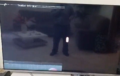

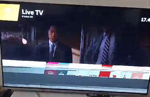

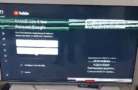

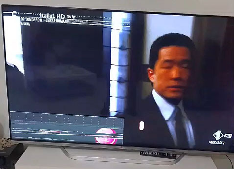

    Hi everyone,
    For some time now my LG TV has had this defect. I turn it on and strange horizontal lines and video artifacts such as overlapping of parts of the image start to appear. The defect only occurs when it's cold, as soon as it heats up it works normally.
    I attach video
    Sorry for my English, I use Google Translator

    can't you upload to youtube? Or post a couple of photo..

      Hi, I'll post 4 images

          Try reseating many times the lvds cable, otherwise i guess bad cpu soldering..

            So I guess it's the second option since when it heats up the defect disappears.
            However, as soon as I have some time I'll test it. Thank you​
