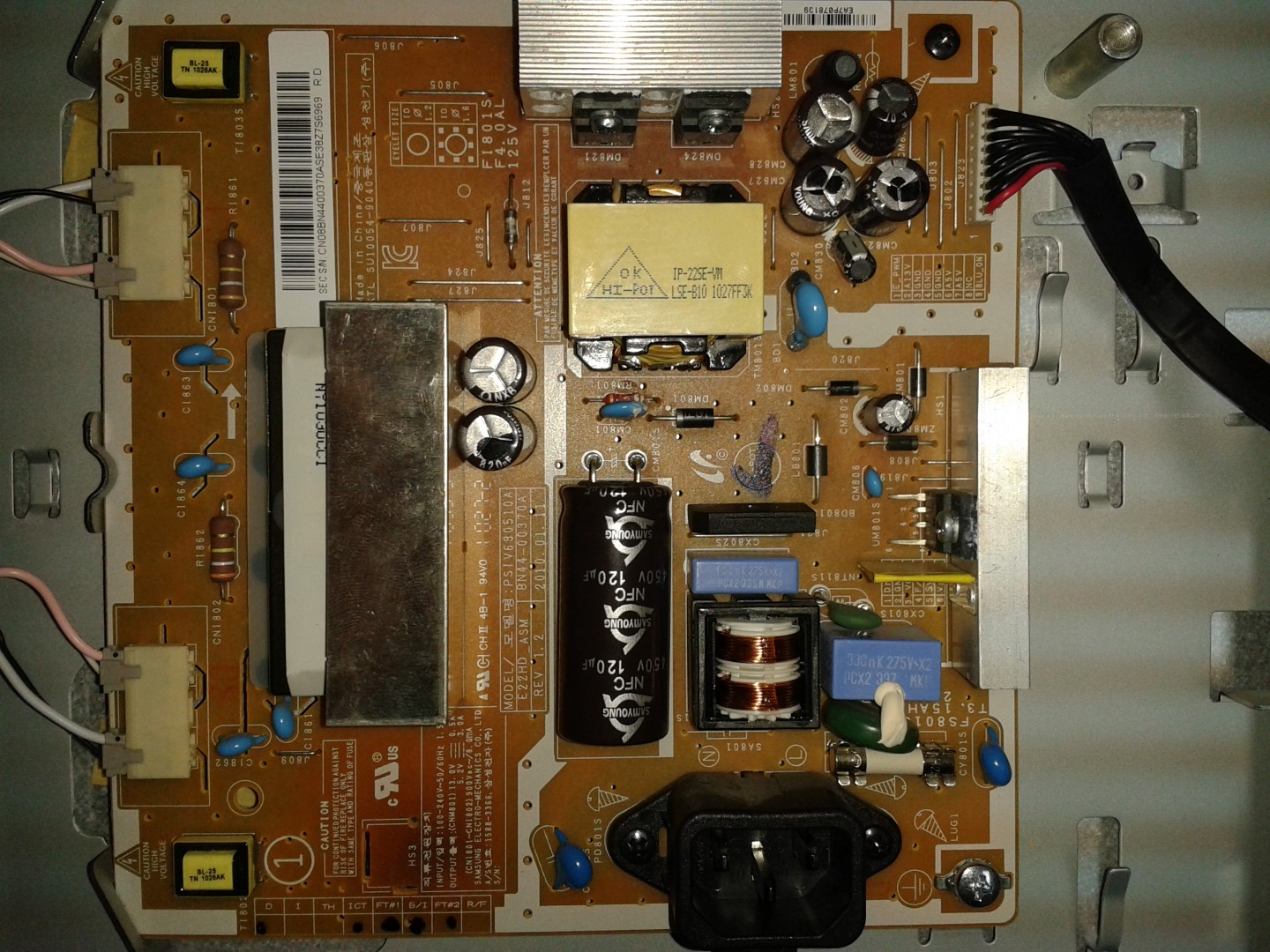

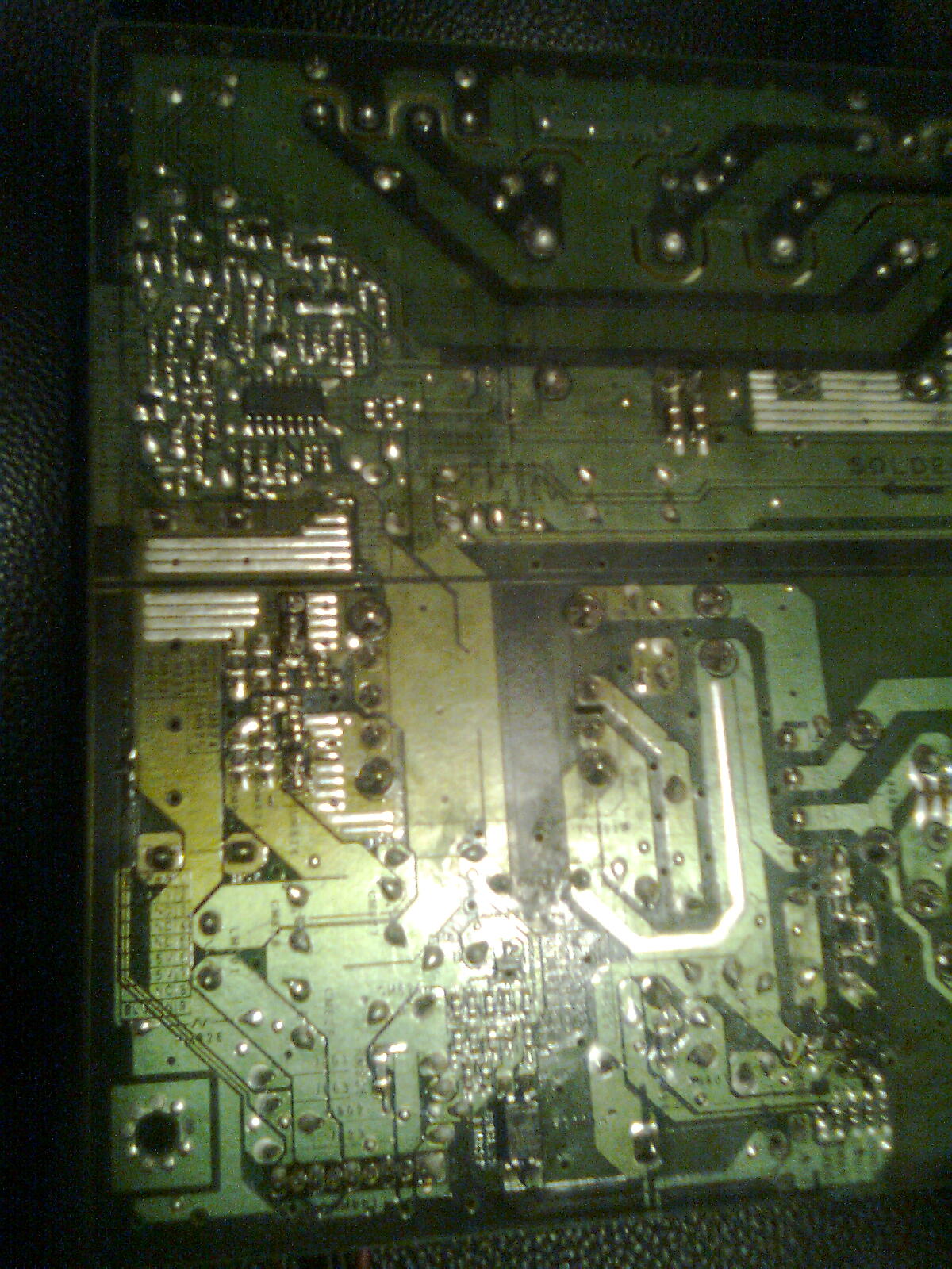

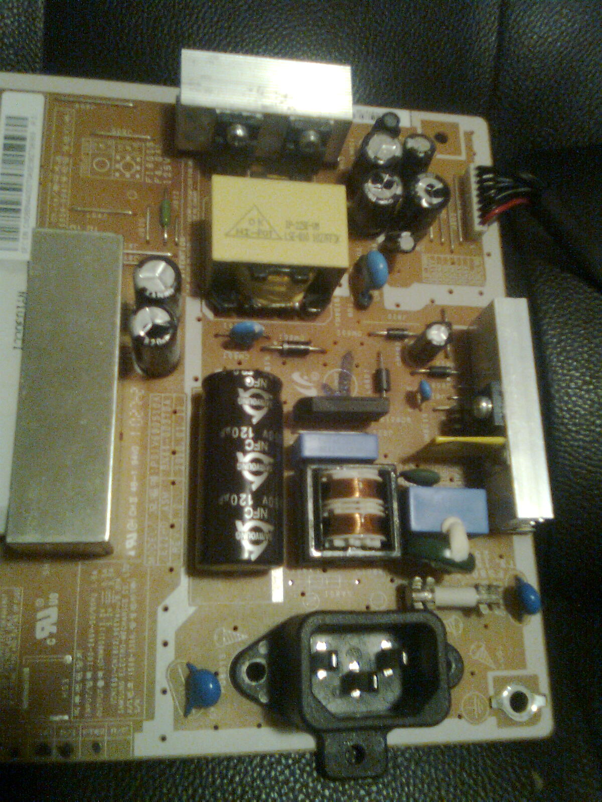

    I got this tv.
    The problem is that there's no backlight, with the flashlight i can see the menu is there.
    Tested diodes for short, but they all seem ok.
    Checked secondary windings, first is 1019, second is 1021 ohm, so that looks ok to.
    There are 5V, and 13V so that looks ok too.
    But, the voltage across primary cap legs is 315V when in stdby (which is ok), but after power button is pressed (red image appears for a second, and i can hear samsung sound) the voltage stays the same - 315V. It should be around 390-400V?
    I measured with my DMM primary cap and it says 95uF, and on cap itself says it should be 120uF. Can that be the cause?
    UI801 is a 16 pin IC but i can't read part number because it looks like someone erased markings altough the tv isn't opened before, mybe is because of heat, i really can't tell but it is a bit suspicious
    PS numer is BN44-00370A and i can't find service manual for that one
    UM801S is Q0765R
    Sry for low quality pics, but my camera decided not to work anymore, so i had to take pictures with potato, i can probably have better res pictures tomorrow

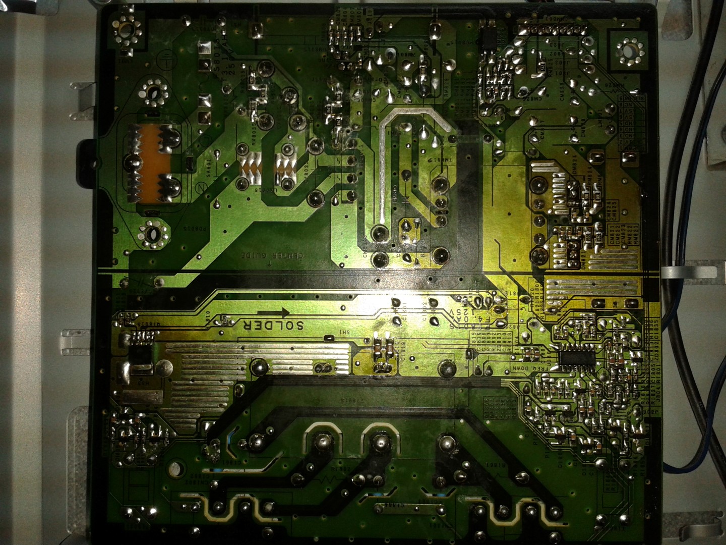

    Hi - Pic 2 to the left of the yellow transformer there is a green fuse - have you tested it?
    Voltage at both sides?
    • Hombre
      • Jul 2013
      • 231
      • Croatia
      Re: Samsung LE22C450
      Unbeliveable, i was sure i tested it, and that it showed continuity, and just wanted to check before replying positively to you, would you now, it is open. Can't believe it.
      What a noob...
      I'll replace it tomorrow and post results, hope it is just that, thx! Altough it blowed for some reason.

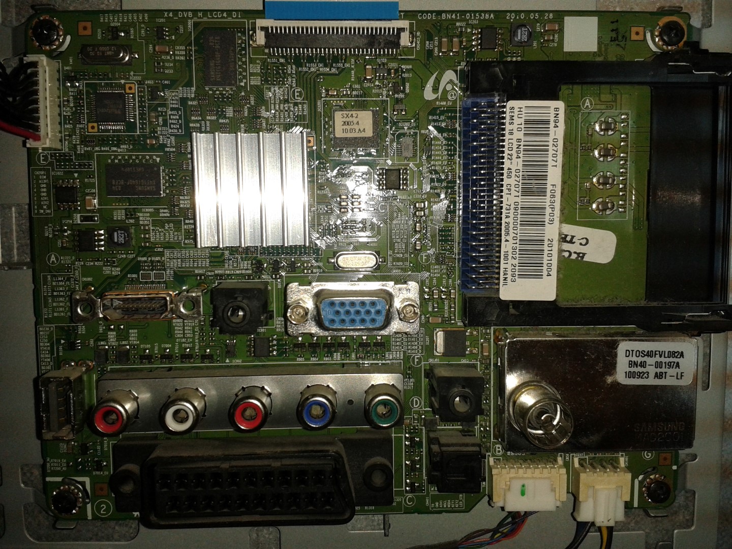

        So, in stdby i have 5V and 13V on CNM801, after power button is pressed i have 2V on E_PWM pin so motherboard is sending signal, but still the voltage on primary cap is 315-320V
        BLU_ON 0V in stdby, 5V with power button is pressed.

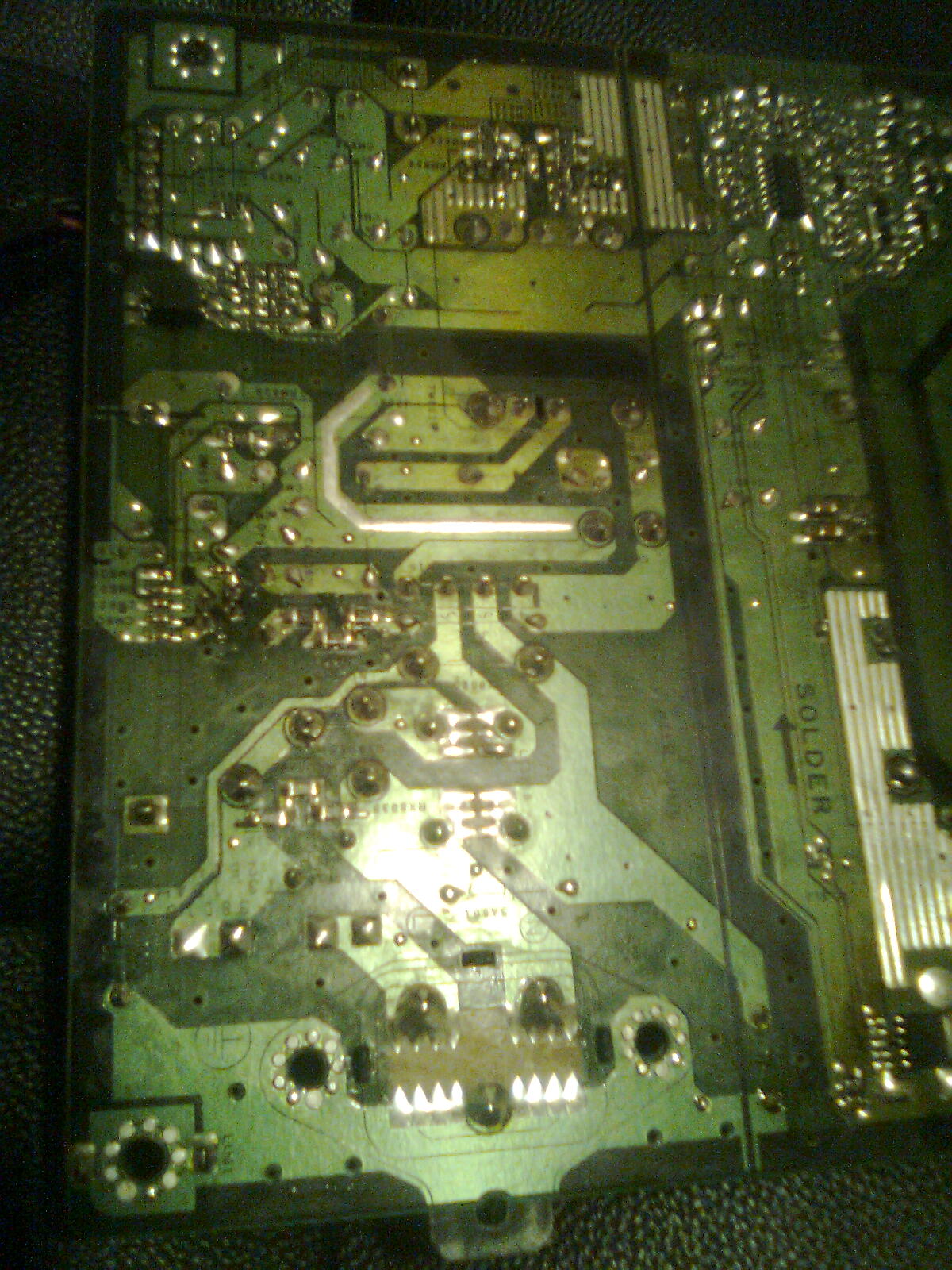

                  OK, focused on the bottom of the board as you suggested.
                  I think i may have found something but need confirmation from someone smarter and more experienced than me
                  That 16 pin IC UI801 is bit suspicious to me, because i am measuring around 85-90 ohms between pin 3 and pin 6,7 which are GND. Marking on IC is damn hard to decode because it looks like it is sanded... After an hour or so of losing my eyes with magnifier and flashlight i am 70% sure that it is SEM2105, but can't find datasheet for that one
                  So i found somwhere info that is interchangeable with SEM2005. On sem2005 pin 3 is open lamp protection (pins 6 and 7 do match with my circuit as they are gnd). Should i try to change it, what do you think?
                  IC is unsoldered, it is out of cct.

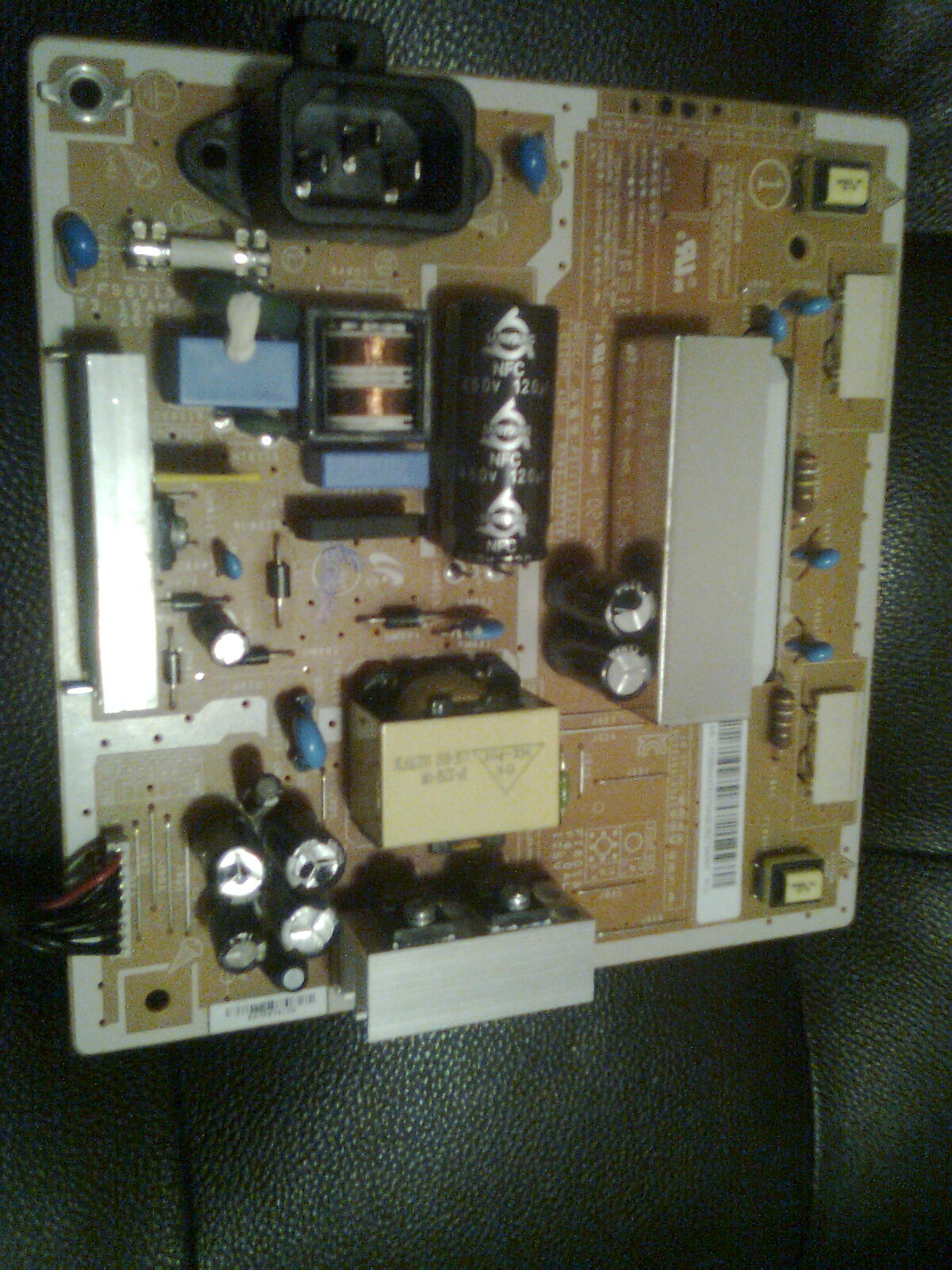

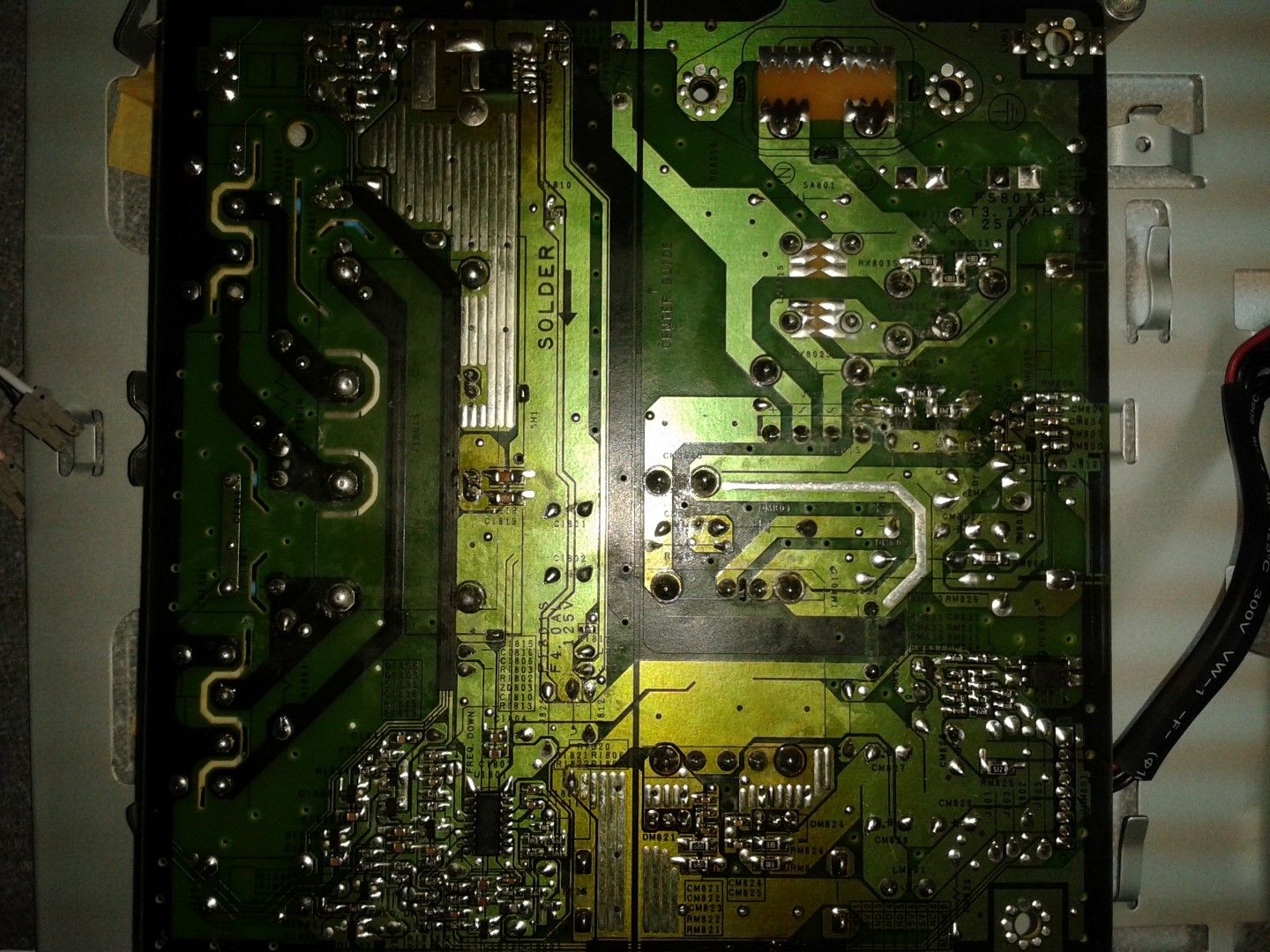

                                  I bought used PSU and seller says that is OK. But, when i press power button backlight powers up for a second or two, it's reddish not white btw, and shuts down.
                                  Tried to drive lamps from this tv with a samsung 19" monitor PSU and they work OK. And what's interesting i also connected 19" lamps to this PSU from TV and that works OK to. But it won't work with lamps that is should
                                  Any thoughts what's the problem, what to check?
                                  thanks

                                    Reddish/pink ccfl indicates failing ones. They are probably drawing much power, just a little bit more than this psu can handle.
                                    Failing ccfl-s is a bit unusual for Samsung but maybe this one has exceeded its life span.
