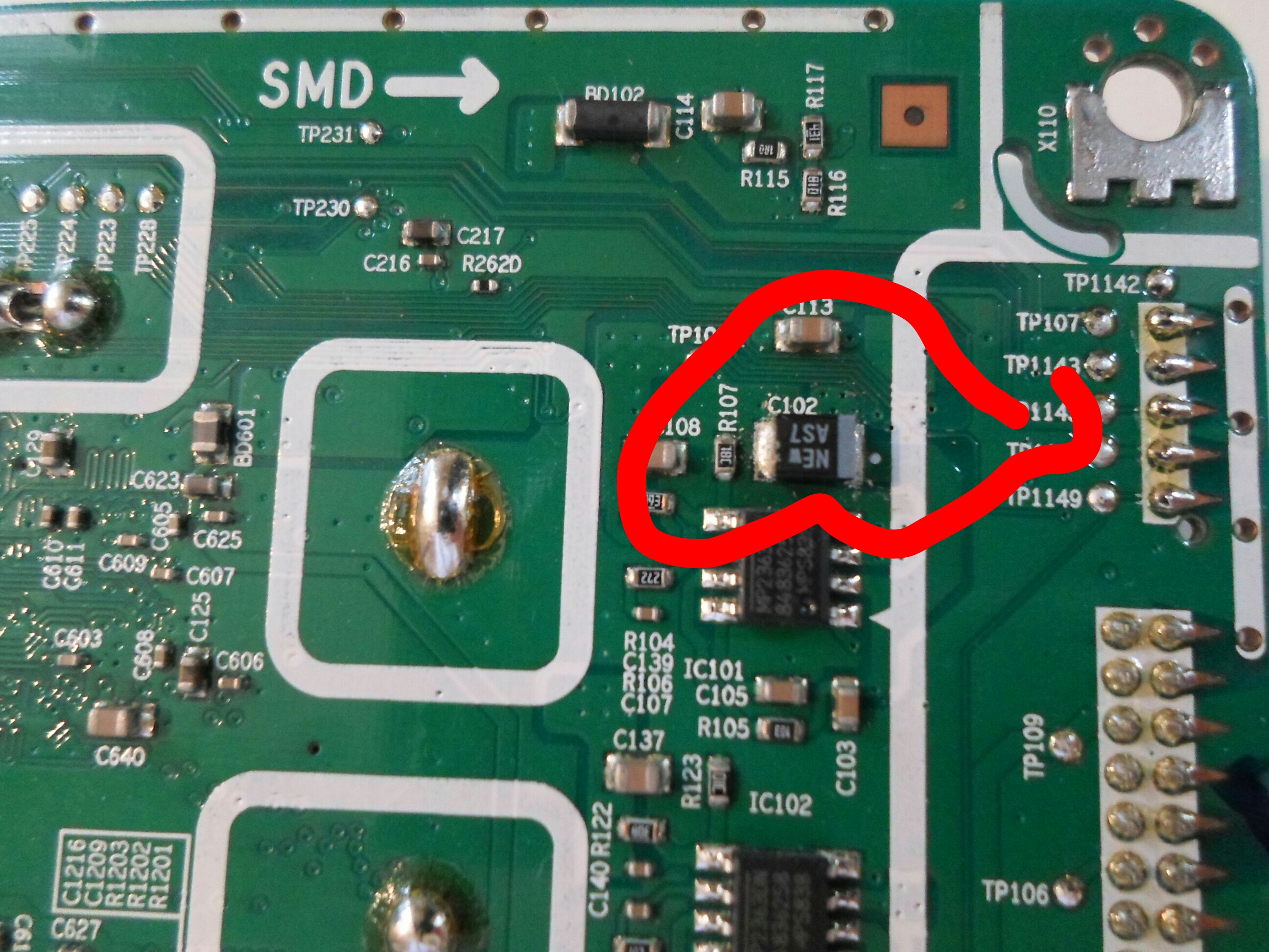

    I have a Samsung plasma PN50A550 that seems to have similar problems as posted else where, but not with the simple solutions. It cycles and flickers on and off for 15-20 minutes, making clicking sound every time it automatically turns on and off, makes a very loud screeching sound, until the picture finally clears up, then it works just fine. I took a look at the capacitors and none of them appear bulging, all the soldering looks fine on the back of the boards. Any suggestions? I've read about reflowing the main board but don't know how or if this is even safe.
    Re: Samsung Plasma PN50A550
    There's an issue with a capacitor on the main board under the RAM chips causing this problem, will try and find the thread. It's a surface mount tantalum, yellow or black in colour.

          Has this worked for anyone else? That tantalum capacitor C102 is tiny. I'm ordering this part today to try (its only $1.39). I have been resorting to a blow dryer to help warm the board up to turn on faster, its works but is annoying.

              Replacing the C102 tantalum capacitor worked like a charm. Easy to remove and resolder. TV turned right on! No more on/off, clicking, or having to warm up the board with a blow dryer. Turns on right away. Great fix for $1.50 replacement part. Thanks to everyone posting here.

                  The cap everybody is talking about is located on the main board(where the hdmi inputs are mounted on).

                        Here it is.
                        It is a 47uf tantalum capacitor. I think the voltage is 10v.

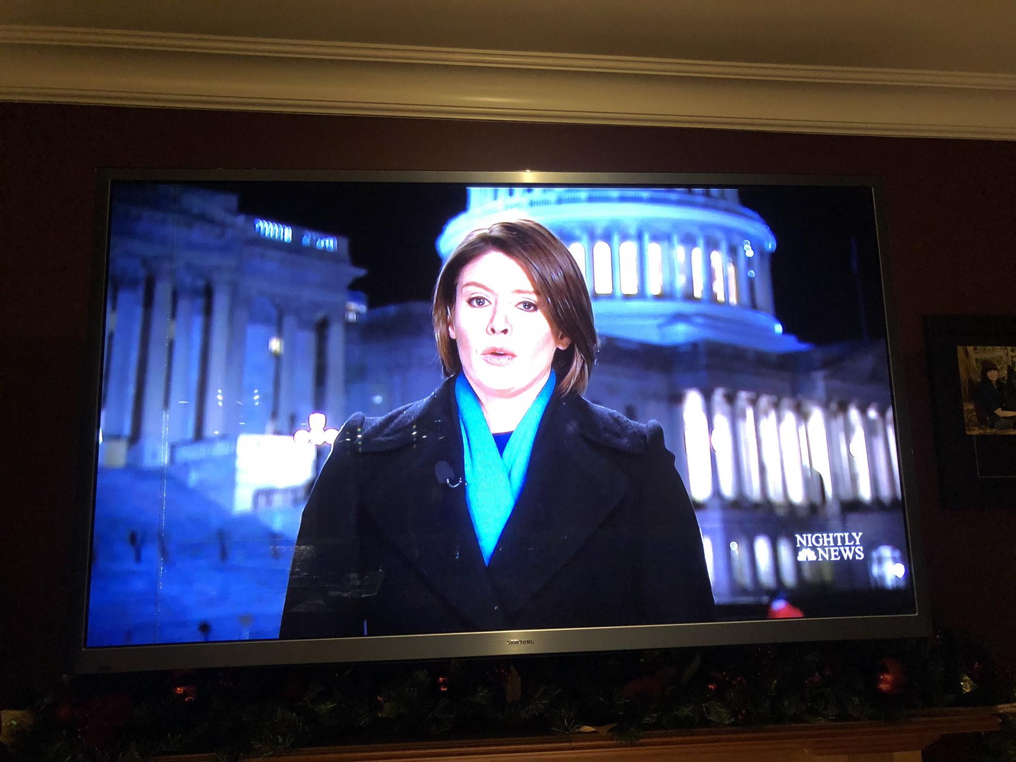

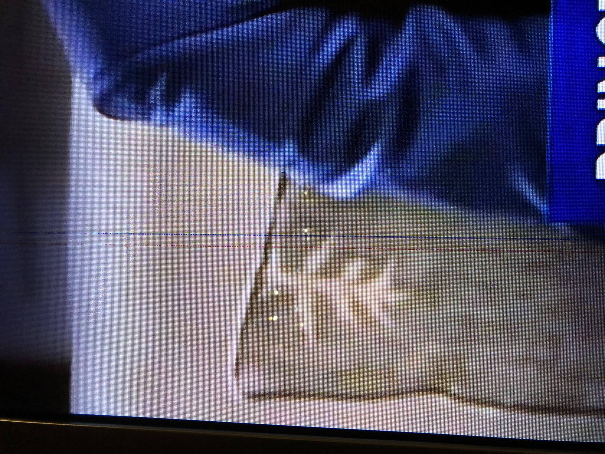

                            We fixed the cycling and clicking issue but now we have 2 thin lines (mainly red and blue in color) on the far left hand side that showed up 6 months after 2nd mother board replacement plus the new capacitor. This TV is only 2-3 years old and been problematic since it was 6 months old.
                            65” Samsung Plasma
                            Model: PN50A550

                              This looks like an LED TV to me. I'd check your model number but that's almost certainly a screen failure (not fixable).
                                It's a plasma TV, and it's a defective screen unfortunately.
                                  I've never seen a Samsung plasma with that bezel before. It confused me.
