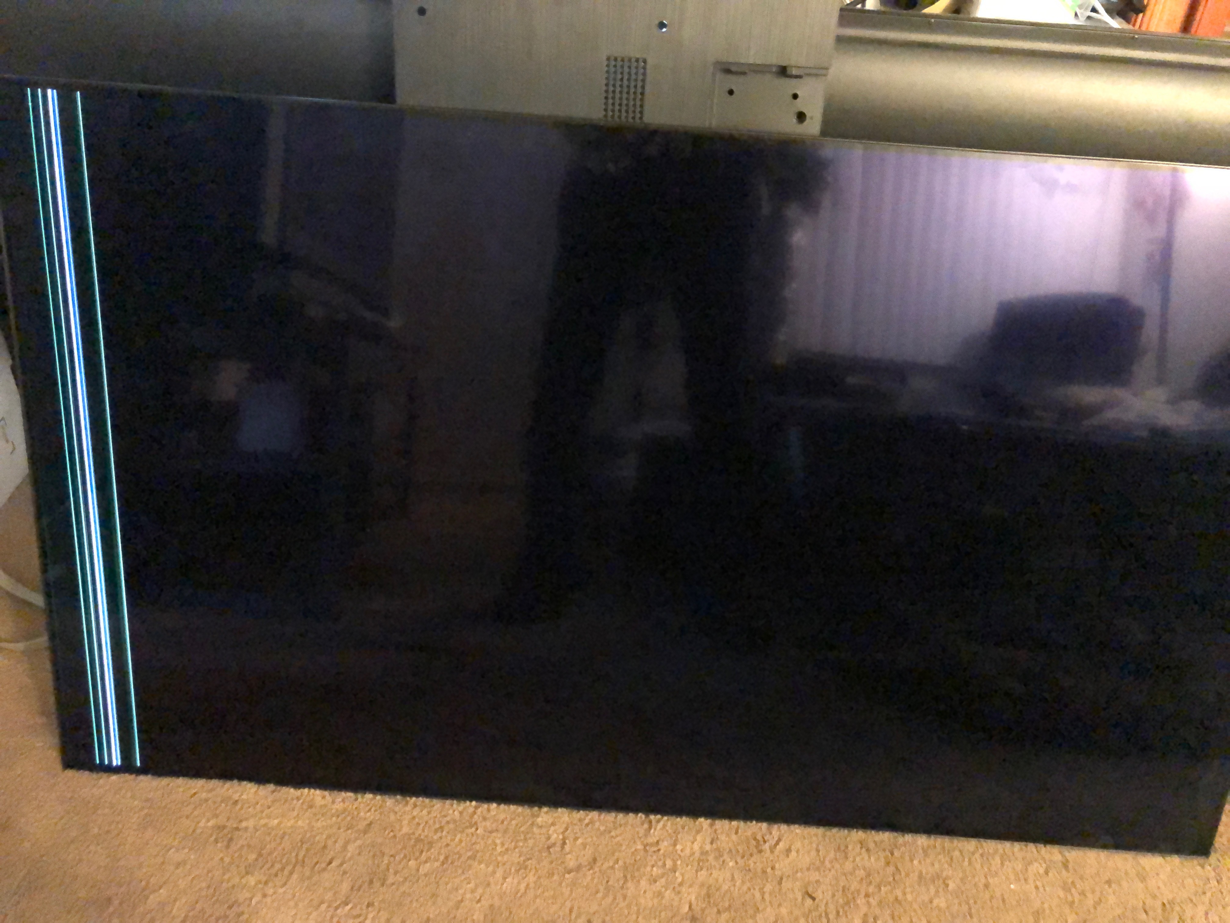

LG OLED55A1PUA
  • Diah
    replied
    Originally posted by lotas
    What is this then?
    this related to ThinQ AI.. funktion
    instead of NOR / Sspi they used this.. if you get it out from the circuit you will see howmany pins are used 12-16 only... how it come eMMC work with just view PINS
    Last edited by Diah; 01-23-2024, 03:34 PM.
    Leave a comment:
  • lotas
    replied
    Originally posted by Diah
    there are NO eMMC on T-CON at all....
    What is this then?
    Leave a comment:
  • Diah
    replied
    Originally posted by repair-it
    For a customer. Actually the lines are multi color.
    After this first time experience - I am a bit concerned about trying to repair these newer OLED type TVs. The more research I do into this newer technology, I am seeing a pattern of eMMc chip failures after about 2 years. I just got another 2 year old TV (SONY Bravia 75" OLED) in yesterday with the same issue - will not turn on and after some quick research online, it seems a common fault is eMMc failure. There is an eMMc chip on the T-CON board of the LG OLED TV that I've been trying to repair and now I suspect it could be an issue. I'm not sure if the MAIN board uses this chip as well, I never removed the heat sink to take a peek, but replacing the MAIN board with a new one did allow for the board to start because I got the start up tone that I did not hear before the board was replaced.
    Unfortunately, finding a replacement T-CON board for the LG has been difficult. I will probably be staying away from trying to do repairs on these type of TVs in the future unless reliable replacement parts become more readily available. There are too many variables with these OLED sets and seems too many opinions on how to fix. Some say the T-CON is matched to the panel and cannot be replaced, others have said the same for the MAIN board being matched to the set or the boards are matched to each other. I'm still suspect that this new eMMc technology is the issue. Unlike a BIOS chip, these are difficult to reprogram, remove & replace and find pre-programmed chips that are reliable.
    i don't know from where you got this wrong INFO about OLED T-CON ? there are NO eMMC on T-CON at all... and the it Function not much different from LCD TV. the one things different on OLED it got to VCC T.CON 12VCC & > 21 OLED VCC which it power the cells. no more or less,,, it had RAM and SPI / NOR and CPU. any way... if you are repairing TV... you should have under hand some other type of power boards... for example i have one from Vestel.. i jumped it as standalone so i can use it always fas external supply for 3.3V, 5V , 12V and 24V. so i can test any TV / screen.. MB... T-CON with it... thought this boards i will never put it as replace at any coast.. so you need to look round you may have one with this specification range.
    Leave a comment:
  • Davi.p
    replied
    you did not followed me well, i told that for testing the screen, probably needs to feed.first the 12v so the tcon dc dc and logical initializes, then the 24v, i don't know what it is used for it, never searched informations on oled, anyway i'm with you thinking that emmc on tcon could be a culprit, together with ram, cpu, i'm trying to make some experiments these days, i need a certain item, honestly i'm often in the doubt if let my theories and discovers public or keep them for myself, money are always few, but environmet is the most important.. maybe i'll share it with someone.. maybe the solution is much easyer than how it seems..
    My strong suspect is that here there is programmed obsolescence..
    PS: only Sony needs MB<>tcon pairing..
    Last edited by Davi.p; 01-23-2024, 01:21 PM.
    Leave a comment:
  • repair-it
    replied
    Originally posted by Davi.p
    i think you.must provide first the 12v, then the 24v, there's a power sequence to respect, otherwise the panel maybe could fry..
    Yes, I did not exceed 12v while using 1K resistor when trying to get main board to turn on. I removed the T-CON board and applied 6v 1A to it, there was no unusual amp increase displayed on power supply. I then looked at the board with IR cam and did not see any hot spots. I also did a continuity check of all caps and all were ok. My *guess* is it is a faulty eMMc chip or panel went bad.
    Last edited by repair-it; 01-23-2024, 11:26 AM.
    Leave a comment:
  • repair-it
    replied
    Originally posted by Diah
    never saw oled screen show this white lines .... this why i would never say OLED Module Failure unless it tested in standalone..... questions.. is this your home TV or you get it some where ells ?
    For a customer. Actually the lines are multi color.
    After this first time experience - I am a bit concerned about trying to repair these newer OLED type TVs. The more research I do into this newer technology, I am seeing a pattern of eMMc chip failures after about 2 years. I just got another 2 year old TV (SONY Bravia 75" OLED) in yesterday with the same issue - will not turn on and after some quick research online, it seems a common fault is eMMc failure. There is an eMMc chip on the T-CON board of the LG OLED TV that I've been trying to repair and now I suspect it could be an issue. I'm not sure if the MAIN board uses this chip as well, I never removed the heat sink to take a peek, but replacing the MAIN board with a new one did allow for the board to start because I got the start up tone that I did not hear before the board was replaced.
    Unfortunately, finding a replacement T-CON board for the LG has been difficult. I will probably be staying away from trying to do repairs on these type of TVs in the future unless reliable replacement parts become more readily available. There are too many variables with these OLED sets and seems too many opinions on how to fix. Some say the T-CON is matched to the panel and cannot be replaced, others have said the same for the MAIN board being matched to the set or the boards are matched to each other. I'm still suspect that this new eMMc technology is the issue. Unlike a BIOS chip, these are difficult to reprogram, remove & replace and find pre-programmed chips that are reliable.
    Last edited by repair-it; 01-23-2024, 11:11 AM.
    Leave a comment:
  • Diah
    replied
    never saw oled screen show this white lines .... this why i would never say OLED Module Failure unless it tested in standalone..... questions.. is this your home TV or you get it some where ells ?
    Leave a comment:
  • lotas
    replied
    LG's panels are also dying, like Samsung's, especially OLED.
    Leave a comment:
  • Davi.p
    replied
    i think you.must provide first the 12v, then the 24v, there's a power sequence to respect, otherwise the panel maybe could fry..
    Last edited by Davi.p; 01-21-2024, 03:42 PM.
    Leave a comment:
  • repair-it
    replied
    Had to step away for a few days to do some other repairs. Ordered replacement Main Board, it arrived & was installed. Powered TV up, got the start up tone(didn't get that in the past) and have optical light. Pulled both LVDS and have vertical lines on panel as shown in last pictured I had attached (message #47) All expected voltages were present. POWER ONLY button on Service remote does turn TV on, LED blinks 3 times then LED turns off, set remains on but Power ONLY button no longer operates TV, had to use POWER button to turn off (with lower LVDS cable disconnected). When ON all I can see image on panel is same as attached pic. Does this indicate a bad panel or is it a T-CON board issue?
    Last edited by repair-it; 01-21-2024, 02:25 PM.
    Leave a comment:
  • MASTER_TECH_101
    replied
    Such a waste of time. Unplug two LVDS cables TV turns on, Bad panel. End of story and troubleshooting.It does not matter is it Tcon or panel itself, you still have to replace whole thing. OLED LG sucks.
    Leave a comment:
  • Diah
    replied
    Originally posted by repair-it
    I plugged everything back in except lower LVDS cable and this is what I get when I powered up. Service remote has no effect on TV. Not sure if this is bad main board or T-CON. Power LED will not illuminate. Optical port not illuminated.
    keep it in this test condition...
    1- measure the sockets 1 & 2 i mentioned early on the PSU and tell each V
    2- as it is on... if you use yours Original RC can you put it in stand by state ? if yes... you need to check yours service remote with yours Mobile Camera ( Not I Phone one ) to see if you press any key you could see the IR LED blinking. after you clear this point and Service RC working 100& as the TV in STB... press on S.RC Power only and check if it is on and Optic port etc.... usb 5V there or not.and the 2 sockets we talked on.
    Leave a comment:
  • repair-it
    replied
Name:	IMG_2394.jpg
Views:	248
Size:	1.56 MB
ID:	3180022 I plugged everything back in except lower LVDS cable and this is what I get when I powered up. Service remote has no effect on TV. Not sure if this is bad main board or T-CON. Power LED will not illuminate. Optical port not illuminated.
    Leave a comment:
  • repair-it
    replied
    Will try Service remote. Should that be done after reconnecting all first? I tried (message #41) to no avail, nothing happened when I powered TV up.
    Leave a comment:
  • Diah
    replied
    with yours service RC try to press P Only .. take look on the screen
    Leave a comment:
  • repair-it
    replied
    Possibly early-covid-pandemic-related QC slump! It's in the period where there's possibly an above-normal panel failure rate. Early-covid-pandemic, is suspected of being the worst for bad panels! Same for other components, where I suspect being indirectly related to early-pandemic, due to factories of supply-chain being disrupted.
    REALLY??! Oh geez, that was one thought I had.. a bad panel. Well, I do know these did come with a 5 year warrantee on the panel. Hopefully It'' turn on when I give it another shot tomorrow.Thanks for that info.
    Leave a comment:
  • RJARRRPCGP
    replied
    Originally posted by repair-it
    When I press power button, I hear a click, voltage goes to 20v then drops to 17v. The 12v does the same (goes to 12v) and drops to 7v after attempt to power up. I believe there is a faulty component issue on the power supply board but have yet to start testing. Pics attached.
    Possibly early-covid-pandemic-related QC slump! It's in the period where there's possibly an above-normal panel failure rate. Early-covid-pandemic, is suspected of being the worst for bad panels! Same for other components, where I suspect being indirectly related to early-pandemic, due to factories of supply-chain being disrupted.
    Last edited by RJARRRPCGP; 01-15-2024, 06:04 PM.
    Leave a comment:
  • Diah
    replied
    100/ correct... if you are lucky you will have some things on yours screen.. capture it and show me here
    Leave a comment:
  • repair-it
    replied
    I appreciate your help & understand English is a secondary language for you so I just want to be sure I completely understand what you are saying.
    I should only have 2 wires connected between MAIN board & POWER board. One of those goes from the 12VM out on the Power Board and connects to the appropriate connection on the Main Board, The other connects from the 3 and goes to one side of a 1K resistor and the other side of resistor goes to the 3.3v connection on the Main board. Disconnect both LVDS cables. Everything else remains connected. Then Power up. Is that correct? I now have the Service remote ... if that helps.
    Last edited by repair-it; 01-15-2024, 04:36 PM.
    Leave a comment:
  • Diah
    replied
    Originally posted by repair-it
    This is my first time working on an OLED TV so it is a learning experience for me. I connected USB mouse, monitored T-Con voltage when connecting power, then powered up. It remained @ 12v until it went into sleep mode. Mouse had no effect after in sleep mode. LVDS lower cable disconnected entire time, no optical LED the entire time. I ordered a Service Remote, but unfamiliar with how it 'could' help. The TV is only 2 years old.
    MAN. you did the usb or mouse while you have the second LVDS connected i each the MICOM and the set will turn off... if the set will turn on with out SOS the serice remote Power only will pass it... however i will write now in detail for you to test the PSU and T-CON and panel all together.
    test one... ecery things connected.. only the OLED socket No 2 from power board disconnected.... tv remain ion or not.... if remain on... panel defect we can try to handle it later...... if rge same issue turn off.... much likely T-CON fault we do the next test..
    disconnect the socket from Power boards and Main boards... disconnect the 2 LVDS between T-CON and Main boards
    noe this are important.... i wrote before... take only one wire from 12VM 12V which read 7.7 at STBY.. connect it to it place at Main boards socket...... on main boards search after 3.3V rail conect wire to the point you found... at end of ithe wire connect 1K Ogm R... and the end of the R cjumber it to the three points i market before... power_on Tcon_on and DRV on-
    plug the tv in wall you should have T-con and OLRD B on them and screen will show color complete or disrupted
    Last edited by Diah; 01-15-2024, 06:27 AM.
    Leave a comment:
    ASUS VivoBook Vivobook Pro 15 OLED D3500QC-L1351W Notebook Pro 15 OLED Specification for Upgrade or Repair
    This specification for the ASUS VivoBook Vivobook Pro 15 OLED D3500QC-L1351W Notebook can be useful for upgrading or repairing a laptop that is not working. As a community we are working through our specifications to add valuable data like the Vivobook Pro 15 OLED D3500QC-L1351W boardview and Vivobook Pro 15 OLED D3500QC-L1351W schematic. Our users have donated over 1 million documents which are being added to the site. This page will be updated soon with additional information. Alternatively you can request additional help from our users directly on the relevant badcaps forum. Please note that...
    09-07-2024, 04:30 AM
    Gigabyte AERO 14 OLED BMF-72ESBB4SH Notebook Specification for Upgrade or Repair
    This specification for the Gigabyte AERO 14 OLED BMF-72ESBB4SH Notebook can be useful for upgrading or repairing a laptop that is not working. As a community we are working through our specifications to add valuable data like the 14 OLED BMF-72ESBB4SH boardview and 14 OLED BMF-72ESBB4SH schematic. Our users have donated over 1 million documents which are being added to the site. This page will be updated soon with additional information. Alternatively you can request additional help from our users directly on the relevant badcaps forum. Please note that we offer no warranties that any specification,...
    09-07-2024, 07:12 AM
    Gigabyte AERO 16 OLED BSF-A3LA964SP Notebook Specification for Upgrade or Repair
    This specification for the Gigabyte AERO 16 OLED BSF-A3LA964SP Notebook can be useful for upgrading or repairing a laptop that is not working. As a community we are working through our specifications to add valuable data like the 16 OLED BSF-A3LA964SP boardview and 16 OLED BSF-A3LA964SP schematic. Our users have donated over 1 million documents which are being added to the site. This page will be updated soon with additional information. Alternatively you can request additional help from our users directly on the relevant badcaps forum. Please note that we offer no warranties that any specification,...
    09-07-2024, 07:12 AM
    Gigabyte AERO 14 OLED 9MF-E2USBB4SH Notebook Specification for Upgrade or Repair
    This specification for the Gigabyte AERO 14 OLED 9MF-E2USBB4SH Notebook can be useful for upgrading or repairing a laptop that is not working. As a community we are working through our specifications to add valuable data like the 14 OLED 9MF-E2USBB4SH boardview and 14 OLED 9MF-E2USBB4SH schematic. Our users have donated over 1 million documents which are being added to the site. This page will be updated soon with additional information. Alternatively you can request additional help from our users directly on the relevant badcaps forum. Please note that we offer no warranties that any specification,...
    09-07-2024, 06:40 AM
    Gigabyte AERO 14 OLED BMF-72EEBB4SO Notebook Specification for Upgrade or Repair
    This specification for the Gigabyte AERO 14 OLED BMF-72EEBB4SO Notebook can be useful for upgrading or repairing a laptop that is not working. As a community we are working through our specifications to add valuable data like the 14 OLED BMF-72EEBB4SO boardview and 14 OLED BMF-72EEBB4SO schematic. Our users have donated over 1 million documents which are being added to the site. This page will be updated soon with additional information. Alternatively you can request additional help from our users directly on the relevant badcaps forum. Please note that we offer no warranties that any specification,...
    09-07-2024, 06:38 AM
