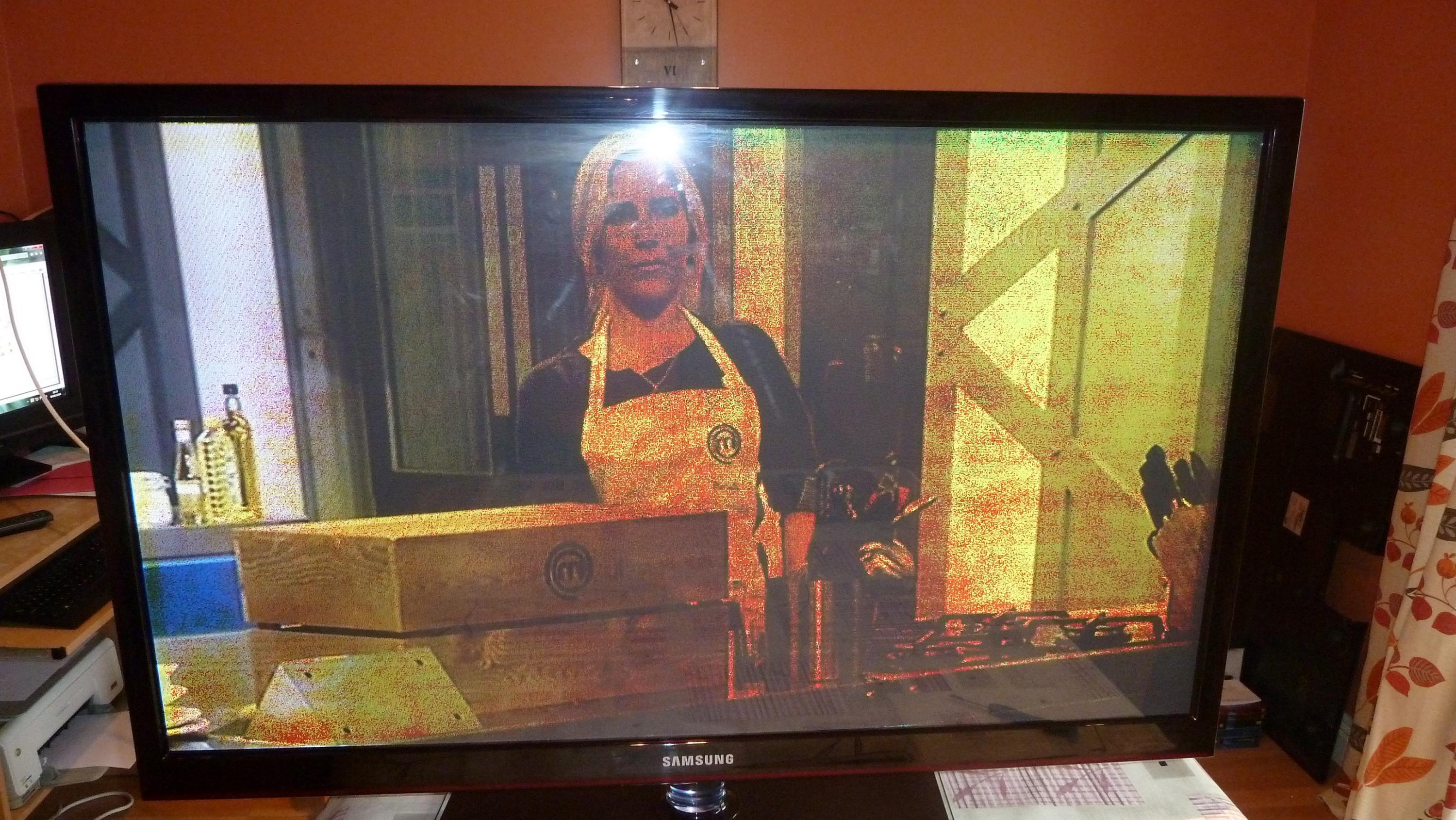

    I have a Samsung ps43d490 3d tv and it started to show a pink/red pixel snow all over the screen.(please see pictures)
    I went to Samsung website and installed the latest firmware for tv by usb but this had no effect.
    I removed the rear cover from tv and read the vs/vscan settings for tv
    should be va-58 vsc-185 vs-207
    now to get rid of the snow I had to alter these settings to-
    va-58 vsc-206.4 vs-209 and im getting a good picture.

    I would avoid setting Vsc so high; can you check what Ve measures? It's on X-main board.

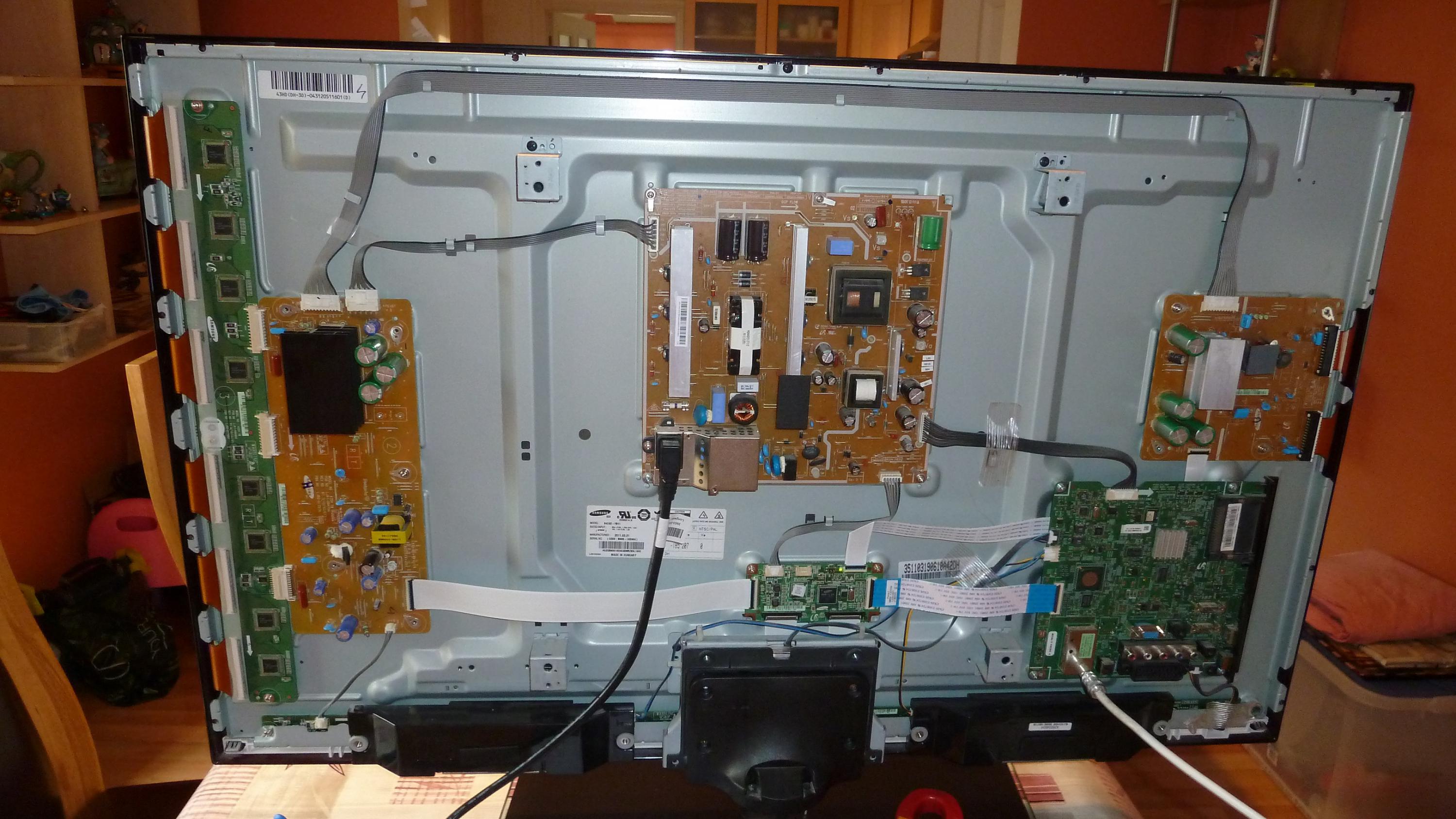

      I sent pic of board I think is x-main (im a computer tech not tv tech so I might be a bit slow on this)

        sorry tome I see ve on pin no.4 of grey cables going out the board 106.6 v
        Does this help

          Ve = 0 means it's a free voltage (unspecified) not 0V. Confusing!
          I would try upping Vs to 211V and dropping -Vsc to the lowest point of misfire. It is a known issue with Samsung panels (red diffusion.) Increasing -Vsc may damage Y-buffer board.
              Ve is OK, that is within range (80~120V.)

                I have raised vs to 211 but I cant drop vsc the pink snow gets worse on a green screen.

                  I do not think changing the X/Y-main will help. I think you will just have to set -Vsc to as low as possible and hope it does not fail, really strange though. Did you apply the Samsung "Red Diffusion" update? What software version is the TV running? I can't help but think the problem will get worse over time and you will need to increase -Vsc more until the buffer board is possibly damaged.

                        Just a quick update. I ordered new x-main and y-main boards from PARTS4U both boards sent were faulty :-( .Cant get hold of them as they do not reply to my emails or phone messages. So I order some more boards from eBay seller sivill123 He was very helpful and sent boards to me the next day. I have fitted the boards and set the vscan and vs setting to the settings labelled on back of tv.
                        The tv is now working fine.
                        I am well happy :-)
                        Big shout out to and very big thumbs up to sivill123 and a very big thumbs down to PARTS4u.me
