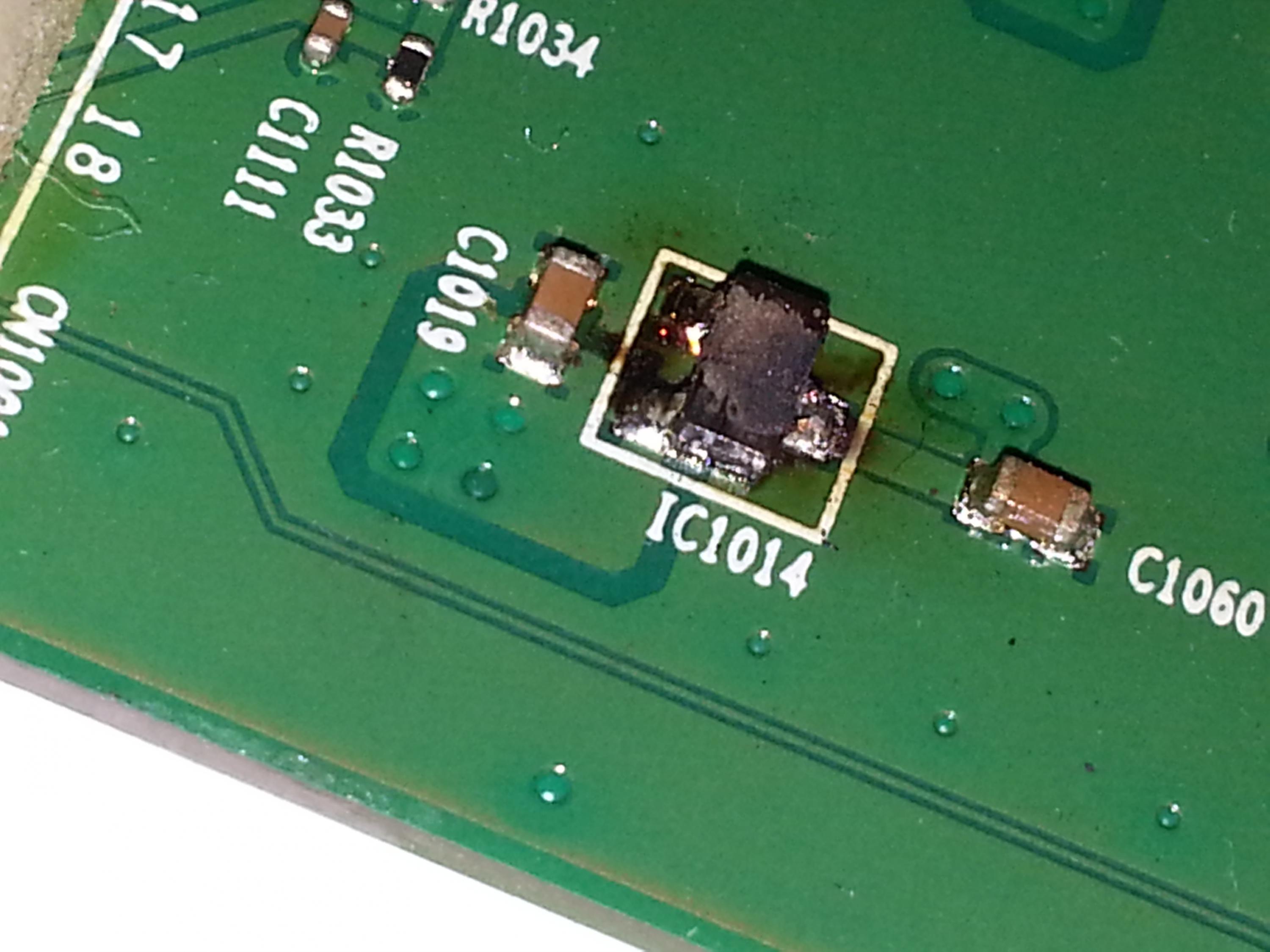

    My Samsung LE46C750 LCD TV has suddenly stopped working, then No PWR, No STBY, No Sound. Removed back cover, had a look at PCBs and found burnt SMT FET-SOT23 (IC1014) which is right on the top side of the power connector on the main board (BN41-01423B/BN94-03388F).
    Disconnected main board from power board, turned mains ON then backlight ON.
    Please could you let me know that particular FET part number/marking on it?
    I would be very grateful to you if you can please share any generic problems with this board causing power failure, blowing that FET and any schematics.

    A really good photo of it would be handy. Are you sure it's a FET? Normally transistor would have a Q designator, IC sounds like it could be something else?

      Thanks for your reply. I agree with you about designators and I am sure it's a FET, please see attached images. Do you reckon two ceramic caps next to that FET may be gone as well?

        Looks like a voltage regulator to me.

          TV is just over 2 years old. Please can you recommend me a part number that I can fit as a replacement? Any idea what could have caused it?

                    Sorry for the trouble, I couldn't find IC1014 on the BOM, please can you help me by looking at this attachment?
                      Re: Samsung LE46C750 No PWR, No STBY (Burnt FET on AV Board) Please Help!
                      I can't find it either, that parts list does not look complete to me.

                                Sometimes there are other faults on a board leading to that fault. Other times the fault is independent. Not seen one like this yet.
